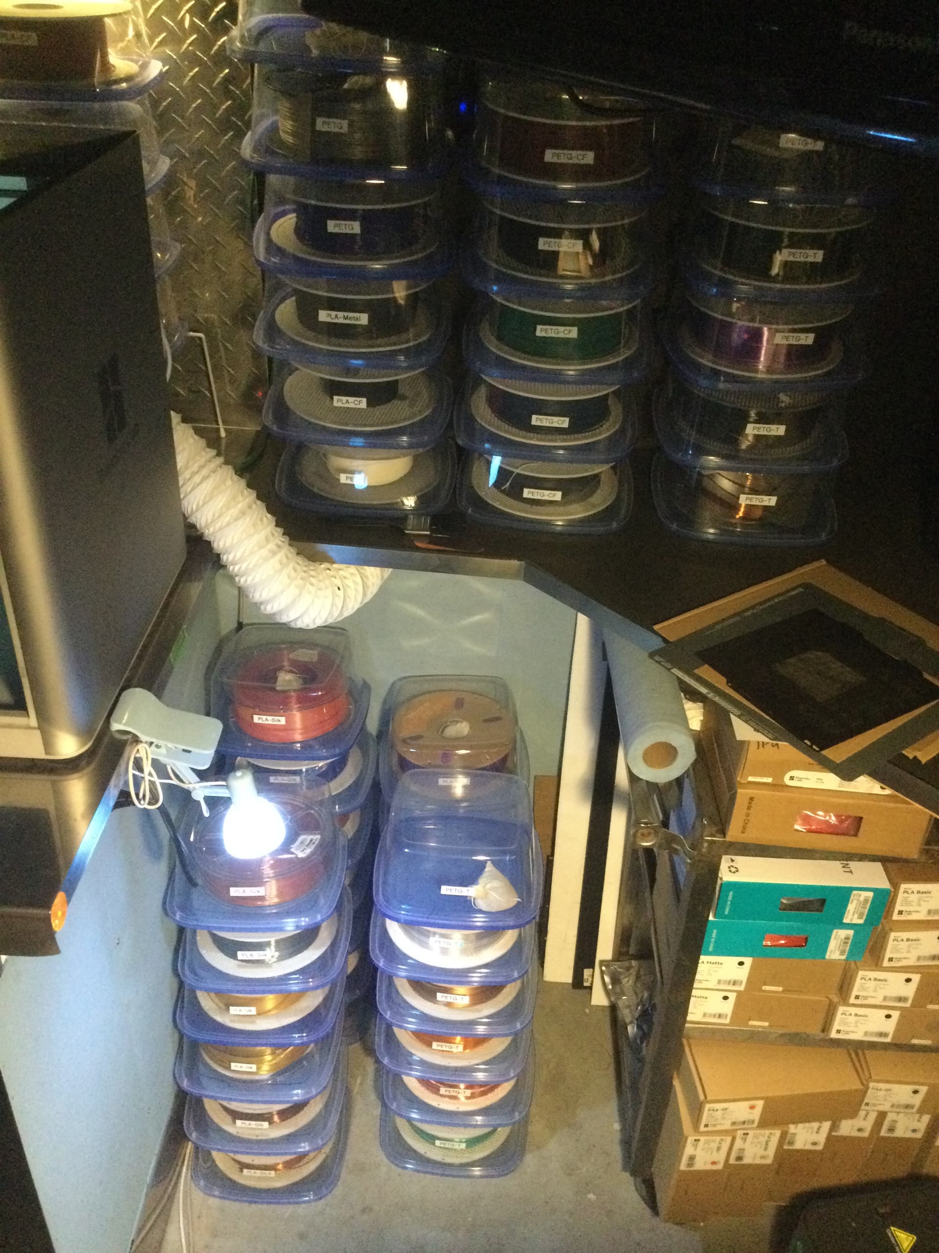

I wound up with 6 of those plastic totes. I tossed in 2 good sized bags of desiccant (I purchased some sealable bags and filled them) and then tossed in a hydrometer. After a few days I checked it and my hydrometer is reading 10% while my room is 48%.
I may print up something to hold the bags and the hydrometer.
Thank you so much for the help. These totes rock, and sre super easy to use. I’m done with vacuum bags that leak.
The amount of silica gel to use is somewhat subjective. What it does is scavenge water that permeates or leaks in before it finds the filament. All putting lots of silica gel in a container does is give you capacity. The more gel, the more water it can hold at a given humidity level. Only use a little gel and humidity in the containers will rise faster than if there was more gel in there.
So less gel and you’ll be regenerating more frequently. More gel and it will take longer for humidity to rise but you’ll have bigger batches of silica gel to regenerate.

$2.50 Canuckian at the Dollar store, 3L Sterlite food containers and cheap muslin drawstring bags from Amazon each half filled with color indicating desiccant. Hygrometers in several to monitor show they hold humidity to less than 20% when stacked.
I’m up to ~ 80. Not perfect but cheap and effective.

Think I have about 40 of those boxes. I love them. They are the best money I’ve ever spent. They keep me organized. And I was lucky, live in the Midwest, so I got them at Menard’s for around $9 each. One bag of 100g desiccant keeps the filament dry. Olias is a genius for finding these.
