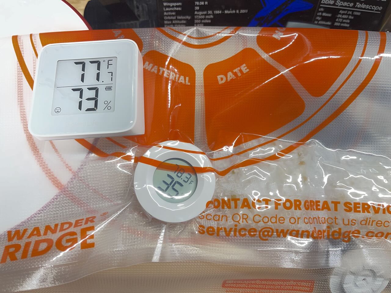

For giggles last week, I stuck a partially-recharged silica gel packet into one of the vacuum bags I use for filament, along with a cheap humidity sensor, and pumped out most of the air.
The ambient humidity has been ~70% lately. Within a few hours, the sensor in the bag was reading 25%. It stayed there for a few days. Then it started climbing back up; one morning I noticed it at 30, then 33 the next day, and 35% by last night.
I’m leaving it there to see if and how quickly it stabilizes at some value. Ultimately it should hit 70% (ambient) but I suspect it’s an asymptotic timeframe. Doubt I’ll have the patience to wait that long.
Summary:
  • 1 week at 70% ambient humidity
  • 25% humidity at start
  • 35% humidity at end
  • and the vacuum bag has not leaked.
Conclusion: science was correct and water migrates through plastic just fine. Darn you, science.
PS – follow up on the Wander Ridge bags – after the first two that didn’t hold a seal I haven’t had any trouble with the others. So the failure rate is, at least for the two boxes I bought, much better than the blue ring style.
