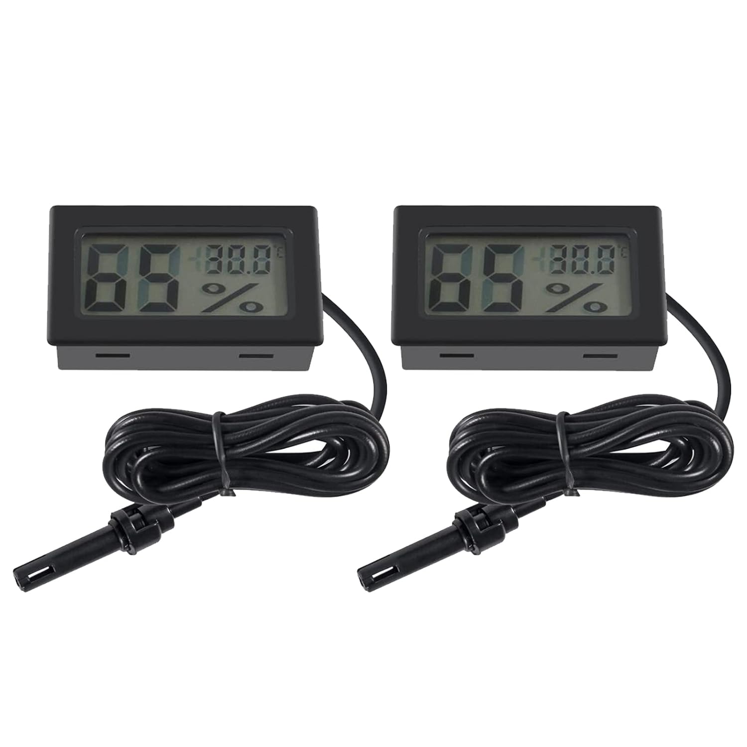

Now the bad news. All and I mean for ALL of these, you have to resign yourself to the fact that they are disposable. I get maybe 6mo to a year of life out of these garbage devices and accuracy is just OK, not perfect. These are all so shoddily made that I find quite often, they battery outlasts the LCD.
Also, they have a bottom end sensitivity of 10% RH.
I prefer the external probe version. This is primarily because these are all made from very low end LCD’s with a max operating temp of 50c which means if they are inside the box, and the box gets too hot, the LCD will go black. Often it will recover after cool-down but the external probe version eliminates this problem.
If you buy them in bulk, I have seen them as low as $0.50ea on places like Ali Express.
Here’s the largest example I’ve seen on Amazon. What’s maddening is that often the Chinese sellers don’t tell you if it’s C or F or they just ship you what they have even if the description says otherwise. Which is why I prefer Amazon as I tend to return about 10% of the ones I buy. I have probably purchased over 50 of these in the last four years. I have purchased higher quality LED based thermometers for my System Builds but now you’re talking anywhere from $15-$20 but those are built to last and when you’re protecting a $3K system build, it’s justifiable. But I mention it solely because I have tried to find that goldilocks zone between price and quality and unfortunately there is a chasm, you can’t get both.
