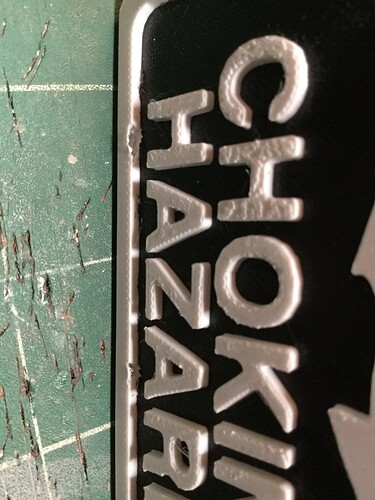

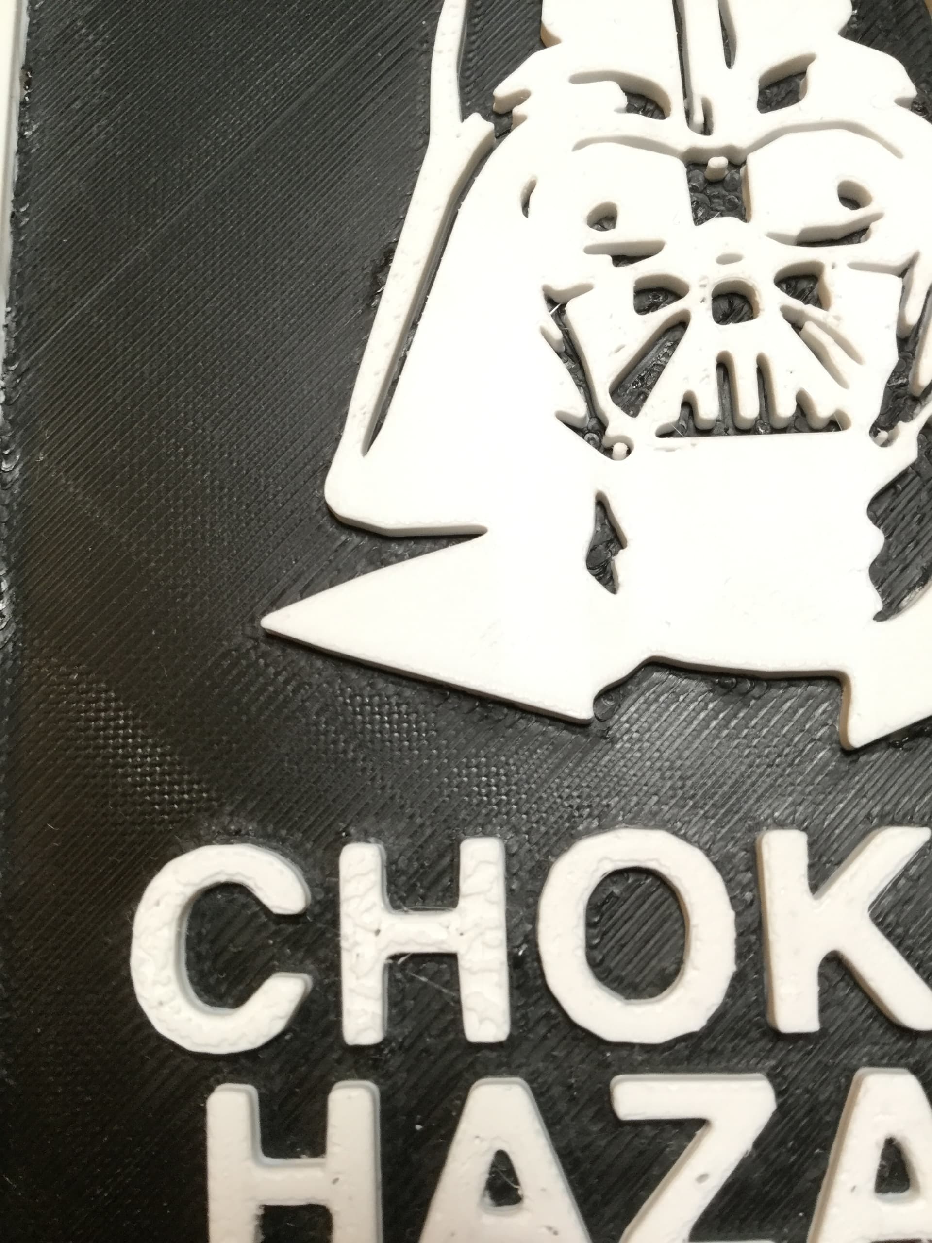

I printed this little magnet/sign and I ended up having voids on the border and a cake icing texture on some of the letters. Other than on those letters, the white is completely smooth. It was printed at .16mm, ironing was 60mm/s, flow was 30%, ironing spacing .15mm, and ironing inset was .11mm. Bed was cleaned before printing, filament dry, etc. :slight_smile:

How many top (and bottom) layer surfaces did you set?
Is the height of your model divisible by 0.16mm without a remainder?

I’m using a .4mm nozzle. Top layer is 4, bottom 3. The calculator gave me a whole number, so I assume it is divisible without a remainder.
