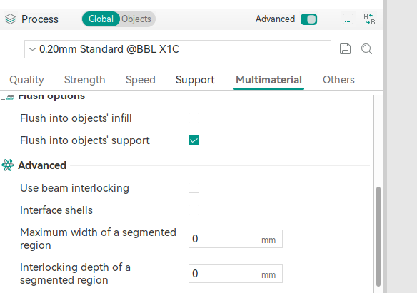

Hello,
Bildschirmfoto zu 2025-03-16 07-02-52
In the Orca-Slicer, these settings are contained in the menu ‘Multimaterial’ → ‘Advanced settings’. The menu item is ‘Use beam interlocking’.
(Menu items are only visible when the ‘Developer mode’ option is activated. The ‘Advanced’ slider at the top of the screen).
Perhaps this is also the case in BambuStudio.
