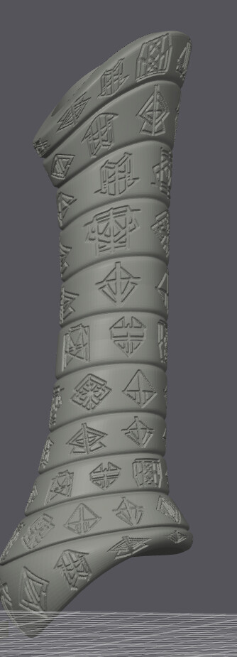

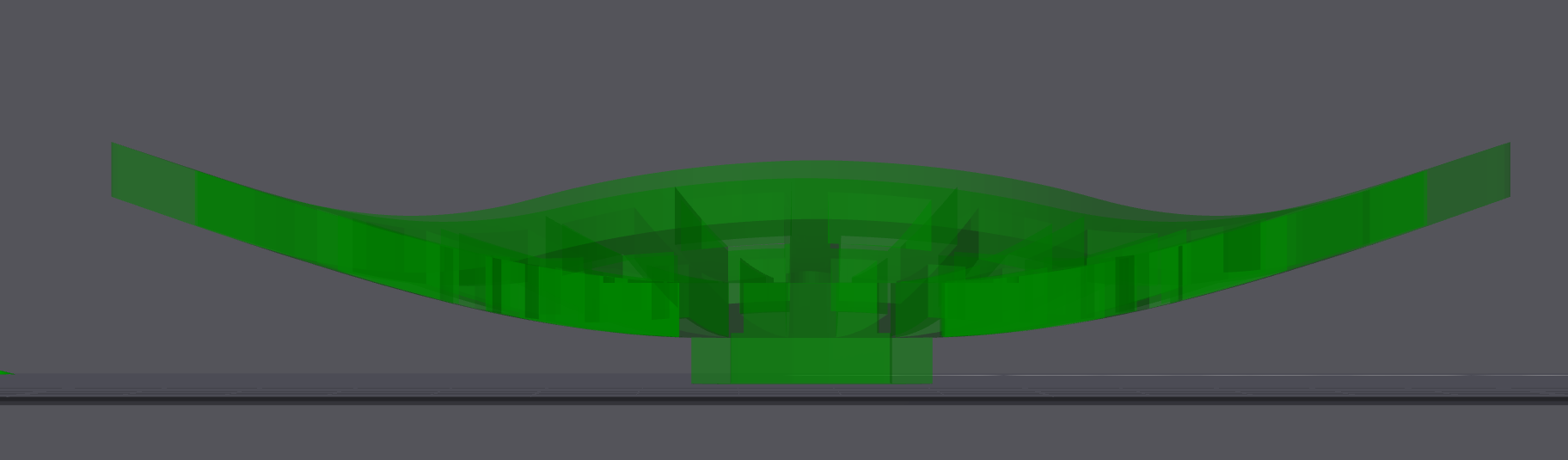

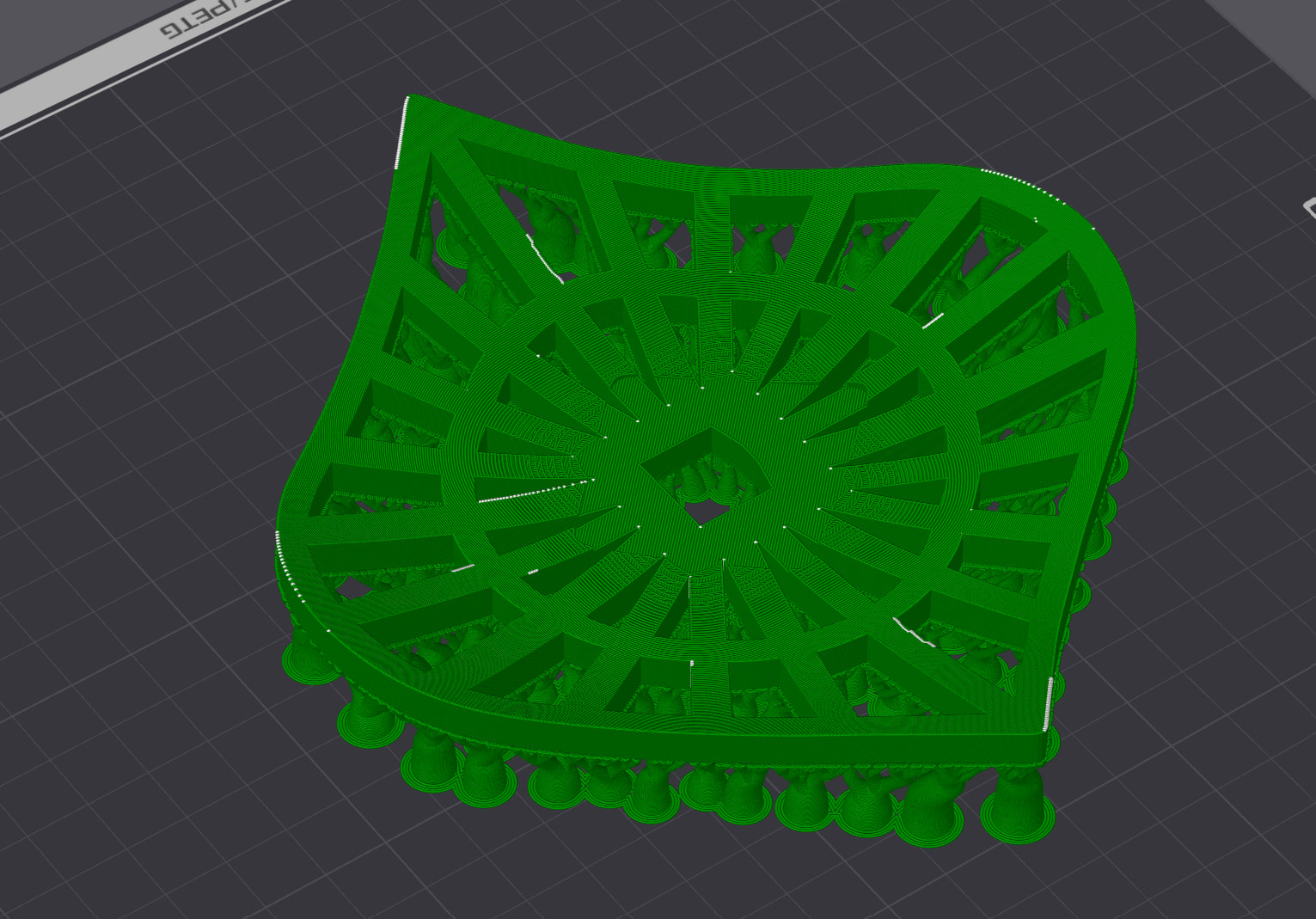

What support to print these model parts?
I’m new-ish to 3D printing and have a P2S which I struggl when it comes to supports. I have two big pieces that aren’t easy to layout on the plate with their organic shapes and outer details. I’ve tried printing the shorter guard piece a few times but get horrible underside scarring from the supports. I know my overhang test was great up until 55 or 60.
I’ve recently tried using PETG as support interfacing - worked great fro small flat pieces but not these curvy, organic shapes. I got weird under extrusions when using it even after switching back to just PLA. I’m at the point of just going back to PLA but nervous I’ll spend a lot of print time on these big pieces and end up with bad quality.
Any advice on orientating these objects and support settings to help print these with protecting the deatils and minimal scarring on the outside?

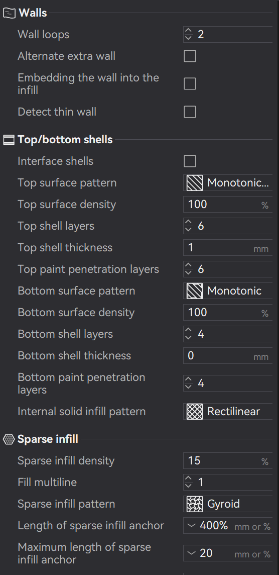

(Settings listed below images)

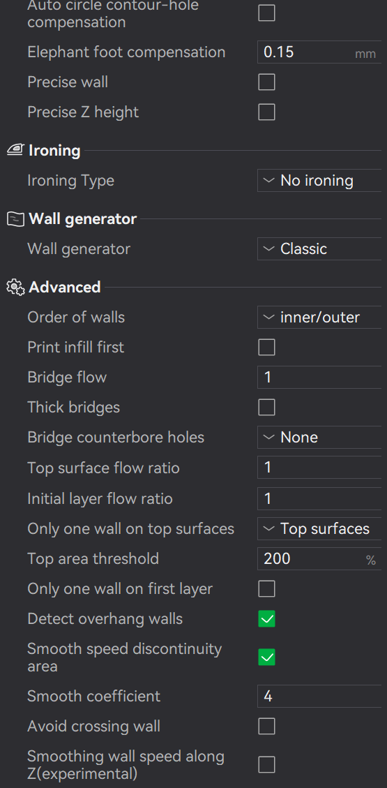

Bambu Labs Studios settings:

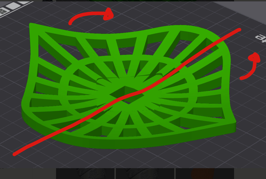

I see 3 approaches:
  1. Cut in half, add some peg connectors, and stand it up IMO
  2. Or, if you can bear the asymmetry , just tip it up 90 degrees on one of the “flatter” sides, give the bottom plenty of support for the areas that swoop away form the plate, and let it print very tall. Do it in “silent mode” to reduce acceleration, or do so in your slicer.
  3. Use PETG as your interface with zero gap, and print as youve got it laid out. “Normal Type” on that big flat expanse, not tree. On a P2S you will need to make sure that a) you set slicer material change purge to MAX (900?) both IN and OUT of the materials. b) experiment with a bed temperature for the two filaments you have in hand to find a single temp that works for both but wont melt your pla. Cool plates can help make this math easier

Not wrong, but look at it from below. The surface youre supporting is mostly flat and wide, just undulating up a little bit.
Keep the nozzle temps for whatever works, just think about the bed/plate. I dont have good luck with PETG being the interface only, [slips off the stalks, could be a ‘me’ problem] I tend to need it to be the whole support structure, so its gotta attach to the plate. Too cold and it wont :slight_smile: Too warm and your PLA melts. A lil glue helps make them both happy.

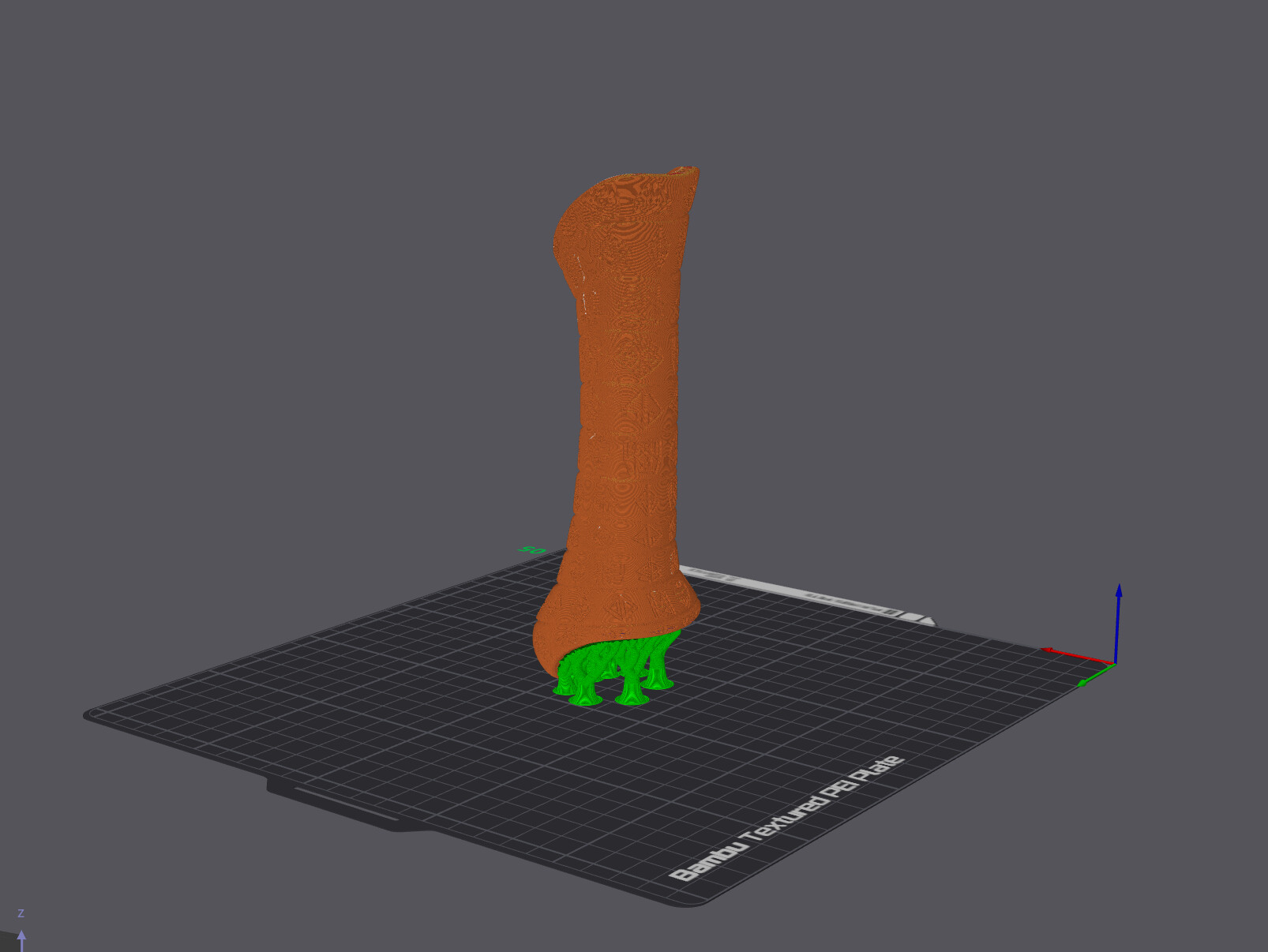

I’ve typically used trees but with this one it tends to cover the entire underside when I generate them. Maybe with the gradual angle I can remove some of these manually. Or the top of the branches might not be thin enough so it makes removal and scarring a pain.:woman_shrugging:

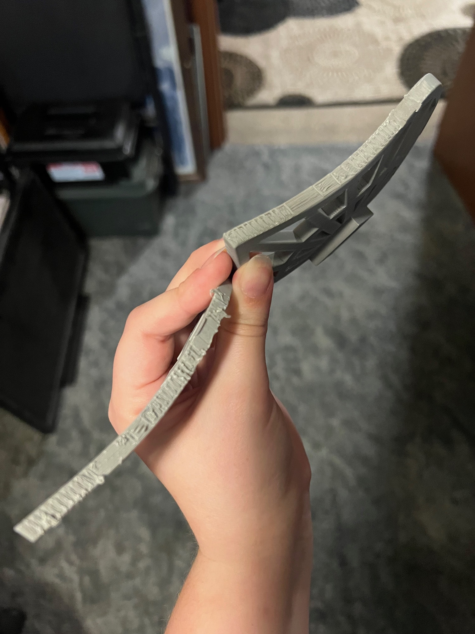

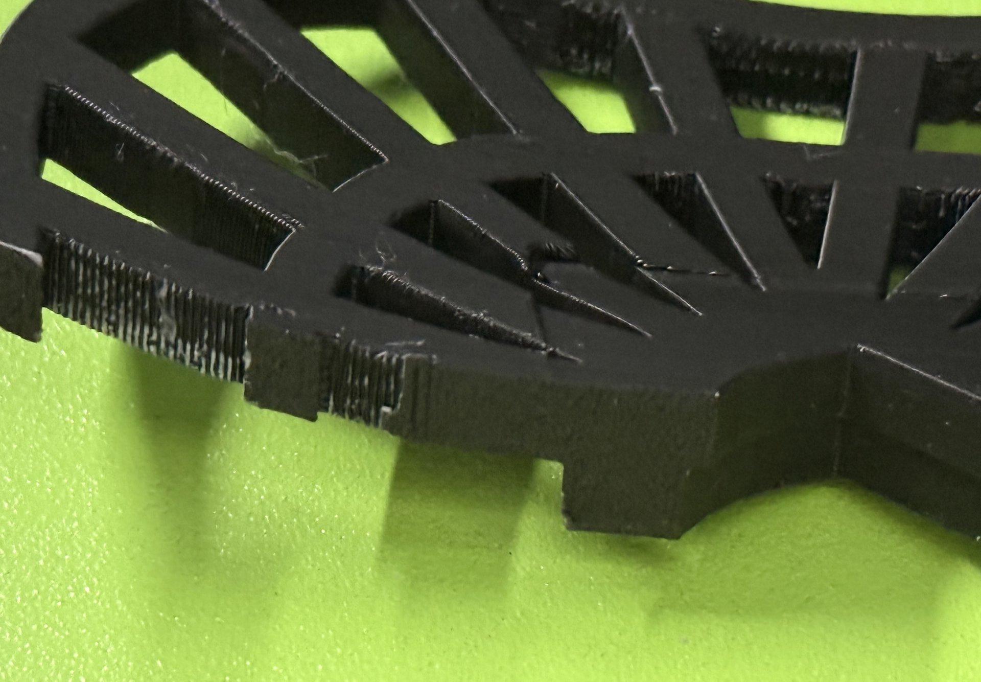

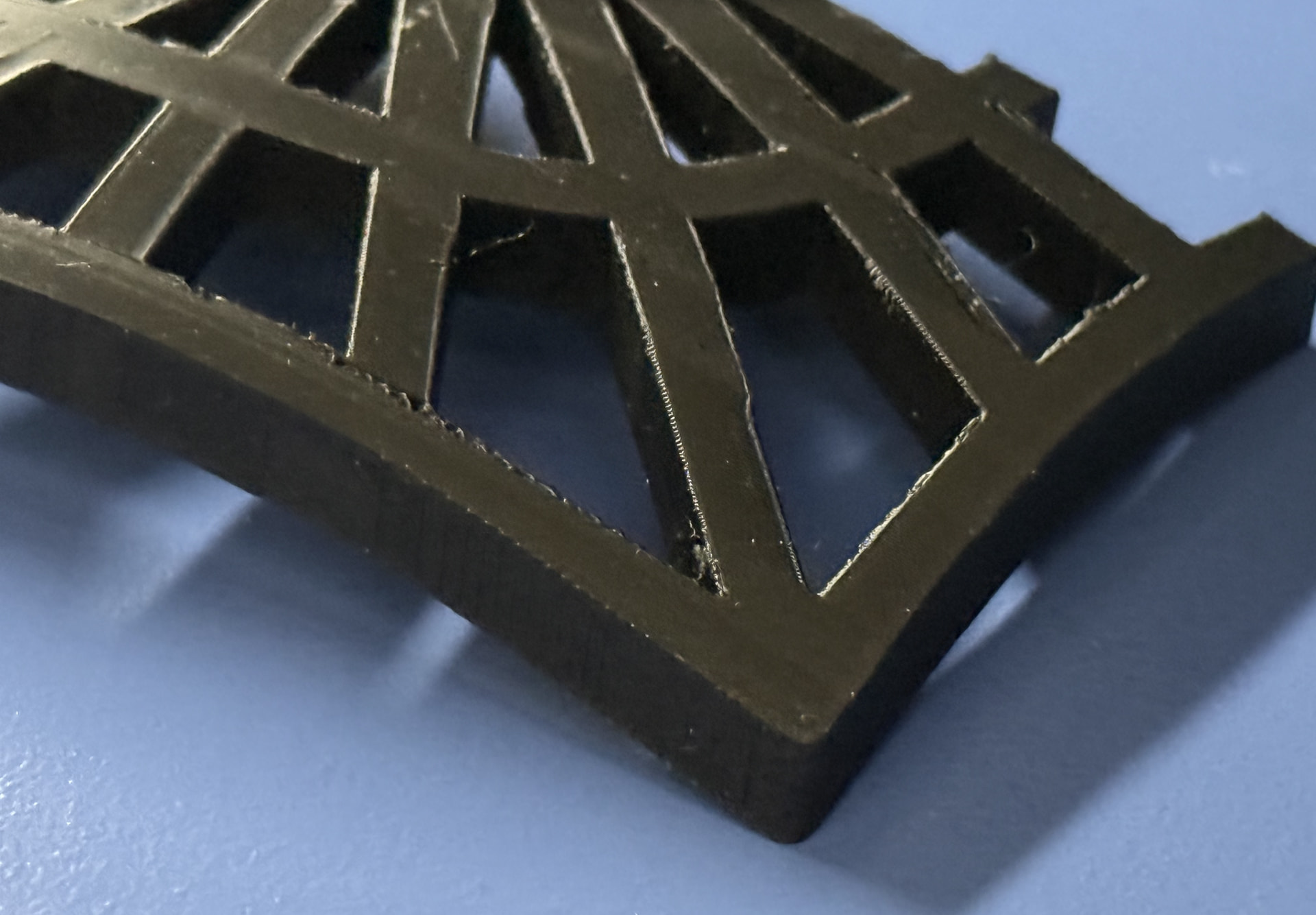

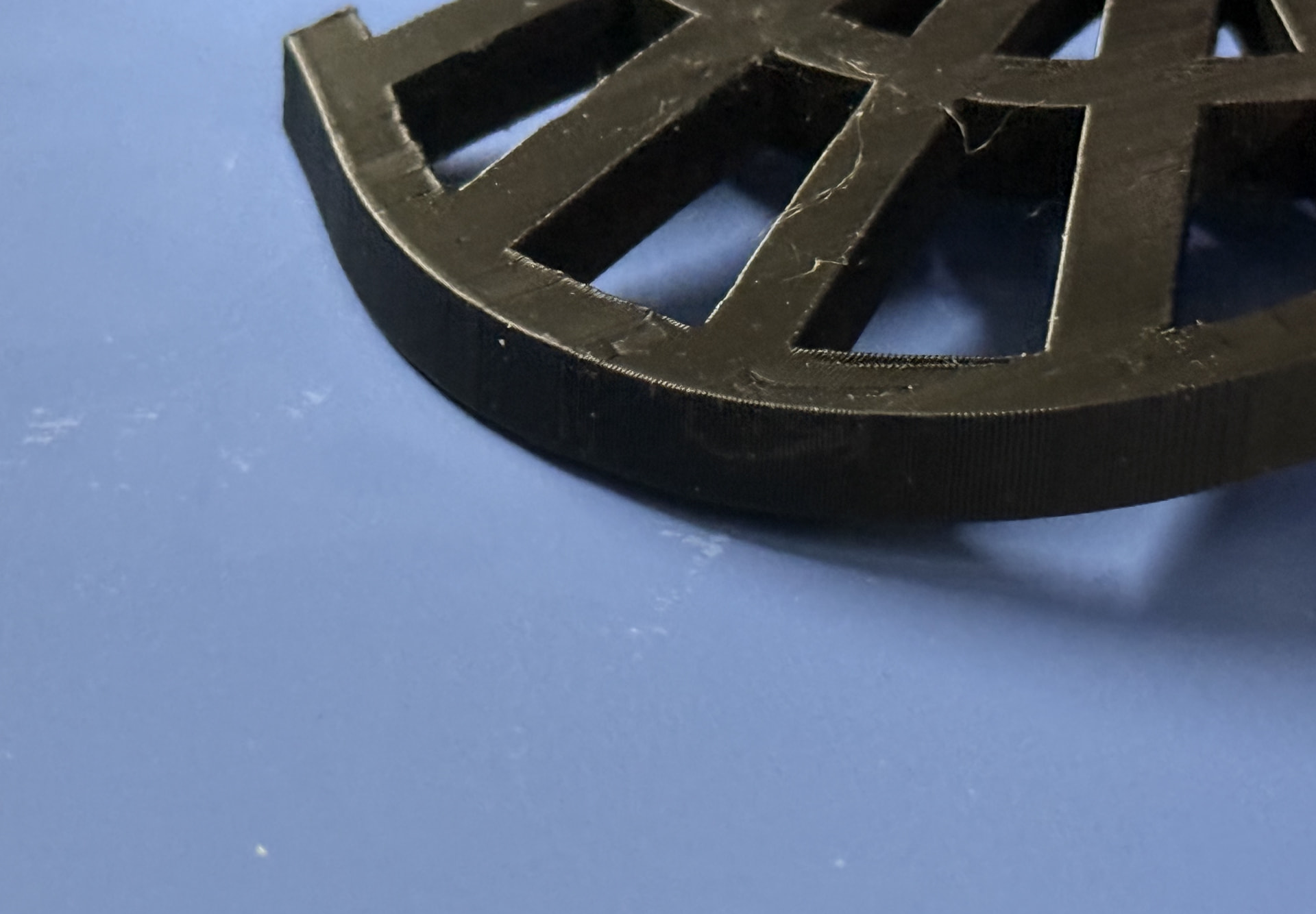

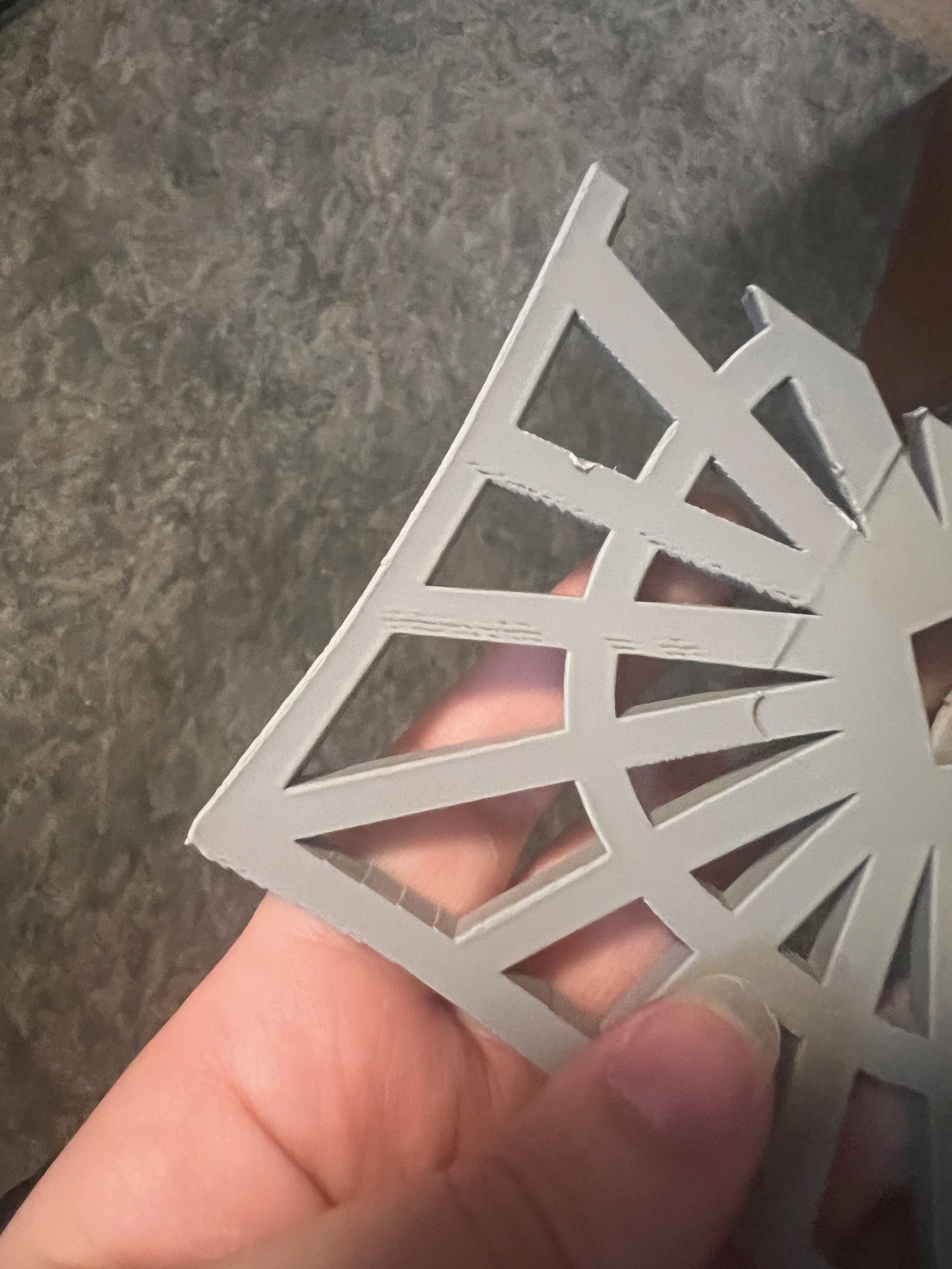

Well I’ve tried testing some over the last few days but I’ve had no luck. I orientated it on its side so it’s standing up more. The scarring seems to be worse and now I have some weird pits in the layer lines, especially around curves. Not sure if that could be from a partially clogged nozzle but any extrusion tests with the PLA looks to be coming out normally. I’m at a loss for what’s going on at this point. :smiling_face_with_tear:
Left side is my last print and right is the test before.
Pitting on the main surface:

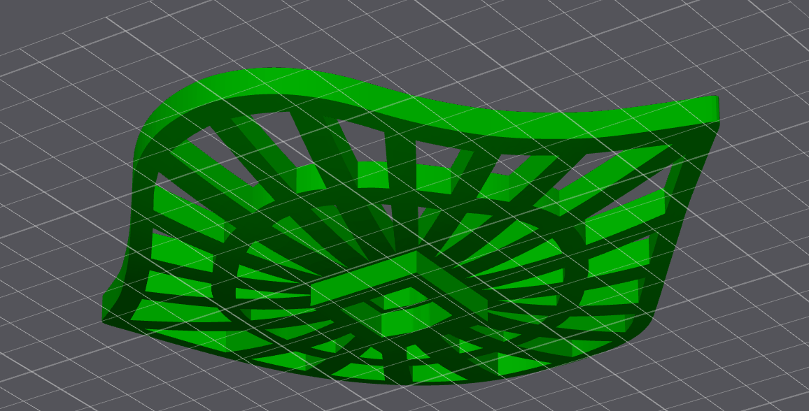

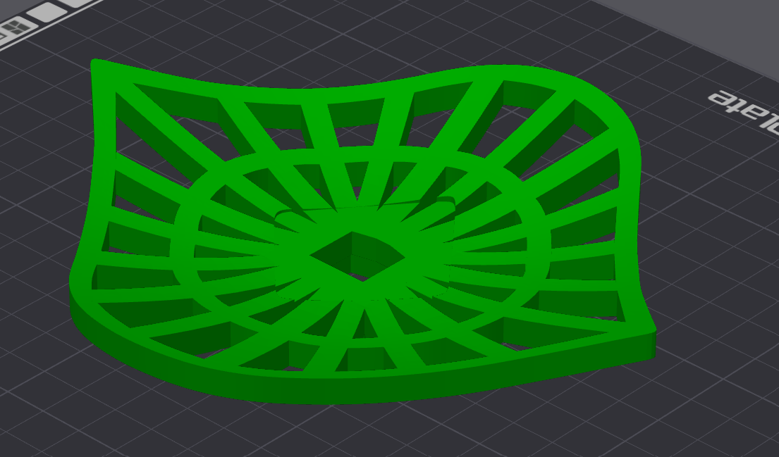

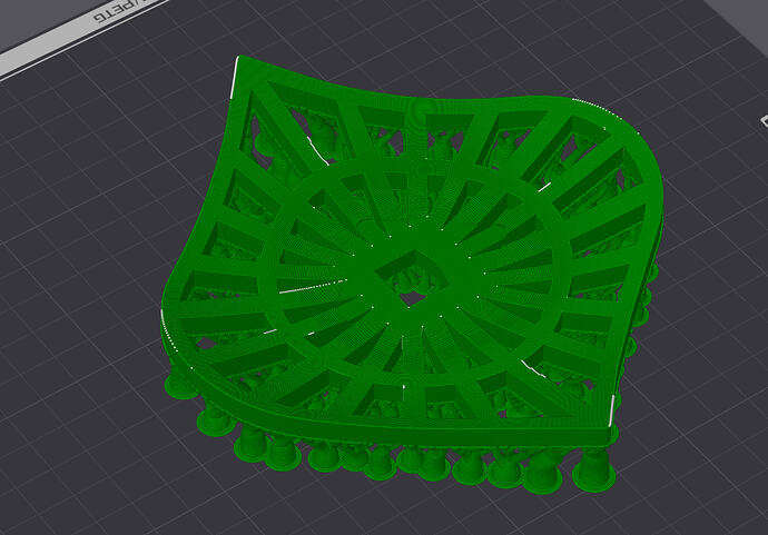

Share the model from the latest photo as some of us may wish to give it a try.
Either way, select the object and apply variable layer height from the toolbar. Just hit the first button (adaptive I think, from memory) and apply.
This will aid some of the harshest angles to be smoother.
Add support, likely ‘tree > hybrid’ would be a good start.
The base should be the smoothest edges, I am not sure which side you showed in the photo.
It looks like it may require a brim.
LED Guard & Grip - Test Settings.3mf (3.9 MB)

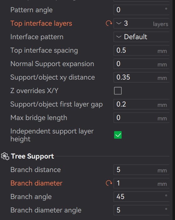

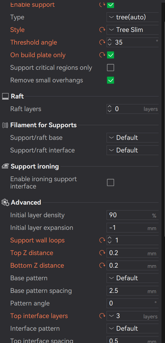

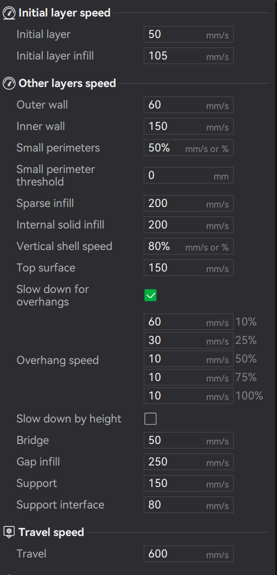

This file has both the guard and grip pieces with the settings I have been using. I included plates for both angles of the guard that I have tried (flat and upright). For some extra info, I’ve tried Top Z Distance between 0.2 - 0.25 but set this one inbetween (I beliveve I set it to 0.24). Variable Layer Height has always been on with Adaptive at 0 and Smooth at 10. I’ve tried Trees set to Default, Slim, and Strong just to see if something worked better than others (not really anything significant though). I’ve also tried narrower tree tops to minimize scar marks with connection points.
My prints are generally super smooth but recently has the weird layer line pitting and horrible support surfaces / removals on pieces. Feel free to try these out and let me know what you find - Thank you! :slight_smile:

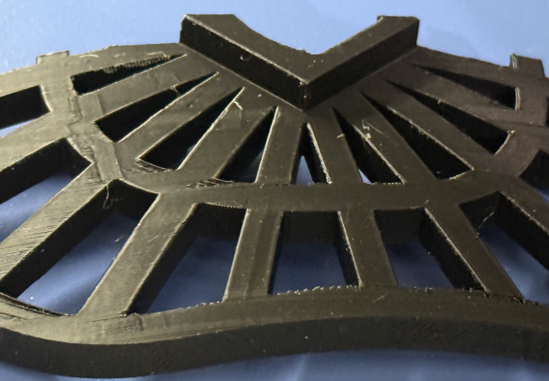

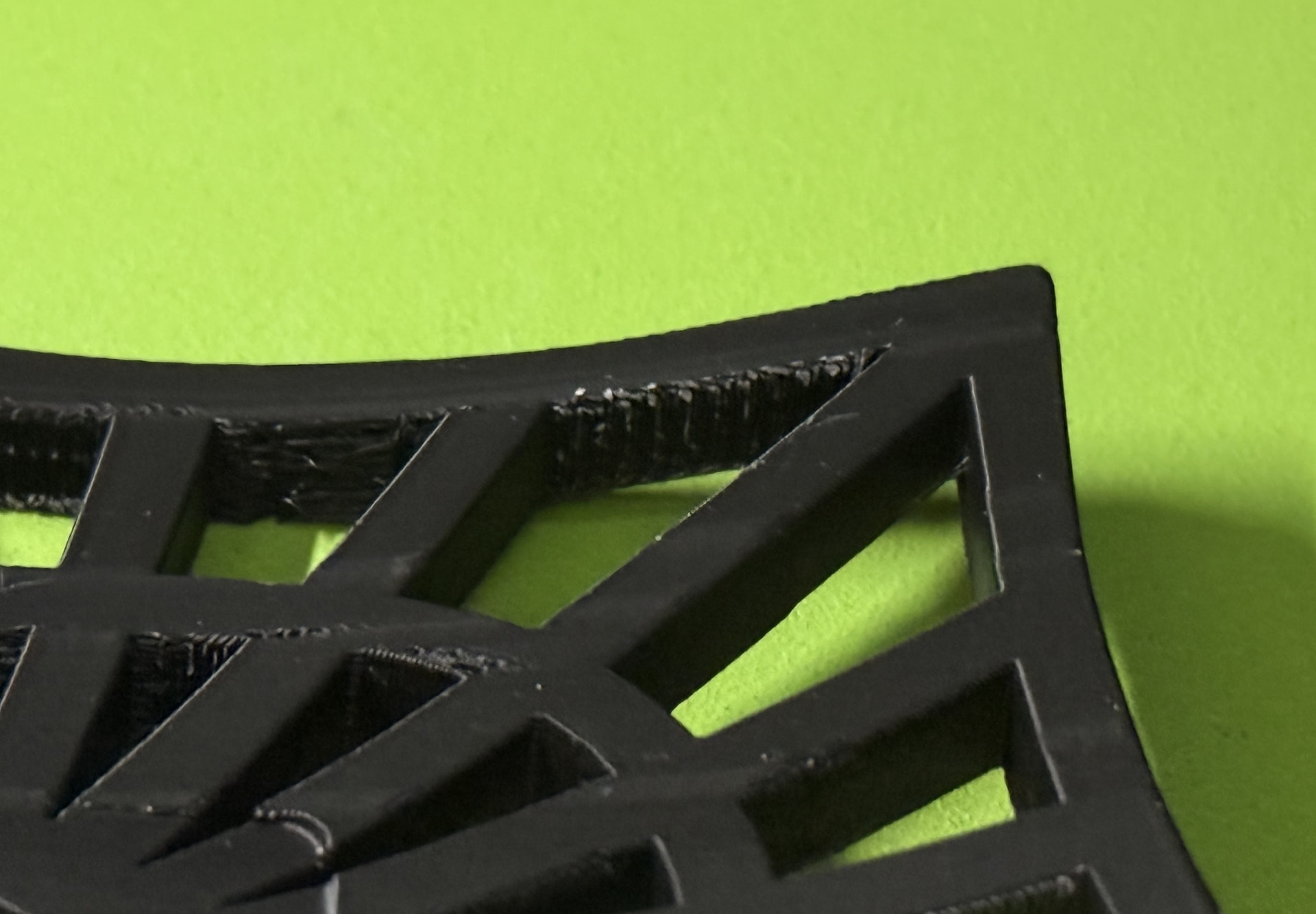

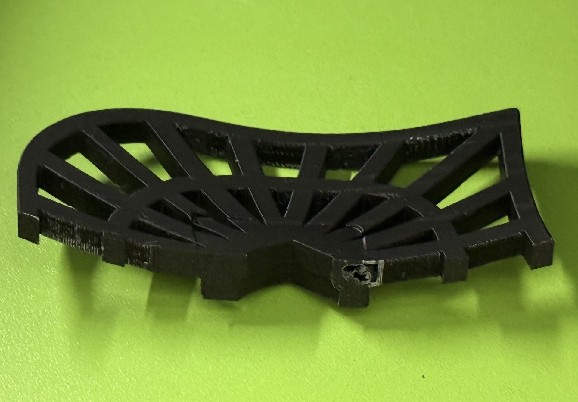

It has finished.
I have removed the support, done easy, some with a little effort.
It looks relatively smooth. I will need to use a flame (lighter) to clean a couple of areas.
I will take before and after photos.
I will also provide you my 3MF. As it is 2am and I am very tired, I will do this tomorrow.
You will need to design a plug and socket to join the two sides together or use a PLA suitable glue like Cyanoacrylate (CA) super glue, such as Loctite or Gorilla Super Glue or a specialty glue like PLA Gloop.
Thanks again! Absolutly no rush. Would you mind also sharing your filament settings when you send photos? I’m just curious even if it might be different filament.
I couldn’t find my lighter, but it would only make the white stress marks become the filament colour.
I used almost all your settings for the model and filament, I only changed the colour I used, it was also BL.
The only setting change can be found on the model part settings. Support, hybrid and not slim.
I positioned the model halfway through the plate so it only prints the portion above the build surface.
Almost all the imperfections are only viewable ion the photos.
The first photo has a surface error (bottom right of centre), I went a bit mental while removing the support, that was me, not the model.
Oh wow! Yeah some of the stuff you’re seeing is what I’ve been getting in terms of surface imperfections and troublesome supports. I’m just glad someone else is getting this and it’s not just something with my printer. This makes me thing it’s something in the settings that’s messing with both issues.
