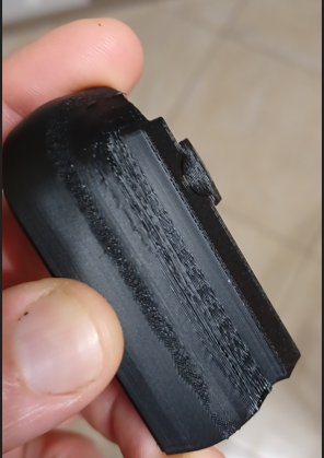

Hello Everybody,
I’m trying to print the model shown in the attached pictures, but I can’t figure out which type of support material or settings I should use to get a decent result.
I’ve already tried many configurations, including using PETG as support.
Could anyone help me with this?
Thanks!

Raggedness on the large rounded side:
If you have CAD control of the model, change those rounded fillets into something that starts as a chamfer. Printing undersides of spheres is an incredibly well-identified problem domain, and you’re in it.
Raggedness on the shelf leading into the rounded side:
Change support to produce a better more full support interface. I would suggest 3 interface layers with 0 interface spacing, and set your top Z distance to something between 0.14 to 0.20. Ironing the interface can have some help too, if your slicer allows

It would most helpful if we saw a image of the model and how it is set on build plate.
From what i see in your image, model sits on the build plate in the long face (horizontally). i suggest to turn it vertically, so that the thin side is on the build plate. This way you should avoid the bad result. Considering that there is a little part that goes out and floats, i think you sould enable supports (tree). Try and let me know
I can only give you back the same level of specificity you gave in your original post.
I would orient the part correctly and turn on supports. Use a top z distance of .25 or .3 I’ve never been able to get PETG to work reliably as a zero interface support material for PLA. But if you print the part in ABS, HIPS is a fail-safe support interface material.
