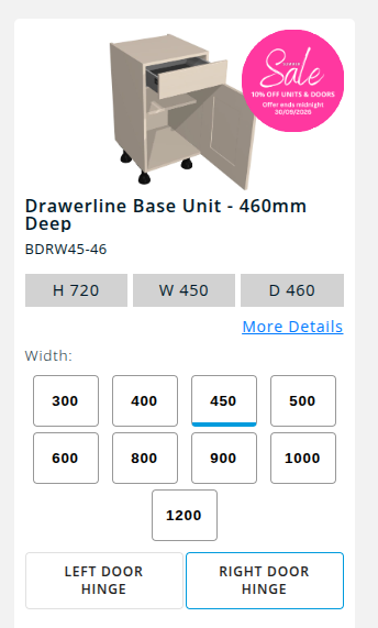

My recommendation would be to purchase a slimline kitchen cabinet, and put wheels on the bottom instead of the legs, and a worktop on the top (or just get a wheeled kitchen island). You will get a sturdy table with cupboard for filament, a drawer for tools etc. You can configure them how you want regarding size and cupboard/drawer combos.
Something like this should fit a P2S at 450x450.
You can print door handles, and a grab handle to push it around.
You will need to buy some wood for a worktop, 4 wheels, the hinges, the door, and drawer box and fronts if you want a drawer. Drawer boxes are expensive; if price is a problem get just the cupboard instead. I personally would go for 1 drawer, and a cupboard beneath.
EDIT I would also put a piece of plywood UNDER the base, because kitchen units are supposed to be fixed to a wall, so you need some additional rigidity.
