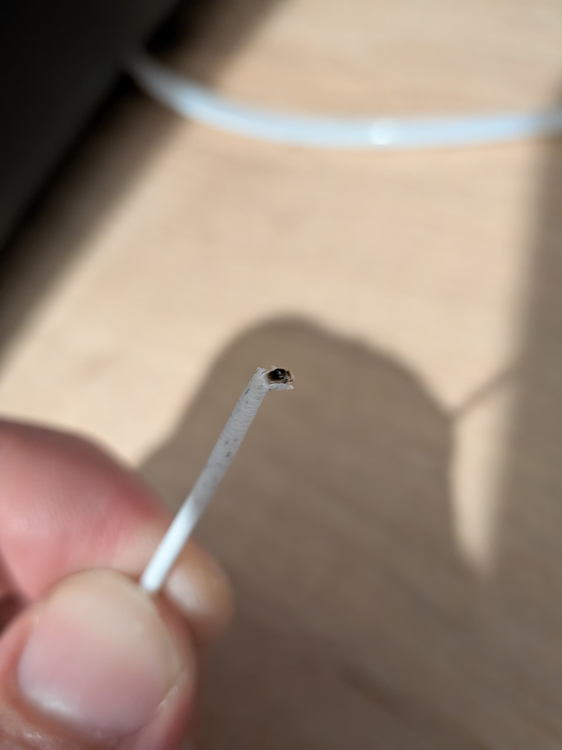

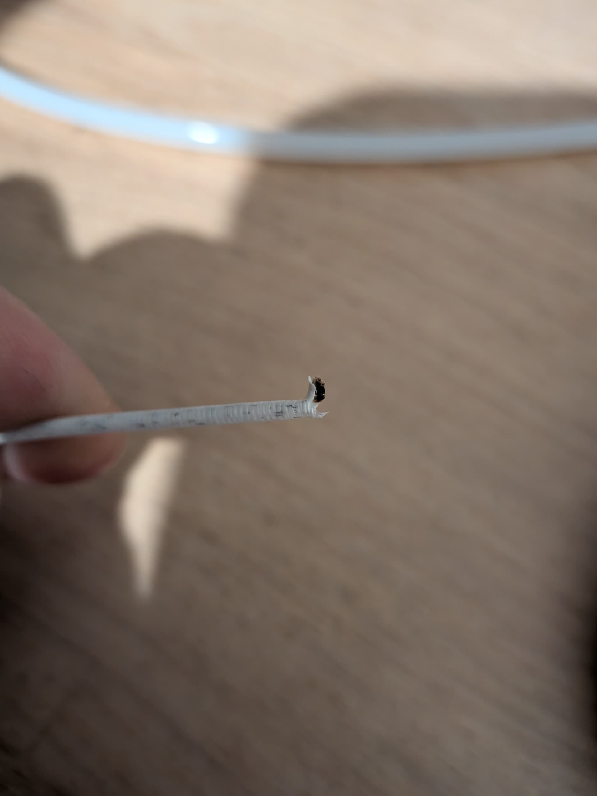

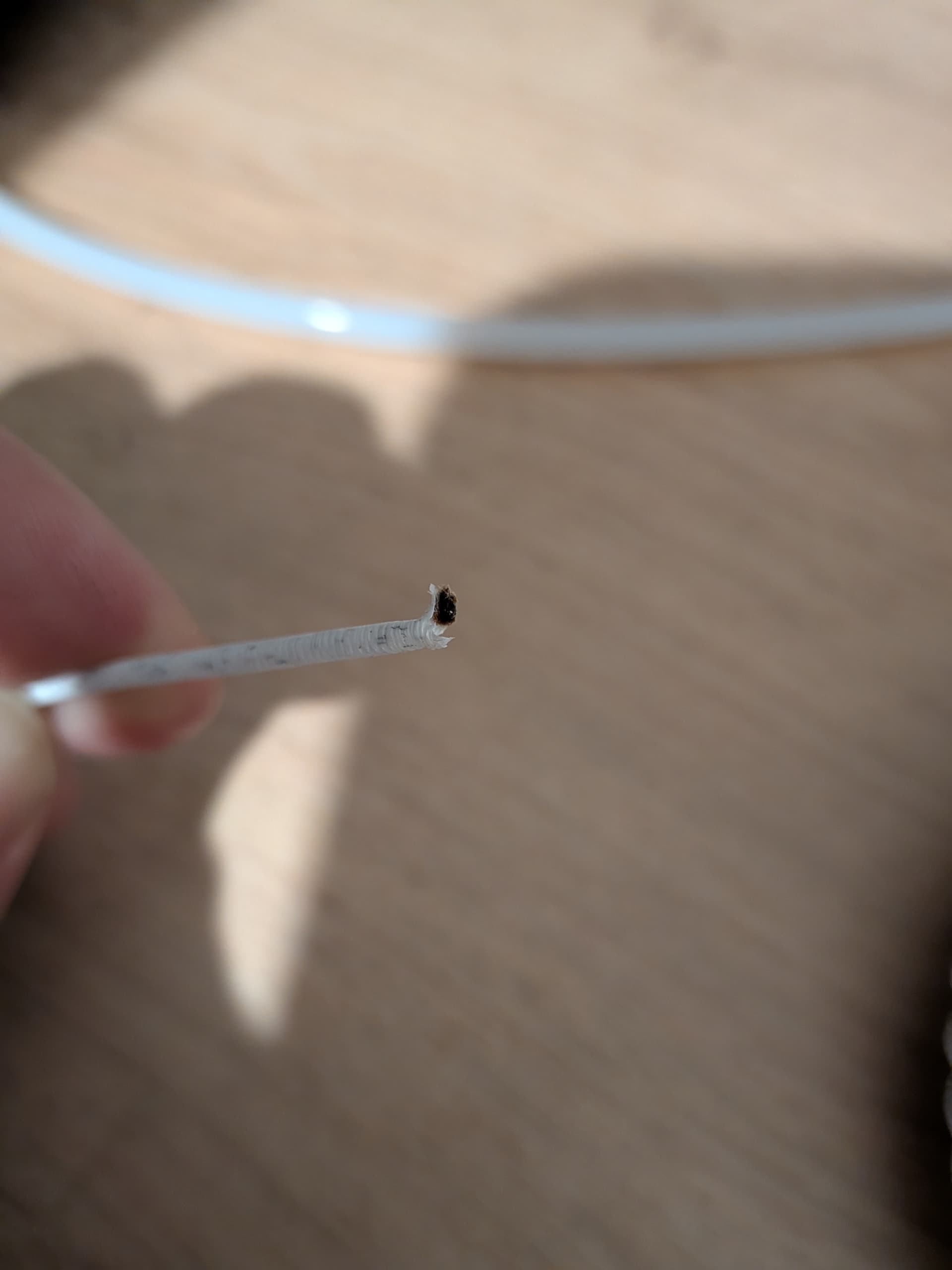

So I was having trouble with some BL PLA Marble feeding through my AMS hub, assumed it was the hub as this was where it was getting stuck. Took that apart, no obvious jams/debris, back to the drawing board. Anyway after a few feeding attempts, the filament eventually snapped. Pulled it out and found some sort of melted bug (for want of a better description) embedded into the centre of the filament. BL (or Sunlu or whoever makes this particular filament) need some pest controllers in their Quality Control Team it seems :rofl:.

Short answer: A bug being embedded during filament extrusion is extremely unlikely. What you’re seeing is far more likely to have entered the filament path later (AMS, PTFE tube, extruder, or nozzle) and then became partially melted and pushed into the filament.
Let’s break down the possibilities.
:one: Bug inside the filament during manufacturing (very unlikely)

:two: Something entered the filament path later (much more likely)
Looking at your photo, the dark spot appears at the center of the filament cross-section after it snapped. That can happen if something:
  • Gets sucked into the nozzle
  • Gets picked up by molten plastic
  • Then gets pushed backward or smeared into the filament core

:fire: Carbonized filament contamination
This is actually the most common explanation.
Old PLA inside the nozzle can:
  • Overheat
  • Carbonize
  • Break loose
When that carbonized chunk gets pushed into new filament it can create a black “inclusion” that looks organic.
People often describe it exactly like this:
“Looks like a bug, but it’s actually burnt plastic.”
:three: The clue in the photo
What I notice:
  • The filament snapped cleanly.
  • The dark spot is very small.
  • It looks charred and glossy, not structured like an insect.
Real insects usually leave:
  • visible legs
  • wing fragments
  • irregular shapes
This looks more like a tiny carbonized plug.

:white_check_mark: Most likely explanation
Carbonized PLA from the hotend or a small contamination particle that got pulled into the melt zone.
:cross_mark: Least likely explanation
A bug embedded during filament manufacturing.

The carbon is probably from the extrusion process. We have that happen at work and usally when it starts they have to pull the die and clean it. Not sure why bambu didn’t just say sorry it happens some times.
