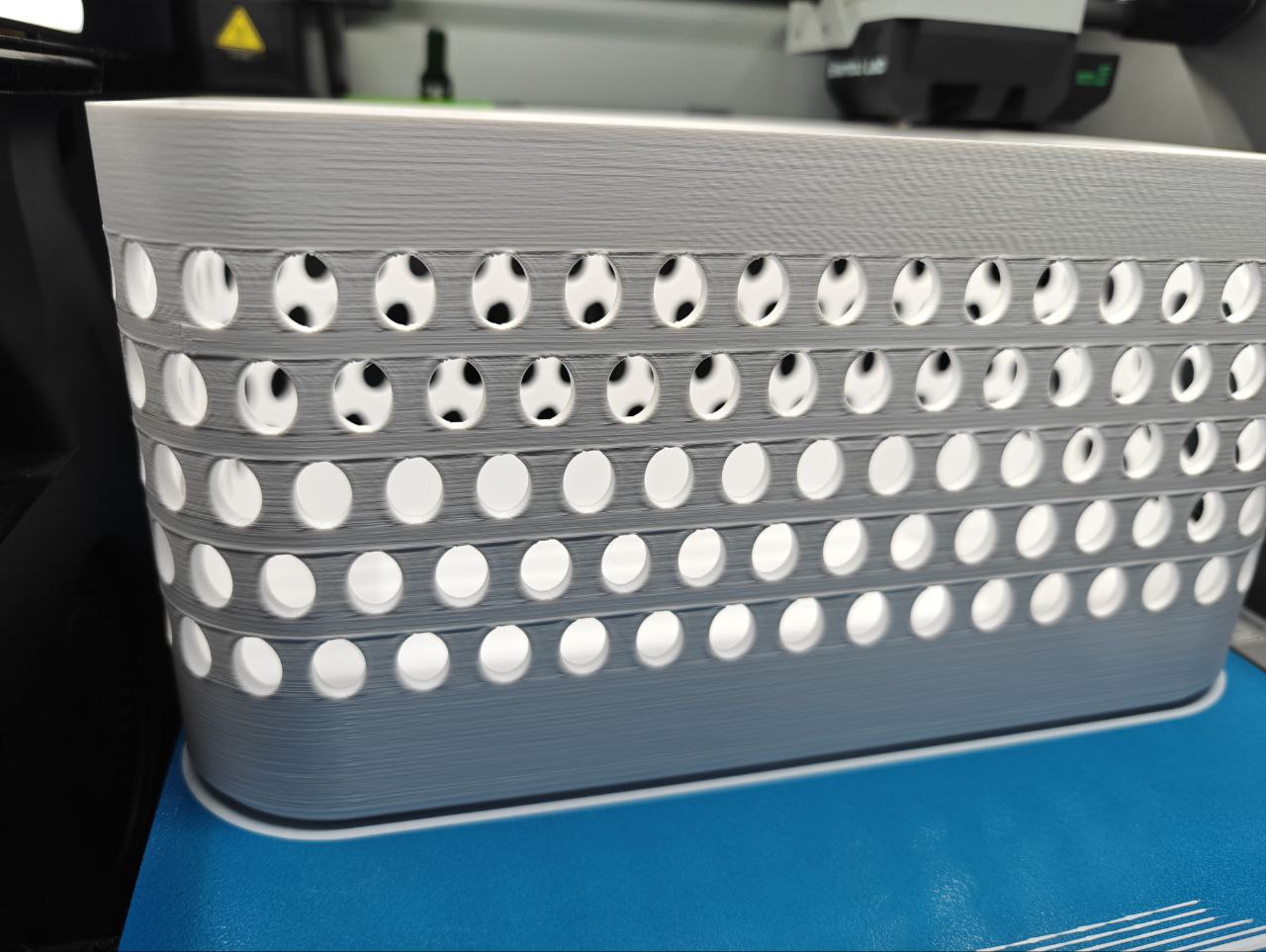

What the heck happend here ... PETG-HF looks horrible
This is Bambu PETG-HF with default 0.2mm strength profile.
Filament has been dried for a minimum of 18 hours at 65c.

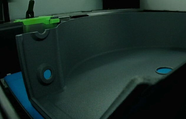

As comparison, the second and third picture is Eryone PETG-CF and is gorgeous so I cannot imagine it’s the printer. Did a full maintenance not long ago (100 hours ago).
You can’t compare with CF filaments, they generally hide layer lines very well. Looking at the HF one, it appears to start ok but gets worse as it goes up. I’ve had a lot of trouble drying one batch of PETG HF - it took a very long time to dry the inside of the spool - maybe this is also a drying issue. But your print doesn’t have any zits on the surface like mine did.

Put the slicer view into ‘speed’, I’m not sure what the solution is but it’s definitely at that bridge / steep overhang after each level of holes. The flat areas don’t look the best either though.
For me using a lot of PETG-HF in black I went to 260C with the nozzle to avoid nozzle blobs and the project also had some weird organic overhangs and all these speed changes (from overhang amount and speed smoothing) on the layer were screwing things up big time so I just made it all very slow since i did have areas with greater than 50% overhang, didn’t have the option to just blast through it, but here?
I think I would set my overhang and bridge speeds to 100mm/s for all. I’m assuming that will work both for bridging top layers and any overhangs.

But you don’t have such overhangs, the tops of those circles are 1mm at best it appears, so I would suggest a faster speed in the case of this model. I also almost suggest outer wall first but not sure that will work well with those overhangs.
It does concern me that its looking the same with the changes you made but make sure to use that speed view, im my case the coloring of the speed view matched the issues, easy to see the changes in speed were the source of the problem. You should verify that you see the same or similar.
Also, you might want to turn off the speed smoothing on the quality tab. If you attach the latest .3mf you are working with I can load it up here and take a look.

It’s not a speed issue, it’s a round hole issue. As it does the very difficult overhangs, it curls up a bit and gets caught on the next layer. Here is my PLA print - same thing. If I had a bunch of holes one after another, it’d just be a line too.
Yea I resigned to the fact that without supports, it just won’t be possible.
The filament is over extruding because it is slowing down for that overhang, it’s extremely obvious because it’s an overhang essentially for that entire layer all around the model - It’s looking worse and worse because every time you over extrude it’s making the height of the model ever so slightly higher than it should be… this builds up.
I don’t think your model will print nicely without supports or a redesign (or adjusting the flow when you slow down…)

I found by accident Eryone PETG-CF and that stuff prints like a dream. I mean yea CF tends to hide layerlines anyway - but this stuff looks almost like moulded
