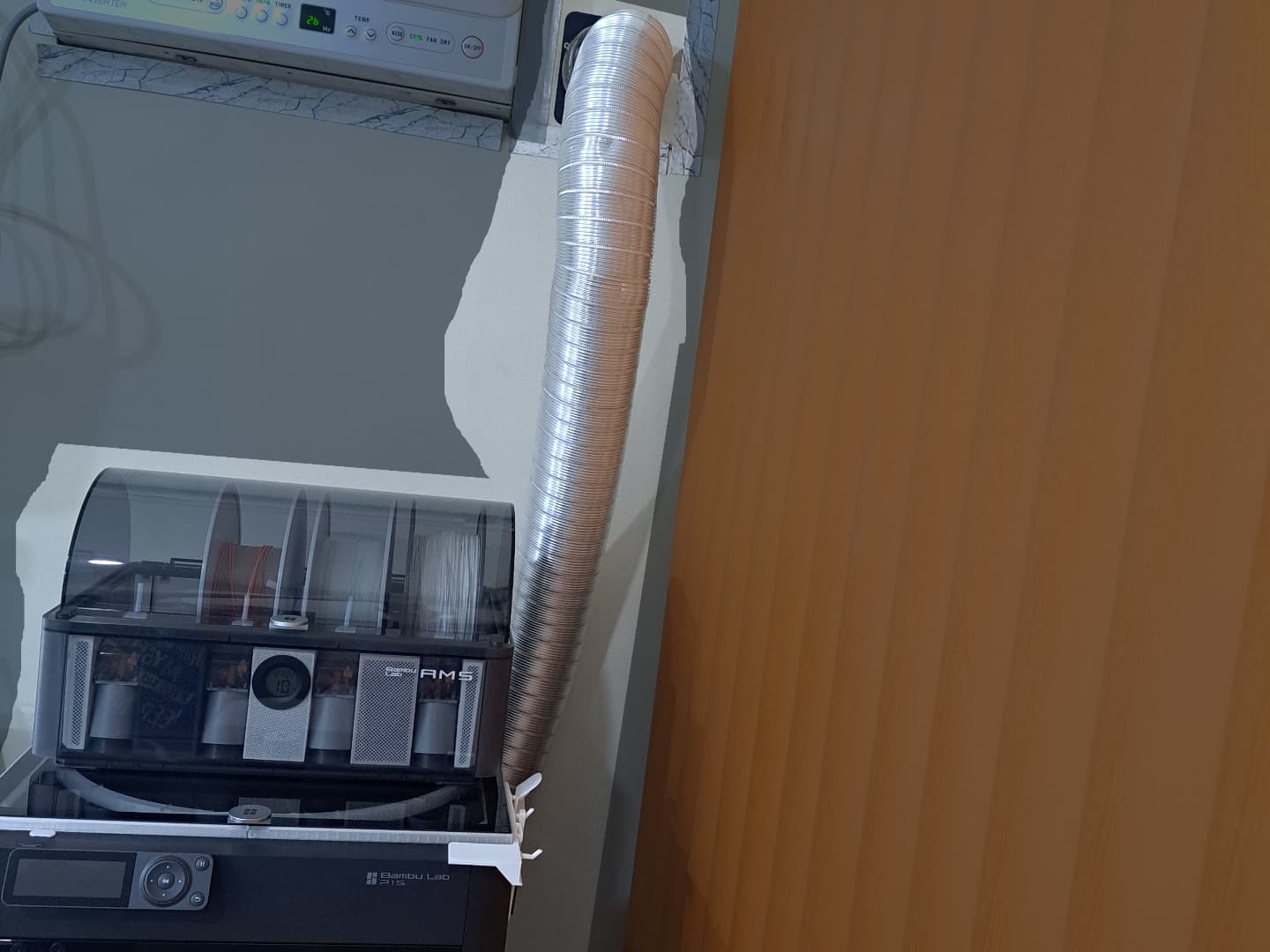

Not an option for rmost, but I connected an exhaust pipe and blow it directly out of the room.
Just another P1S exhaust solution
Does help a lot, but not 100%. Still can smell it sometimes when I print ABS. Depends as well on the length of the print.
The AC is mounted in a hole in the wall and hose is next to it, but far from the intake of the AC.
