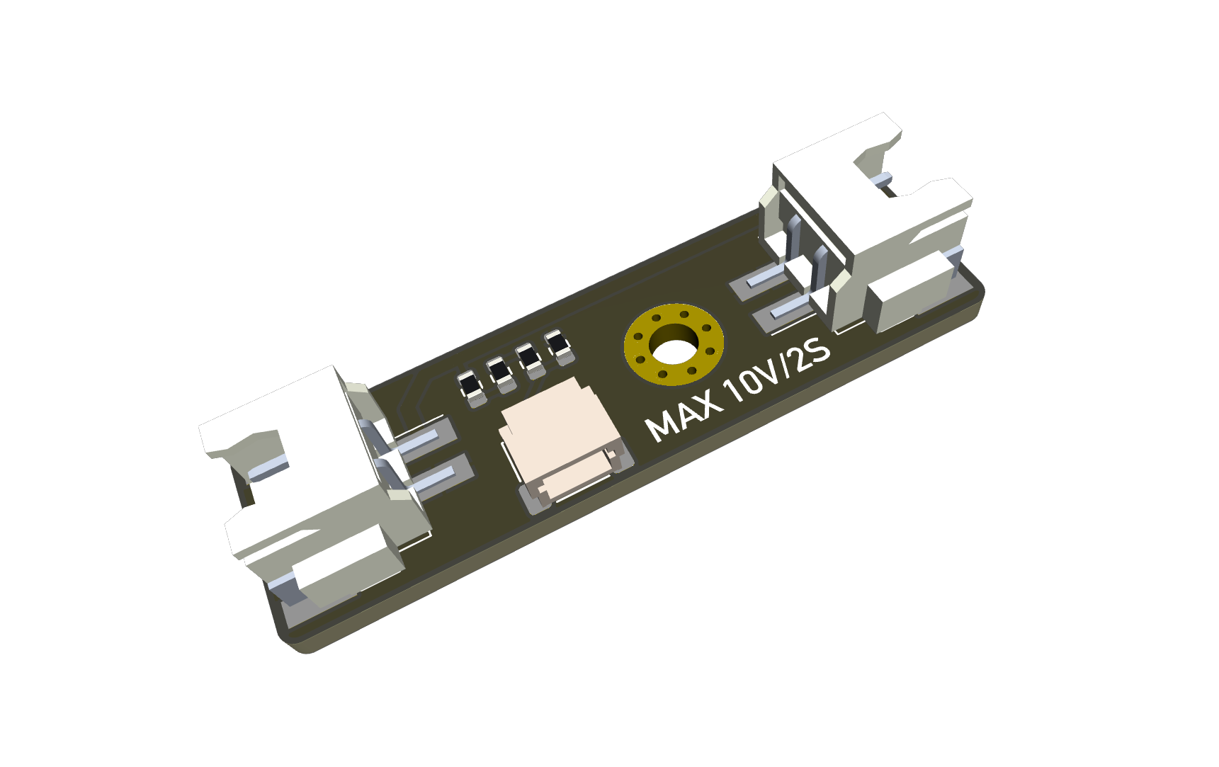

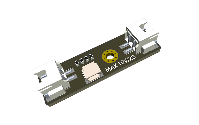

I just designed something that I think would work as an add-on and it’s made to use one of the analog inputs (on the transmitter shield) or maybe a cable hack on the Receiver. If I remember correctly, the ESP32-C3 needs the analog voltage to be between 0 and 2.5V so I have made a resistor divider with 4 identical resistors (eg. 10K)
Battery can be connected in one end, and the load (shield) in the other end.
I have ordered PCBs. Will release design files when tested and found to be working.
If you make such a power meter adapter, please consider adding also current sensing that IMHO would also be interesting.
Thus why not add something to measure it as well and provide a voltage divider analog port for measuring battery voltage and a second analog port for measuring current as well. This is done very similarly in many higher end R/C models, e.g. PM02 V3 Power Module (12S) – Holybro Store
On X11 receiver shield, analog input is possible only on servo 1 to 4 control pins and motor 1 control pins, where although already HTD8811 is wired up. Thus realistic for an end user, w/o having to solder anything, is to only use the servo headers for injecting analog signal. Will work with custom MicroPython code, but not with stock CyberBrick app, as the default stock CyberBrick app does not support inputs (analog nor digital) on the receiver side/shield.
Yeah, that would also be nice to have, though to get a decent performance in the current range of a CyberBrick style vehicle, it’s a bit more elaborate than the simple voltage divider for the “fuel gauge” reading.
Personally I would probably go for a semiconductor solution with a small chip that handles most of it and maybe move to I2C for communications to the core. I know it’s not directly available on the shields, but it would open up for a bunch more sensors etc. and simple cabling (same type of connector but 4 pins, following qwiic/StemmaQT standard). I kind of did already add that connector on the Display Shield I designed.

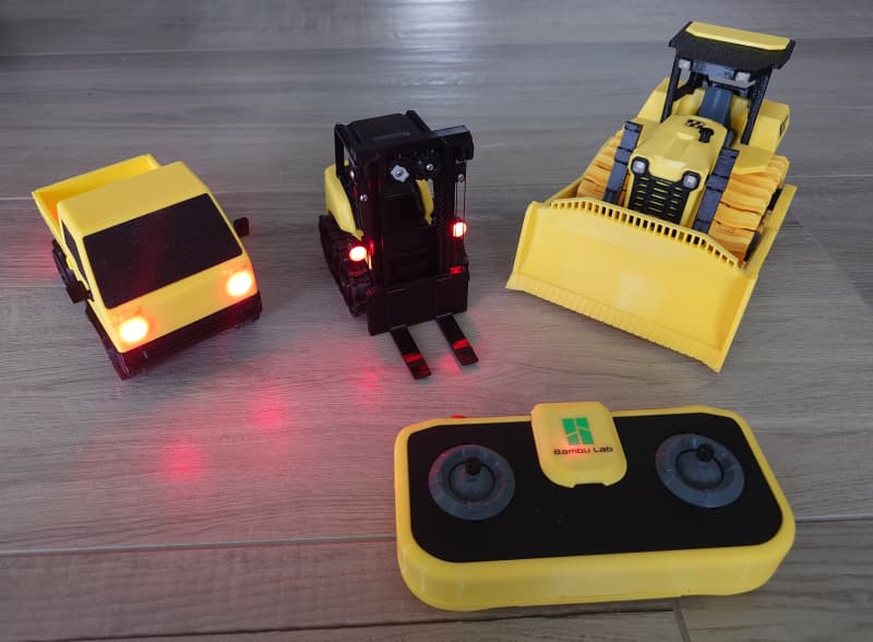

For the interested, I added ESP-NOW control code also for the Bulldozer by MottN. The code can be downloaded from: CyberBrick_Controller_Core/src/community/app_espnow/rx/bulldozer at espnowdemo · rotorman/CyberBrick_Controller_Core · GitHub
With the custom MicroPython ESP-NOW code, I can now control 3 models from single remote, switching via 3-way switch: forklift, truck and bulldozer.
