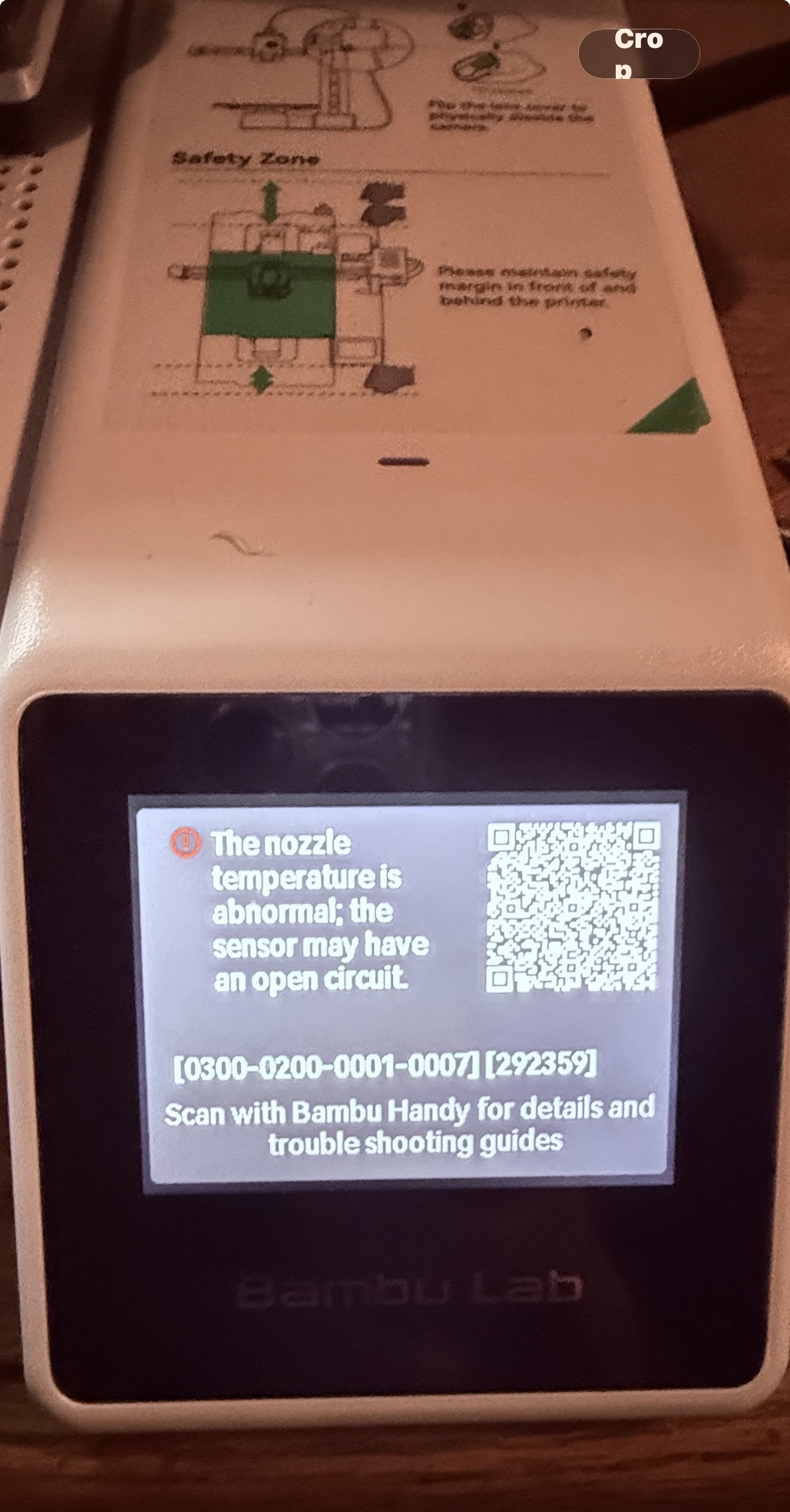

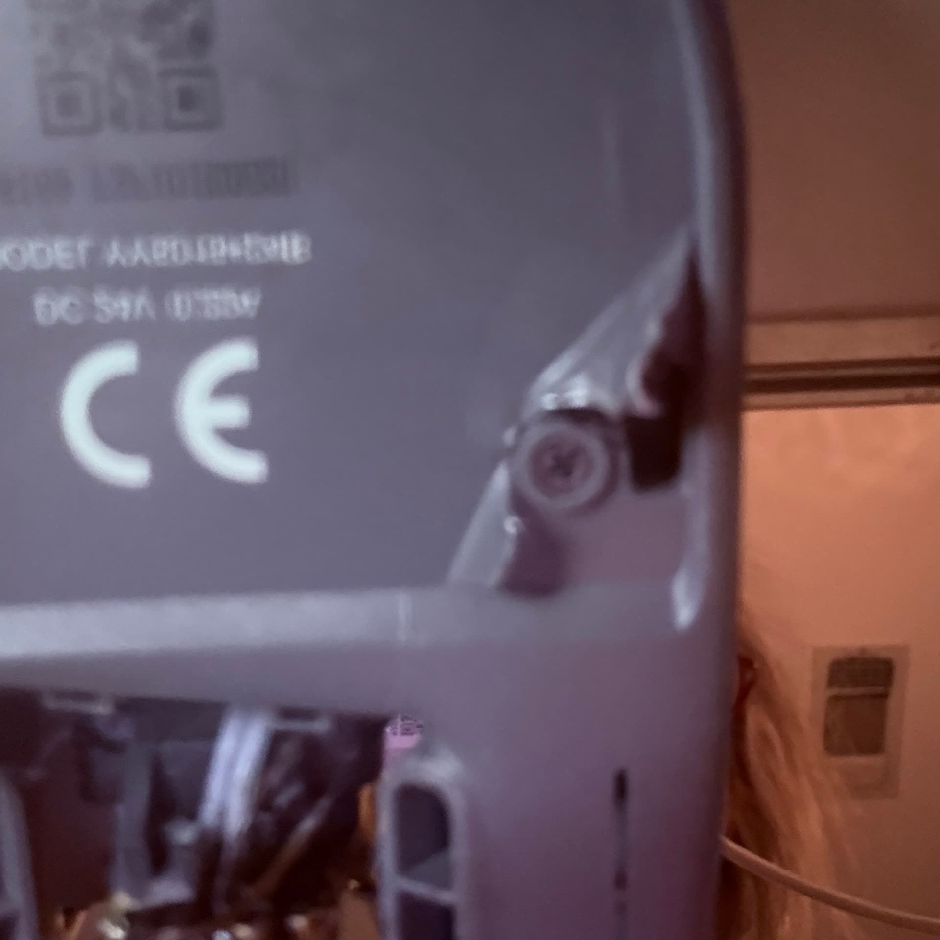

I received message of ‘The nozzle temperature is abnormal; the sensor may have open circuit’. I am providing several photos.

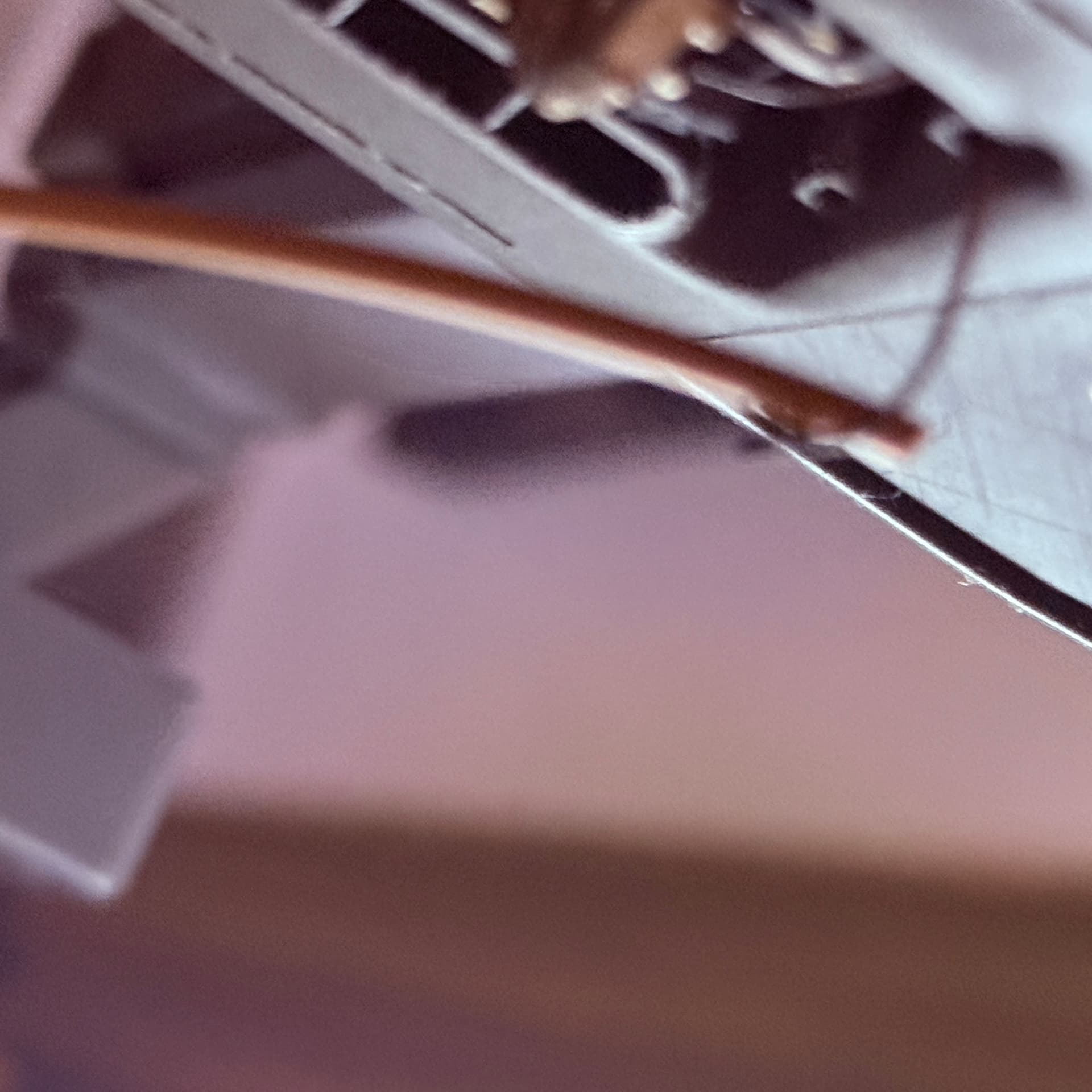

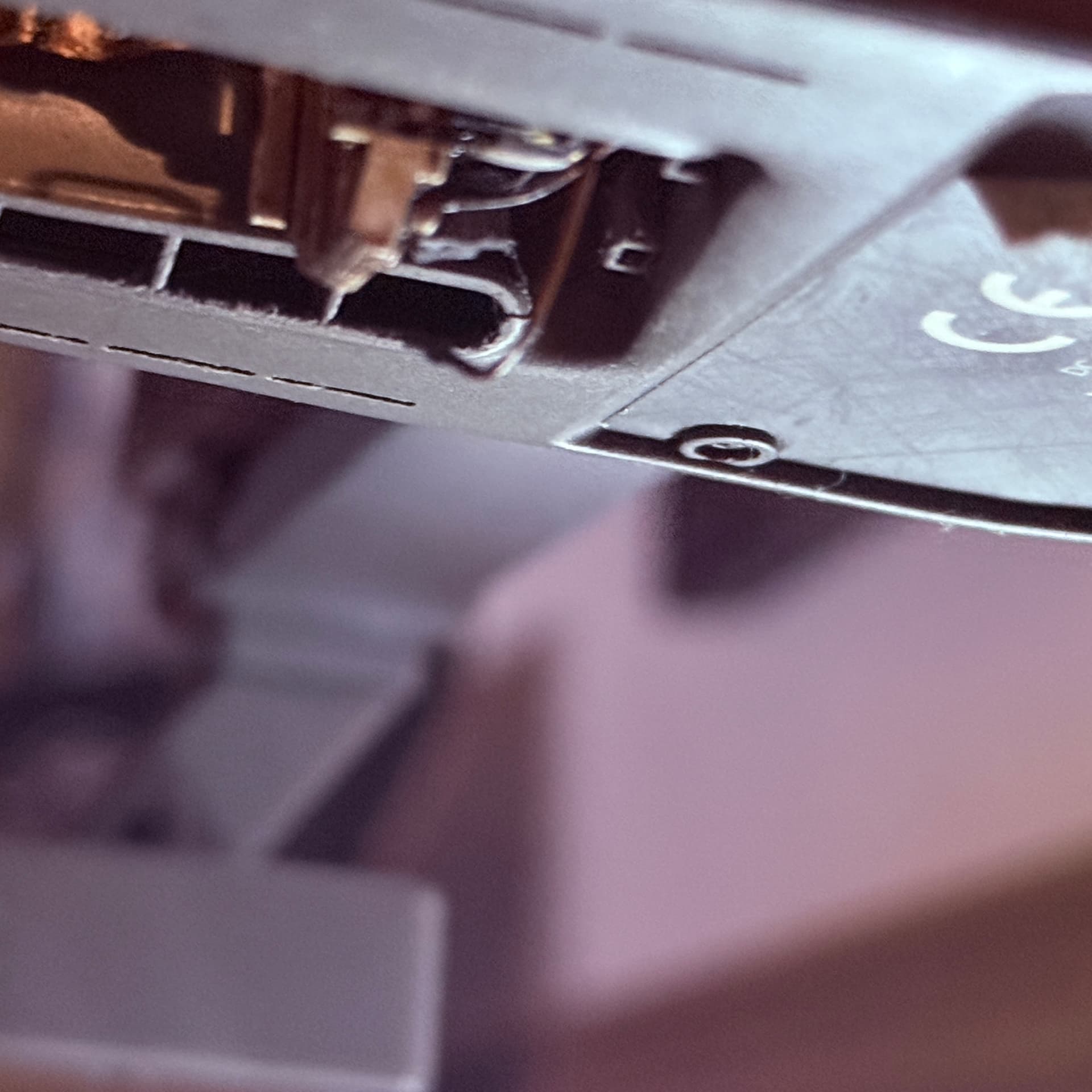

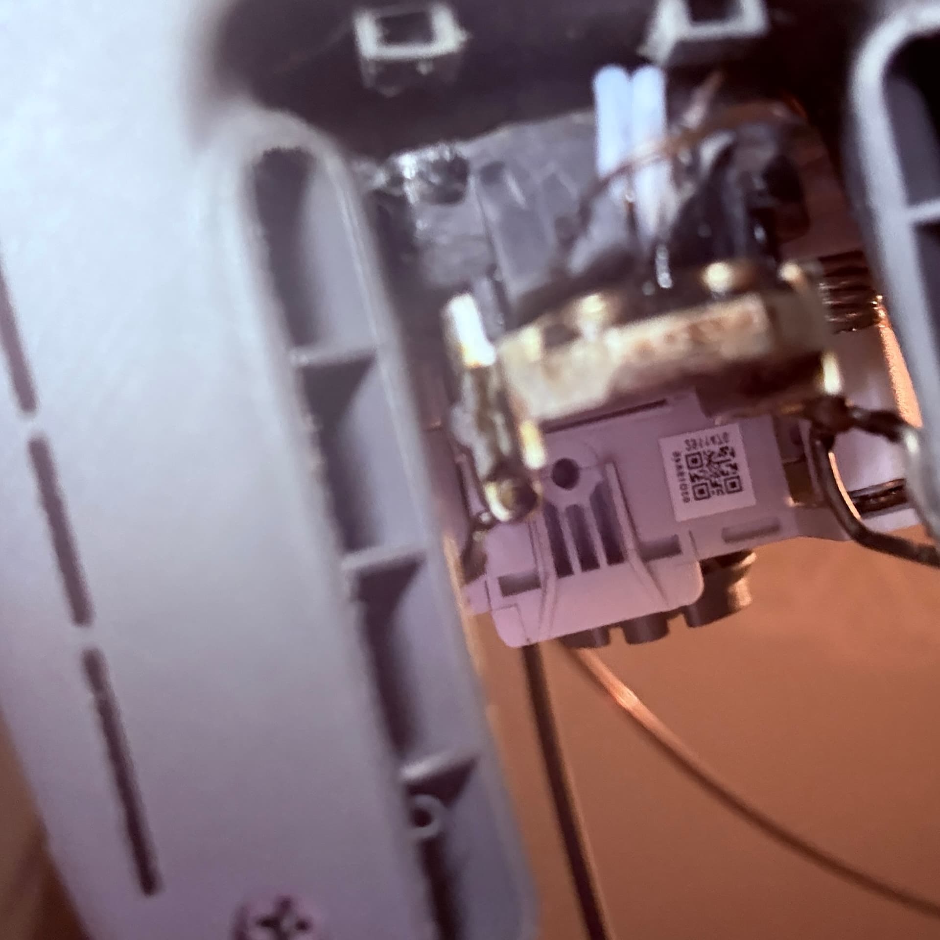

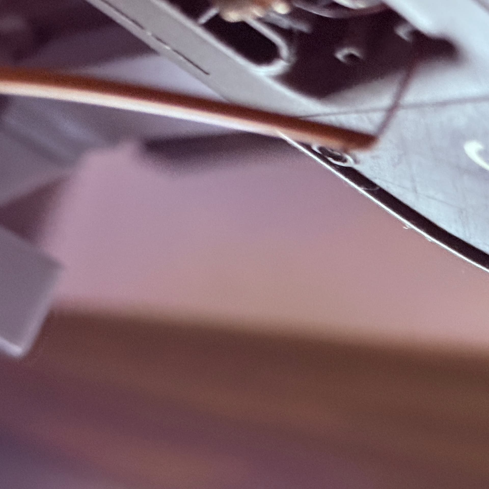

The views are taken right under the nozzle head area and in a couple I am trying to show the loose wire with a piece of filament. Sorry my hands are not the steadiest.
There is indeed a wire loose, completely not connected. I appreciate any guidance on the part I need to buy. My printer is about a year and half old, so I’m sure not under warranty. I have not submitted a ticket but if you all think that would be a good idea, I surely will.

The part you need is this one…
@mugglesmuggle already pointed you towards the instructions for replacement. It isn’t difficult as such but you will need full access to front and back of the machine. I found the most difficult things to do were taking the rear cover off the toolhead housing and reinserting the right cable cover without trapping the wires.
