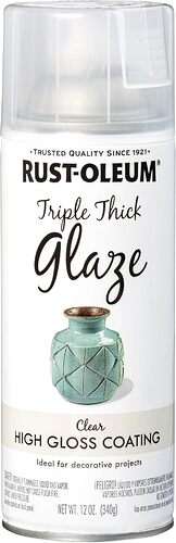

  1. Clear high-build coating - This is what I sometimes call the spray-paint cheat because a sufficiently thick, self-leveling clear coat can hide a surprising amount of imperfect surface preparation.
One product I’ve used successfully is Rust-Oleum Triple Thick Glaze:
It is an acrylic clear coating rather than polyurethane, and because it is solvent-based I would test it before putting it over another paint system. Incompatible or insufficiently cured undercoats can wrinkle, soften, lift or otherwise react with a subsequent solvent-based coating.
Rust-Oleum specifies several light coats rather than one extremely heavy coat, and lists the coating as fully dry after 24 hours under its specified temperature and humidity conditions. However, in my own experience in my humid 65F 45% RH basement paint booth, I found that one coat left under a lamp for 3-7 days produces a near hard shell glossing finish.

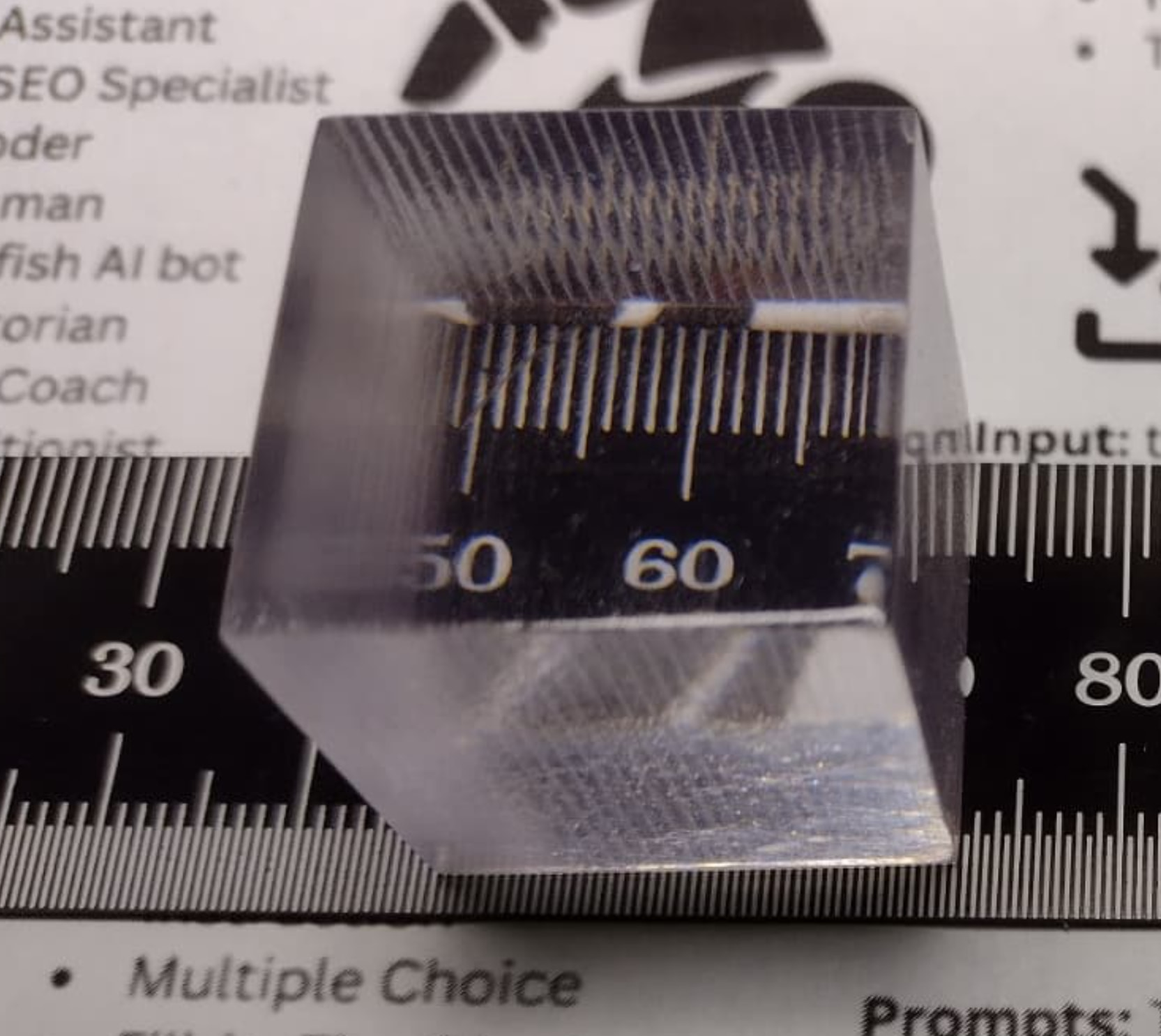

To give you an idea of what a high-build clear can do, here is a test I ran using slow print speeds, several clear filaments and sanding. The final step was Rust-Oleum Triple Thick Glaze.
This wasn’t specifically a paint-bleeding test. I was testing how much surface irregularity could be hidden to improve optical transparency. I only prepared two opposite surfaces; the sides were deliberately left untreated.
I call the clear coat a cheat because I was unwilling to spend the additional time required to polish the surface all the way to a high-gloss finish. Nevertheless, the difference is obvious from the top and bottom surfaces versus the sides which received no treatment. Those vertical lines you see are actually the horizontal layer lines.:

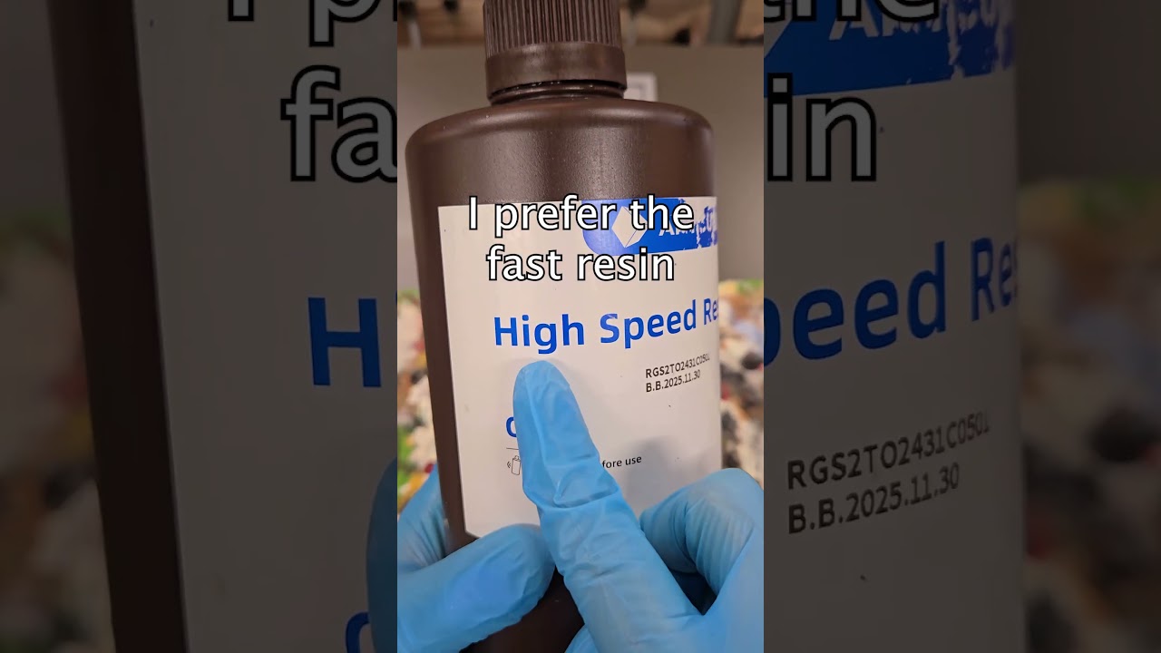

I’ve never done this, but UV resins are a cheapish and fairly effective solution - and a lot faster than solvent-based curing systems.

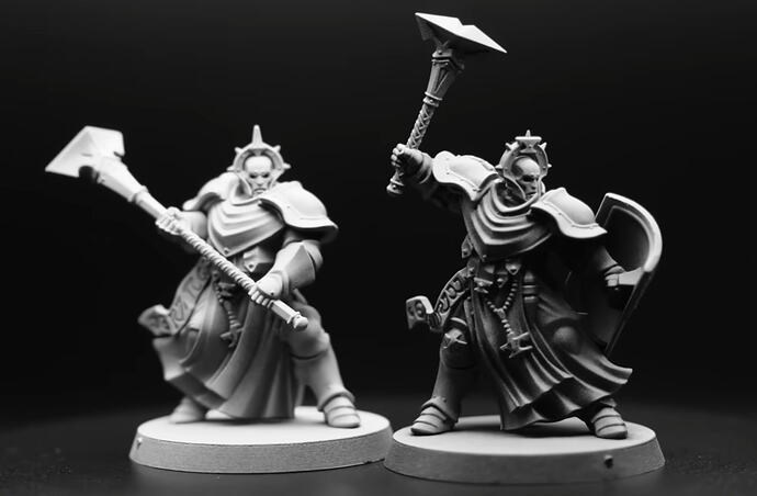

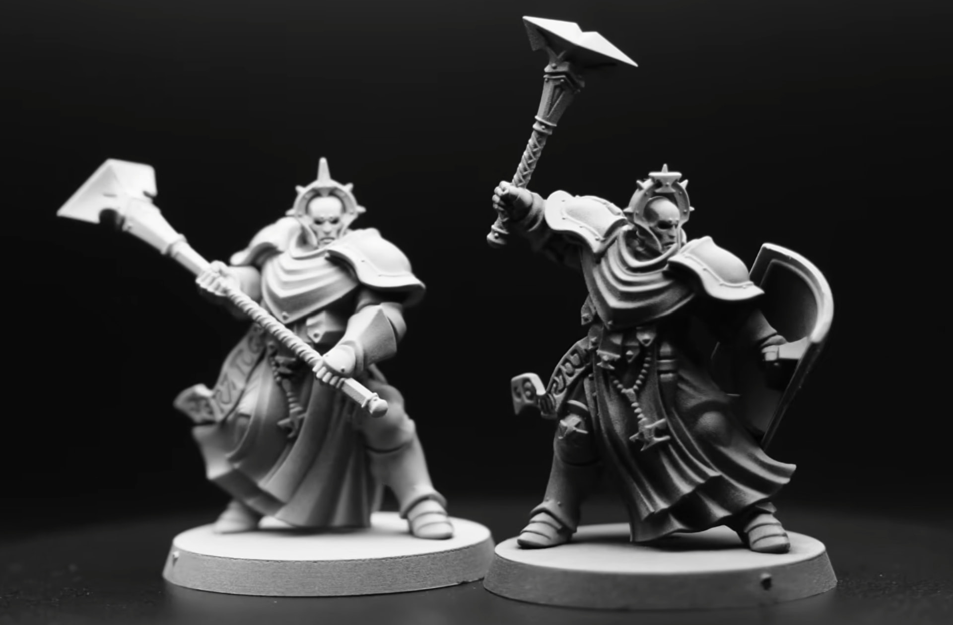

Just to avoid any misunderstandings:
  • Primer is the base coat and shading
  • For the paint, you use a different color and products, of course.
Pre-shading by primer in practice, photo by: The State of Play

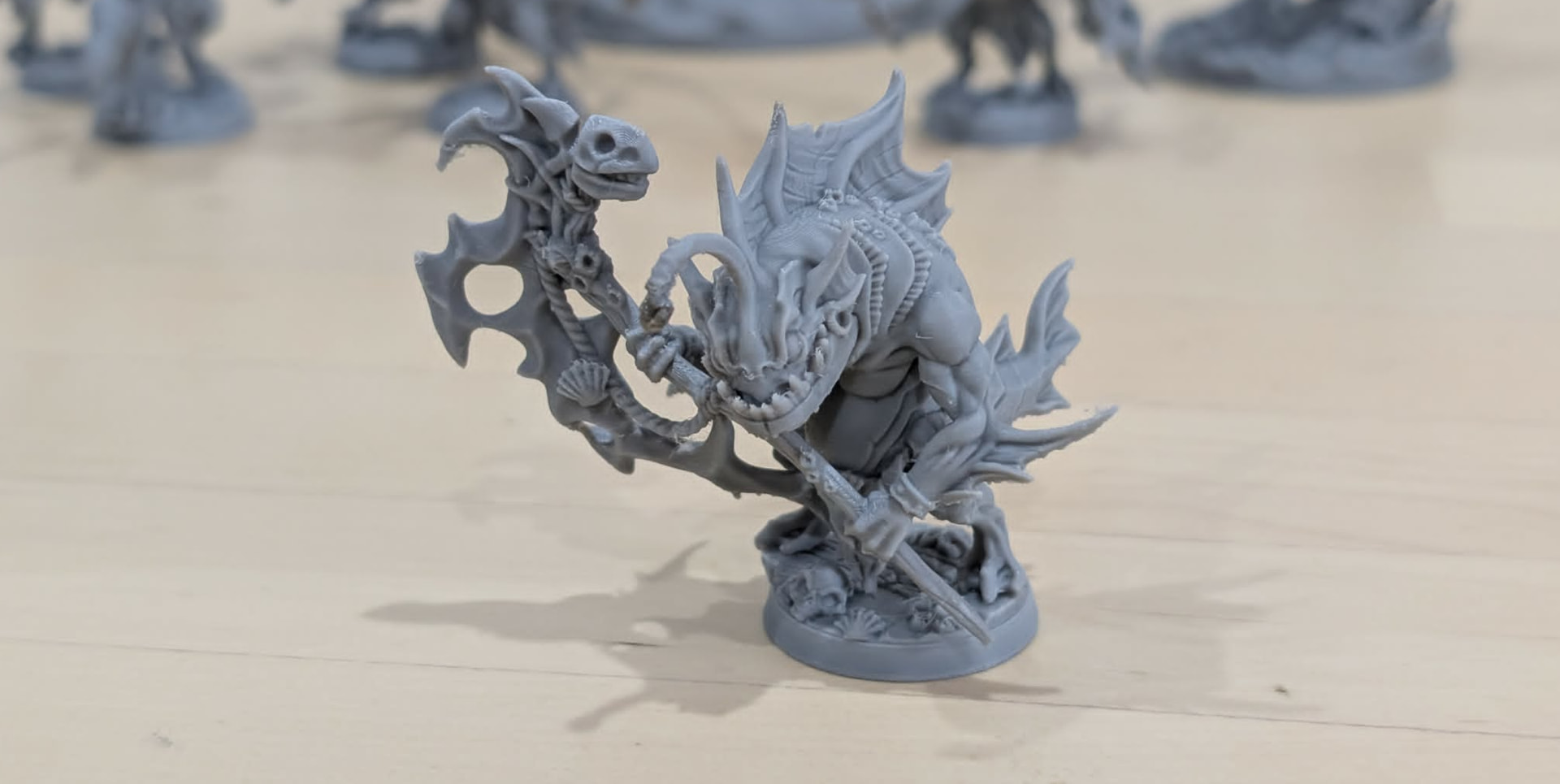

I’ve never seen a decent FDM miniature figure in tabletop gaming scale. Terrain yes. “Square box on wheels” tanks, yes. Figures, no. Would like see a photo of one.

I am not sure why you have provided a black and white photo of 2 sigmarines with zenithal highlighting applied (AKA “slap chop”), or what it’s supposed to represent? They are not PLA prints, and they are standing on injection moulded bases, so maybe not even prints. Then again the resolution and lighting is so bad, who can see anything?
If perhaps this photo relates to the difference between paint and primer, if you were to try to spray paint something like HDPE, e.g, the stuff portable toilets are made of, you would find your paint not sticking. So you would use a special primer that sticks to it, and then your paint would stick to the primer. But modern miniature painting base coat paints are designed to stick to HIPS, so we can base coat and prime in a single operation. Unless you have to paint PLA, which requires a textured primer like a spray putty to get rid of the layer lines.

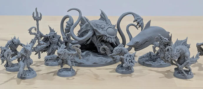

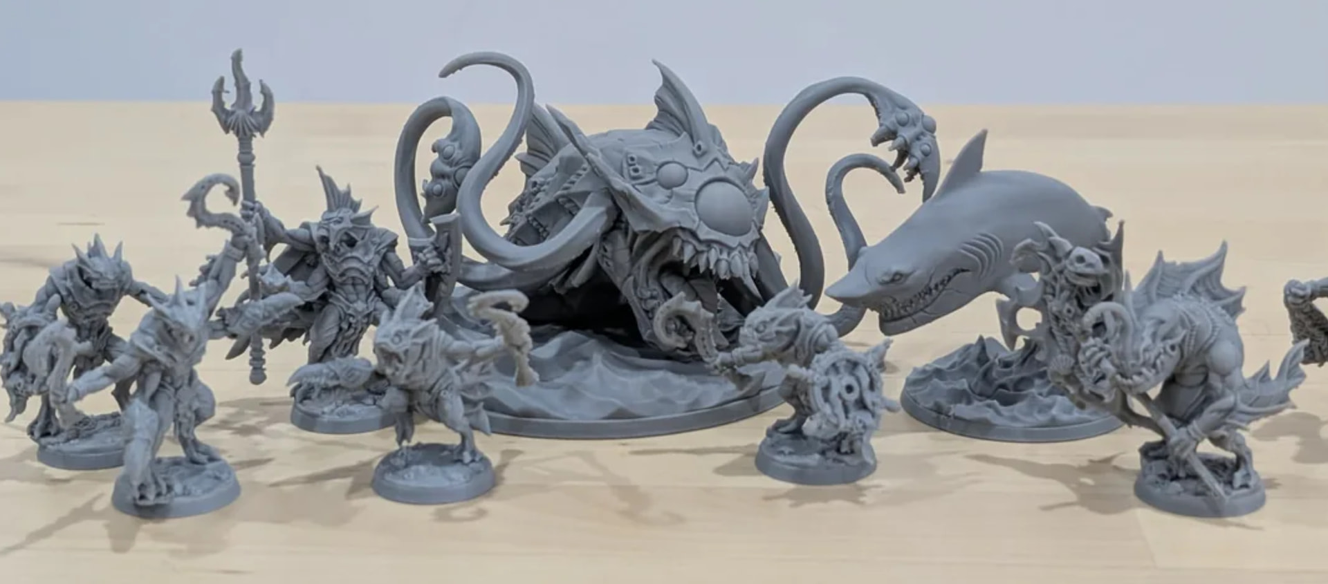

Bambu printer can get surprisingly close to resin-level quality. It just needs a lot of optimization. Of course, everyone has different expectations, and that’s totally fair. :grin: :+1:
Still, if you’re interested in the hobby, I’d really recommend checking out this subreddit. Not to convince you of anything, but if you’re interested. There are many projects there that might interest you. :grin: :+1:
D&D FDMminiatures - photo by Gongamate

re: me saying I have never seen a good FDM for a tabletop scale figure
They are better than the standard 0.4 nozzle print.
They are noticeably worse than SLA. So we disagree on the definition of good, or the baseline to which it is applied.
1st photo has obvious issues where the camera’s DOF (Depth of Field) allowed it to focus e.g. the skull staff and the model’s teeth. Body is out of focus (common problem with phone cameras). 2nd photo needs a better camera. The subreddit has some decent photography of painted figures, but layer lines very visible. They become much more noticeable after painting.
BTW what is the print time you are getting? I estimate 4 hours per figure at 0.08mm layers from 0.2mm nozzle. Usable for an RPG. Might be an issue for a wargame that needs 100+ models. Then again, maybe that’s OK given how long the things take to paint.
