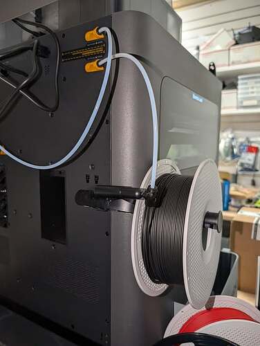

For fitting the TPU Feed assist on the left and the AMS switch on the back?. Also to give clearance for the radius of the PTFE tubes which will need room on the left and on the back. Height is for the AMS.
Another thing to remember is that the printer has an option to run an external spool which will take up a good chunk of space on the side as you need a spool with plus another spool width to removed it from the holder. The rear needs space for the spool option, a place for the poop to go and for fans to exhaust.
And also for safety. The printer vibrates a lot, and if you have it on a table of the exact size, there is a big fall risk.

My H2C is on a 24” deep counter top, it has about 5” clearance in the back, it works fine but I definitely wish I had more room.
