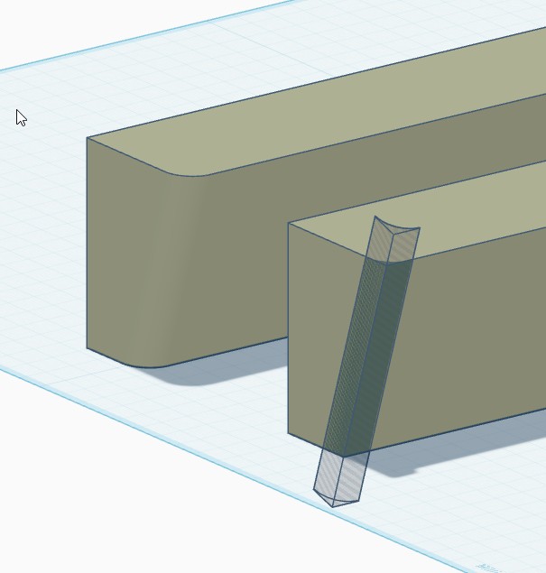

I can’t figure it out. I’ve created a bin to fit into a corner of a drawer. The drawer has side walls that are angled 18 degrees outward.
I have a cube and cut the corner walls exactly 18 degrees. I created a rounded corner “hole” and have it angled exactly 18 degree. But if you see this photo you will notice it doesn’t line up?
I’ve tried this multiple times. There must be something I don’t realize about how to go about this.
I may have missed what you are aiming for, if you are hoping the cylinder leans into that corner…
It only looks like it is leaning left, did you also tell it to lean backwards?
Thanks Malc. The cylinder to round the corner is leaning 18 degrees into that corner in the same way as the block. Here’s some photos to show it’s 18 degrees in both the X and Y axis. But it isn’t lining up the same way for some reason.

It appears your block angle is actually 15.605 degrees.
UNBELIEVABLE!! Man, how did I do that so many times in a row! I was trying to learn the protractor method in Tinkercad but gave up and instead took the screengrabs where I didn’t notice the 18 vs 15.6.
15.6 was the original angle from the design I was copying. I was afraid there was some other step I wasn’t aware of, but in the end I’m just not that experienced and made a stupid mistake!
Thanks so much for finding that for me. You probably saved me hours of troubleshooting.

I may start from scratch and try the rounded edge version of the block (and cut that edge onto a non-rounded corner block). But after correcting the angle that u/blchandl2 pointed out, I’m still stumped with an issue. These “SHOULD” be all exactly 18 degrees, but it’s still not overlaying?!? Here’s screenshots with the ruler showing both options are at the ruler point. Also a shot showing the alignment. And just showing how it looks.

It appears like by rotating it 18 degrees in one direction, and then 18 degress in another direction, it creates an addition rotation somehow?
I thought this could be due to the pivot points for these rotations somehow causing an issue?
Also, I don’t perform both rotations at once (I’m not sure how to do that if it’s even possible), so I have to do them independently one after the other. Is there some unwanted effect from it being compounded?

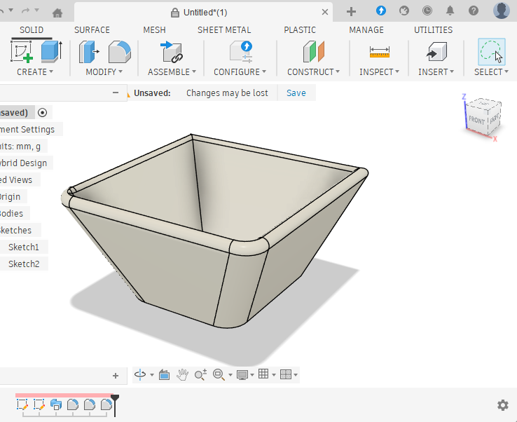

In Fusion, you would select specific edge(s) and/or face(s), press “F”, then specify a radius, or simply drag until the fillet looks right. It even works on curves. Much fewer steps than making a hole and a box and then fiddling around to adjust sizes and angles. If you change your mind later, you can edit the feature to change sizes, add/subtract edges, etc.
Fusion looks more complex, but is easier to use once you learn the basics.

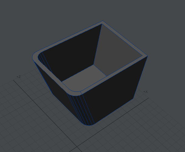

This took about 2 minutes to model in my CAD software. Which isn’t even actually CAD software, it’s CGI software. Admittedly, I’ve been using it for decades and know all the tricks. But all I used was a box primitive, which I hollowed out using CSG Subtract. Then I selected the edges I wanted rounded and picked the “Rounder” function from the menu and bam! done. :slight_smile:
If TinkerCAD makes it harder than that, then a different program is probably in order…

Is this what you want? I think you are rotating the fillet in X & Y which is causing the problem. I only rotated the fillet in one axis.
This is done in TinkerCad in about 5 minutes.

Fusion, 1 minute, 11secs, to add two interior fillets, two exterior fillets, and a complete top edge fillet. Would have been much quicker with keyboard commands instead of mousing into menus, but I was trying to make a GIF that turned out too large to upload.
The base model took less than a minute. A parallelogram sketch on the XZ plane, a rectangle sketch on XY, and a sweep of the first sketch around the rectangle.

I found one way to tilt the fillet in two axes, but I hope a real “tinkercadder” knows a more efficient way.
I did not take the time to make a box with tilted walls, so you are ahead of me there.
On the right, next to “Basic shapes”, use the magnifying glass to search for MetaFillet.
Drag the fillet into the model, select hole or solid, adjust height and radius.
Depending on the viewing angle, you should see one or two curved, two-headed arrows above the fillet.
Click an arrow, and then click the angle number above that.
Type and enter the exact desired angle.
If you only see one arrow, rotate the model with a right-click-drag to see the other.
That is as far as I went, and I’ll be stopping there. Playing with fillet movements, I discovered that the angle values are always measured from the current position, not the orthogonal workplanes. So if I were to tilt or rotate a shape by dragging, and dropped it at 15.7°, I have no (apparent) way to know that a 2.3° adjustment was needed. There are probably commands to make two shapes snap to each other, or to redefine the workplane, but I don’t want to invest the time in learning them.
