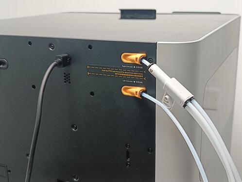

You can hook AMS units on either to the right or left nozzles.
You need a switch that doesn’t exist. Tell me how you would attach an AMS to each hotend?
Huh, I have an ams connected to each hotend. It’s no problem at all. Soon Bambu will release a switch so that both ams regardless of hotend connection will be able to switch sides to take a filament color. This way you no longer have to take a color out of the right ams to put it in the left ams.

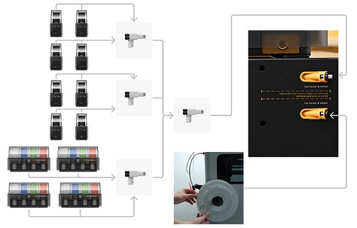

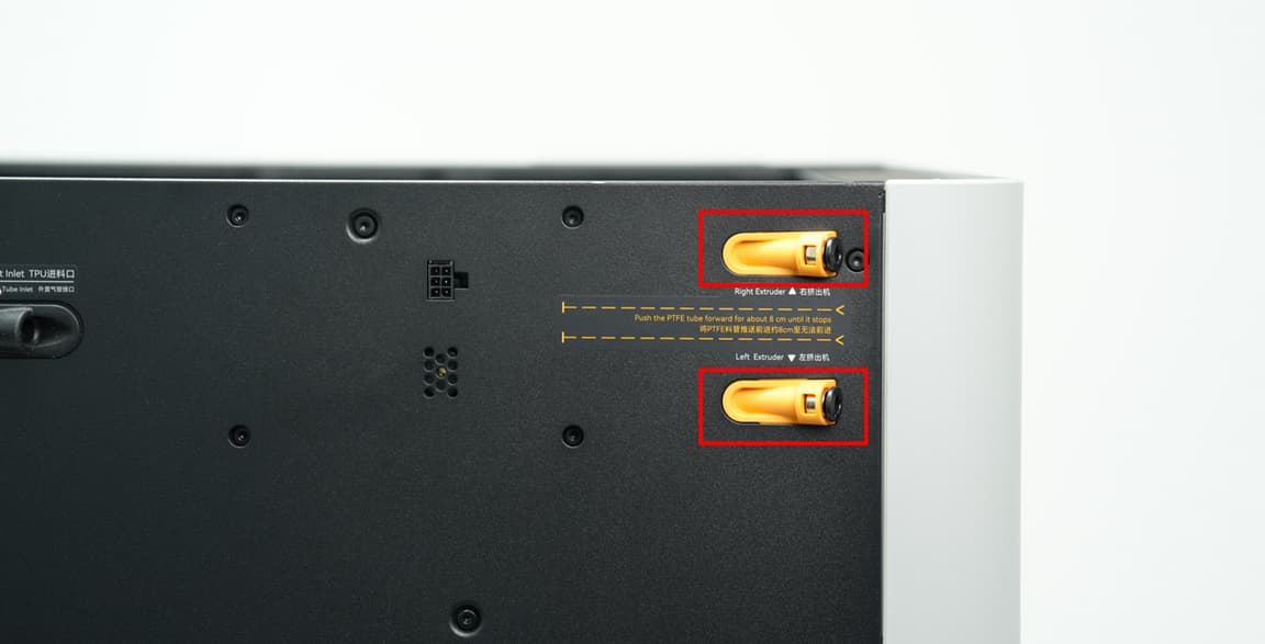

You can. The H2D has two ptfe inputs, one goes to each hotend. You can connect one, or multiple AMS up to each. If you do multiple you’ll need a splitter.
I have 2 AMS2 PRO and 2 AMS HT connected to each hotend with 4-in-1 connectors. But it would be nice to have all connected to the printer and a switch decides what filament goes to the left or right hotend. You would still need to have the two filaments in different AMS since there is only one outlet from the AMS.

It’s in the H2C FAQ:
Future Plan: A Filament Track Switch Module is expected to be launched in 2026. At that time, you only need to equip 2 AMS (excluding AMS Lite) to fully experience all functions of the Vortek system. It will also support free switching of filaments delivered by AMS between the feeding paths of the Hotend - Left and Hotend - Right, significantly reducing equipment configuration costs.
