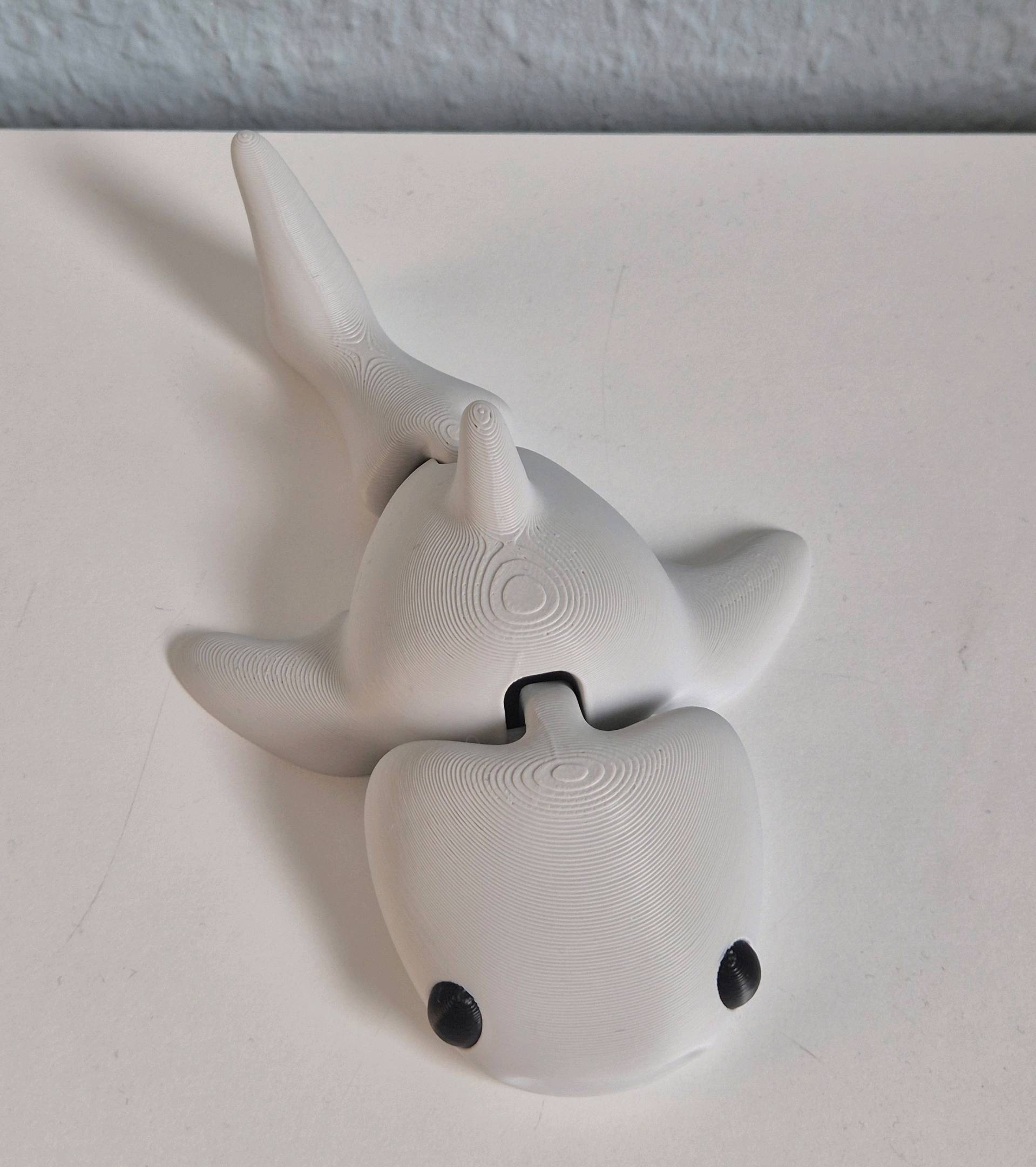

Why could this deformation around curved parts might be happening?
Could this be a filament issue or and issue with with nozzle/extrusion?

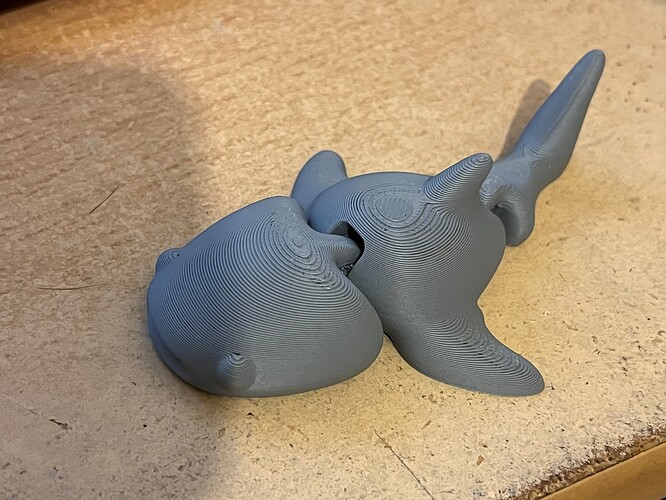

Im not positive what you mean by deformation. I do know this part would benefit greatly by lowering layer height or turning on variable layer height. The printer cant round off the edges of single layers, so the thicker the layer, the more blocky they are.

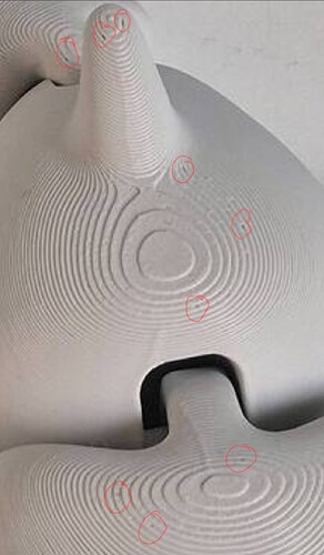

There are these tiny holes and very small deformations.
This looks like a much better print than mine for example it still has some of the same issues but to a much lesser degree.
You can try “filter out tiny gaps”. I believe this replaces gap infill for bambu slicer.
Also, as always, make sure its dry and set the correct flow rate.
Im almost positive the other guys print you posted above, has a lower layer height than yours.
Yours is exposing alot of “top layer”
It looks like his flow rate is near perfect, and he still has some tiny gaps.
Thank you very much. Yes those are what I meant. So you can solve those gaps by calibrating flow rate?
Its possible that they could be from extrusion. I just threw out the things I would try. I would first dry it thoroughly, then set flow rate and pa. Then I wiuld try a print. If still bad, try the other things.
If I wanted it as good as possible, I would set layer height to .08 or tyrn on variable layer height(sometimes this causes color gradients in the print)

And if you look at the actual lines, you can see the flow rate is off. Even if it doesnt help the holes, it will still make the part much nicer. Hopefully more people chime in on the holes. We have some very smart and helpful people here.

Bambu has a wiki page regarding this. It explains the problem and the solutions.
