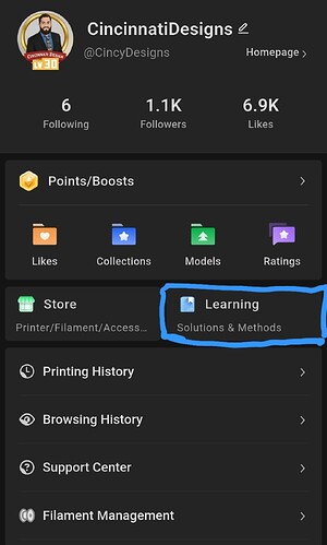

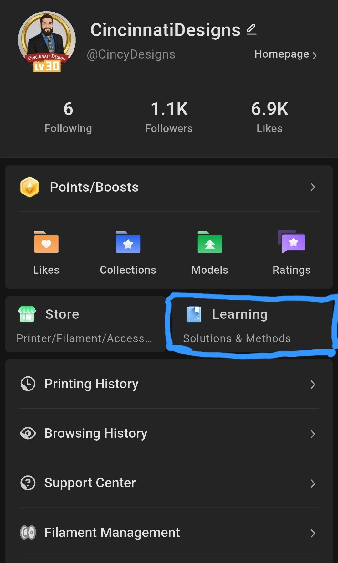

How do I 3d print things from maker world from my iPhone into Bambu studio I’ve tried searching things up and watching videos but I still don’t get it
Welcome to the community
First, to print from Handy, you will need a Bambu Labs printer and it needs to be connected to the internet.
Inside of handy…
Me > learning > software > handy
You can find pretty much all you need there
