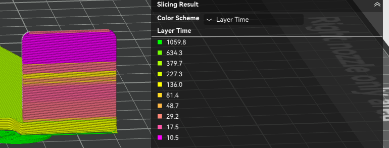

Why does a printing pause create such an obvious layer line?
It was printing fine but got a false positive for clumping detection.
I didn’t notice until maybe a half hour later, as I was busy with other things. It’s an H2D printer, two different colors of the same brand HF-PETG, a YOOPAI build plate heated to 70C before printing began and kept at that temperature during the pause. Chamber heater not activated. At the time the picture snapshot was taken (about an hour later,shown here, after the print was resumed), the print was still underway.
Once I inspected the situation and determined that there was no nozzle clumping going on, I resumed the print and it continued. The print did not lift from the bed. So, why would a pause create such an obvious print artifact?
Here’s my guess: even though the build plate remained heated, the hotend cooled during the pause, resulting in the temperature inside the chamber cooling, which in turn resulted in some amount of unwanted shrinkage, which caused the discontinuity to become visible when the print resumed. Therefore, I’m guessing that if I had been running with the chamber heater turned on, even to the minimum 40C required for it to operate at all, then maybe this would have been avoided.
As you know, layer time can be a huge influencer. Even during printing, a longer layer time due to extra infill, already shows layer lines
Normally the top most layer is not fully cooled to chamber temperature during an average layer time. The temperature of the part is transitioning to chamber temperature in the layers below.
Your 30m break basically made the entire part cool down, and probably the chamber temperature dropped even lower due to the missing heat coming from the hotend.
If you would have heated the chamber to 40C, the effect would probably be less, but I don’t think you would really get rid of it. For a visual layer line, there is not much difference required.
I don’t think that a 30min interruption in any print can be resumed without a visual artifact.
Have you measured the deviation? It seems huge, judging from the image. Though the top lighting in the H2D always seems to highlight layer lines.
It’s off by about 0.4mm at it’s maxima, which is toward the center of the walls. By that I mean, it kinda bowed inward toward the center of the walls. So…what I now think happened is that during the print interruption, the sparse infill at the top was most directly exposed to the relatively cool air of the chamber (around 35Cish), and even though it was gyroid, it began to shrink, pulling inward on the walls of the interrupted print, and the walls would have been least able to resist toward their center.
If I take that as the etiology of what happened, then I agree with your conclusion: probably no way to avoid it. Chamber heating might have reduced it a bit, but that’s still well below print temperature. Maybe 100% solid infill might have helped some. Probably much thicker walls would have helped. It had just two 0.42mm walls (inner and outer). Reacting a lot faster would have helped.

It does seem like a more fundamental problem than just the OP circumstances. Differences in layer times during normal printing are visible:
especially when it’s a large difference one right next to the other. What are the workarounds for that?
no good universal workarounds unfortunately.
slowing down the overall printing is the only way to make it slightly more uniform as the cooldown process is following Newton’s law of cooling.
if the overall process takes longer to cool, then the temperature would be more uniform between each layer.
