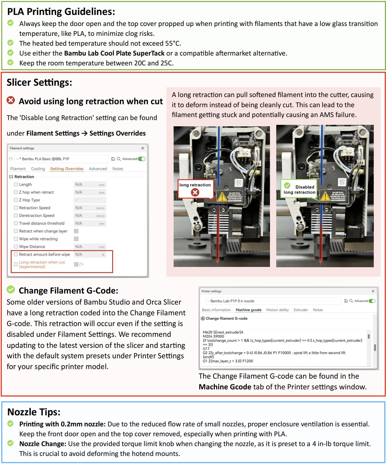

I have a Microiswiss Flow Tech harden hotend that requires Long retraction when cut toggled OFF but, with every new print, these settings always goes back to the default toggled ON. (See attached BBS and MS slicer settings)
What am I doing wrong when saving custom presets?

The checkboxes on the left, the ones the arrows are pointing to, enable or disable overriding the setting. The setting itself, what value to use for the override, is on the right side. Once those are checked, then un-check the green checkbox (or edit the distance value). It should then remember the custom settings once saved.
However I’m not sure why those left-side boxes would continue to show up as being checked if you saved the profile again after unchecking them (even if that wasn’t the the desired action). That seems odd.
