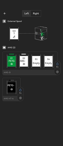

Why does my AMS HT only lower humidity to 20%
But my AMS 2 pro goes down to Luke 4%…what results are you guys getting?
Well how dry do you want it?
I think mind have been lower than 20 but I wouldn’t swear to it.
20 is fine btw
Yeah you are probably right I’m just wondering why my normal ams gets it down to like 5% and so does my Amazon generic brand (50c max) but the ams ht struggles to go below 20%
Betting it’s the hygrometer, mine is the same way. My Pro’s get down to 10 or less. For me, the hygrometer is just a guide or barometer as to what’s going on.
Technically you should weigh the filament to get an accurate measurement. Admittingly, I have never weighed my filament. I just set my drier to X hours at the recommended temp and when the hygrometer stops dropping I call it good. Been working just fine for me since I’m not shooting for the perfect print or selling them.
It’s simply because AMS HT is outright TERRIBLE at air sealing.
And you’re lucky that yours can get down to 20%. Most of us would need to add tons of desiccants to suppress it under 20%. For like a week or so.
I use my AMS HT to recharge desiccant packets. It has been as low as 4% and will hold it for many days if I let it sit.
So it’s possible they will hold the dry air in. I’m thinking of tearing mine down to see if there’s anything the jumps out causing it to leak so quickly. I use mine strictly for drying, and it would be nice to have it dry my filament and keep it dry.

Where do you live? A very dry area will do that, a UK user for example might see higher humidity increase. It also depends on where your AMSs are located, in a heated room humidity might not increase, in a non heated workshop, it may (mine stabilize around 16/17% in my workshop, AMS, AMS2 or AMS-Ht, my workshop is at 16ºC currently and it’s raining outside).
It’s so common and well known that HT has poor sealing. I personally have 4 HTs, bought from different batches, and they all have humidity climbing up super quick after desiccant swaps. I also help in a print farm & reseller shop, guess what we don’t even bother to use HT anymore because it’s so ■■■■. Managing the extra dessicant swaps is just not worth it for the extra labour.
I’ll help. I live on the east coast. I also live in a basement apartment. Humidity, esp during the winter, is high.
Now PLA isn’t so bad. That reading is with ASA CF inside. The HT I use on the mini currently reads 33% and hasn’t dried anything in over a month but is opened and closed regularly.
