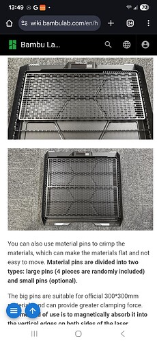

I’ve opened a few tickets arguing with them about why none of the accessories for the laser have been released. I’ve really been unable to engrave any of the aluminum business cards that I purchased because I can’t get them to hold still just sitting on the slats.

Did you try the magnetic material pins to hold the cards?
I’m confused, is it the air assist that’s causing the cards to move or something? If you put the slats close together I’m not sure how things would move. If it is air assist, have you tried turning that off for the cards?

Do what we CNC enthusiasts do — use double-sided tape to secure your workpiece to the bed. I’ve engraved numerous bottle openers this way without any issues.

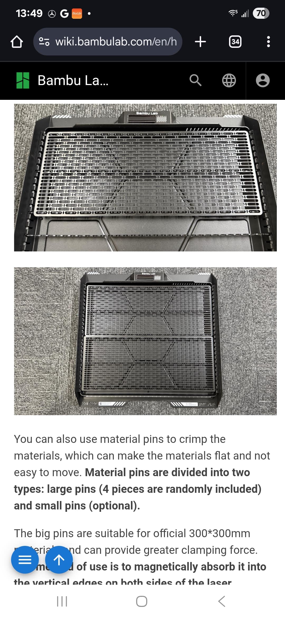

The 1st and 2nd picture of your first screenshot shows how you can use the provided pins to hold down things like the business cards with the slats alone. I also would like the wider plates but they aren’t available yet and I’m not going to let that get in the way of my projects.
I hope they release them soon (including the rotary tool!), but if you have projects that need to get done, you gotta work with what is available :person_shrugging:t2:
You are supposed to make your jigs for a lot of laser machines. Slabs or magnets won’t help either for the aluminium cards. Simply print a jig and the jig can be attached magnetically and your cards won’t move.

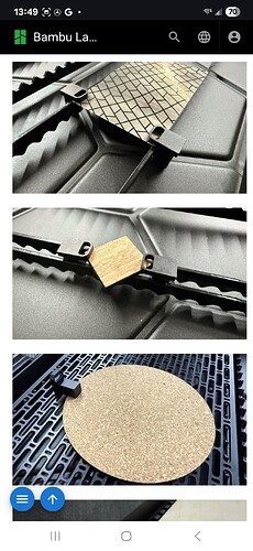

That’s an alternative clamp in those pictures that doesn’t come as standard with the laser combo.
Those clamps are shorter than the ones provided and are designed to magnetically attach to the laser bed not the sides.
The wiki gives really good info on this but I’m also frustrated the flat grills and those clamps are still not available for purchase.
