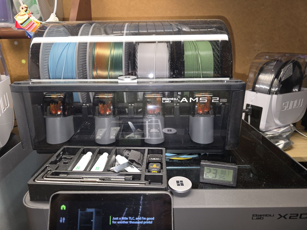

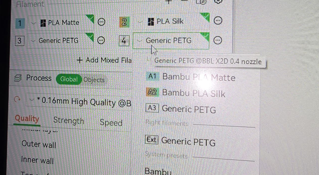

Why is Bambu studio too stupid from session to session, from one project to the next to know and maintain my filaments in the AMS 2 on my X2C? In my project I chose slot 4 (Green PETG) and come out to find it printing from slot 3 (White PETG) snd it’s forgotten slot 4 is loaded.

As to the PETG being forgotten, it looks like non-Bambu spools. Is it Bambu filament where there are RFID tags in the mix or are you manually setting color & type?
If you have Bambu RFID tags handy, you can tape them to the sides of a spool and the AMS should treat them like Bambu spools. My AMS (1) doesn’t forget Bambu spools or keep trying to measure/ID them on startup if I use Bambu RFID tags on other spools.
I believe there are threads here about Studio “forgetting” non-Bambu spools but not sure what the resolution may be. What I do know is using Bambu RFID tags on 3rd party filament works great — as long as the other filament prints well using Bambu settings or you don’t mind adjusting parameters.

Thanks for sharing. Being new to all of this I had thought about doing the same with The RFID tags. I have been using Inslogic’s PETG Pri using Bambu settings and it’s worked great but would love for it to load up and automatically default to the settings. Already threw a bunch of the tags away but now going to save as you have shared success story. Appreciated.
Glad to help! Some caveats, though…
I had a spool of 3rd party cyan in my AMS and tagged it with white PLA since it was PLA but I didn’t have a cyan Bambu tag for its real color. Then during a print I had the white run out. The AMS saw there was another “white” PLA spool and happily swapped that in when I missed the spool running out. If you don’t have the appropriate color tag, may want to use one you don’t use much.
But it works great. Most annoying to me is any non-tagged spools get checked for remaining filament. It was on a cardboard spool and that just frays the edges. It stops that, knows how much filament is left, and if the color matches, you get good updates to the filaments that don’t require fixing the colors.

My PC went to sleep, when I woke it I imported the next part into the same project. I chose the 4th spool set a custom color to it, sliced and chose it then sent it to the printer, came back later and it’s on the third spool which luckily was PETG.
