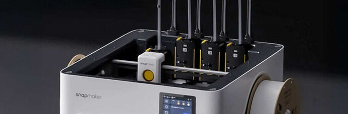

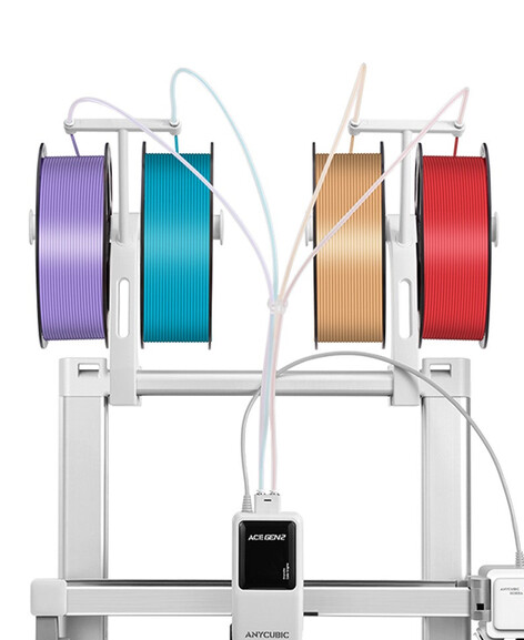

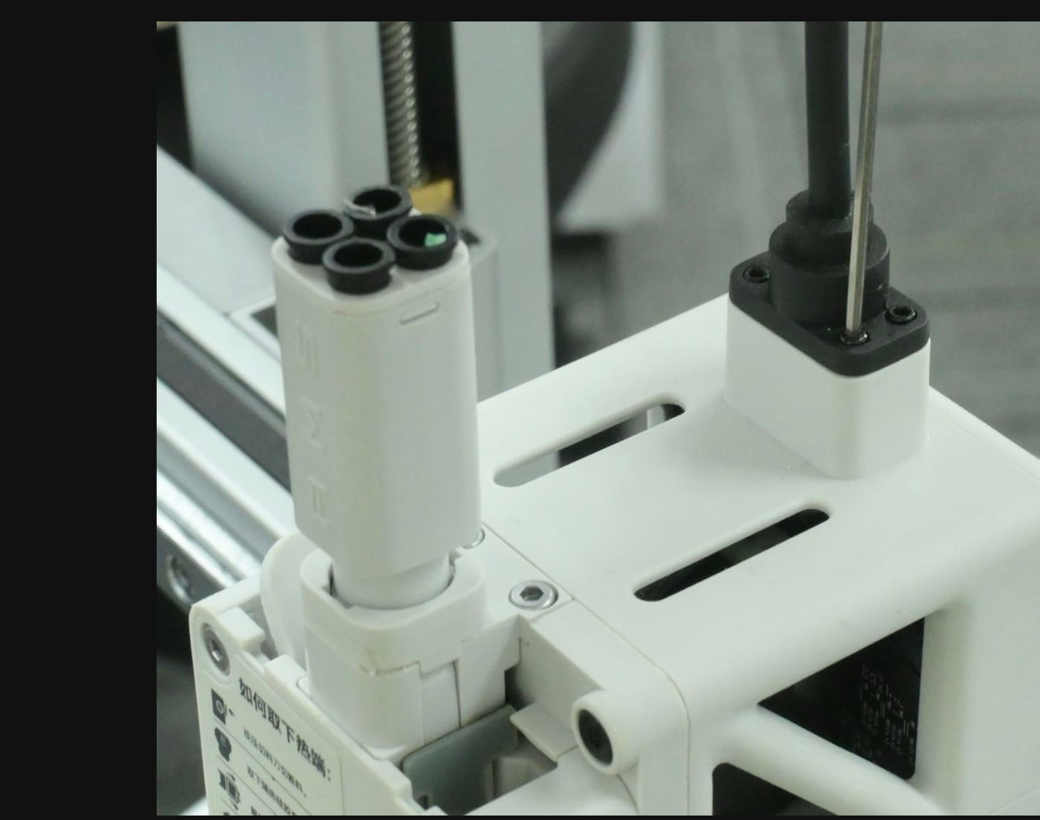

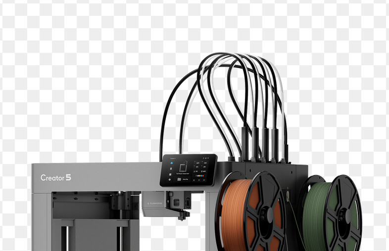

Yep. Like this
or this
or this
or even this, from their own product line
The cynical will say it’s to sell you more dongles :wink: And you still wont even be happy cuz it does not solve speed problems.
Check out how the kobra x does it - the toolhead basically has the hub portion of the AMS built into it. It holds all 4 filaments, dispenses the correct one when needed, and thus only has to move filament 1cm instead of 1 meter. They also optimized for the cutter to be as low as possible so that waste [time AND material] is minimized for a single-nozzle printer.
