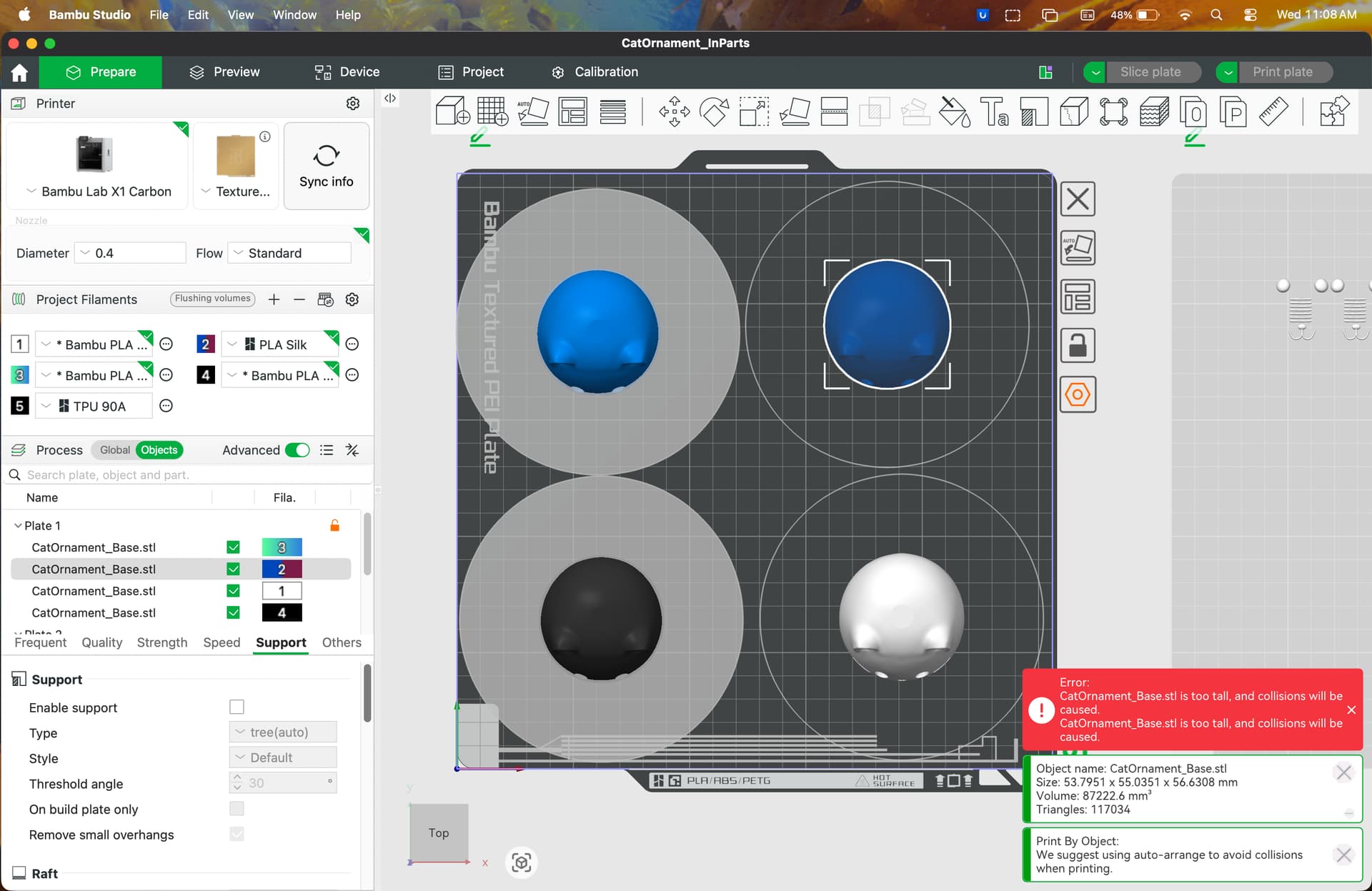

Hiya and good day to all. Why am I getting the error pictured? It seems to do it when I clone an object. When there’s just one object, I do not get the error.
Using an X1C, printing by object, stock settings, nothing fancy.

Misc → Change “Print by object” to “Print by layer”

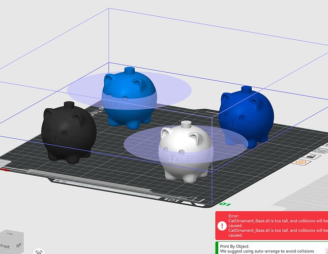

Those items are too tall to print so many by object. The slicer is accounting for the size of the gantry and printhead, and would collide.
Thanks Bullocks. I forgot about the gantry and was just thinking about the print head. (If you can’t tell I’m new to this.)
