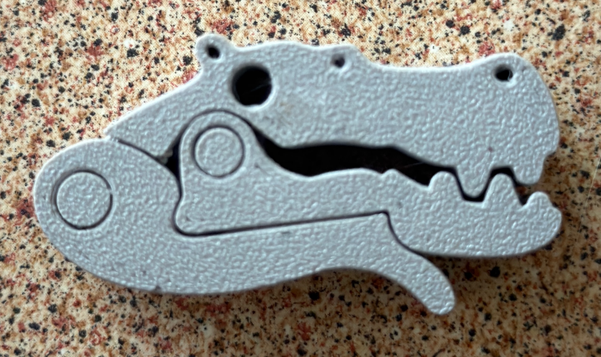

I printed one of these neat little bag clips, in PETG if it matters, and it came out really well. Moves perfectly, no binding at all, no force needed to get it to initilly open.
I then printed a set of 6. Cloned them in the slicer, didn’t make any other change at all.
Every single one of the next set won’t open. It’s hard to tell, but I think it’s that the lever (the bottom section) is fused to the bottom of the jaw. I’ve even tried using a bit of force to get them to initially open but no luck, the lever will break before it opens.
So, I printed another single one. It worked perfectly again.
Can anyone tell me why a single one would print perfectly,but multiples of the same object fail this way? It has me stumped.
There are many factors, the most likely would be this, at least to me.
Tolerances in the model are likely very tight, when you clone the model, they now span more of the build plate, with 6 chosen, none will be in the exact centre, heat distribution isn’t as perfect as you might imagine and thus could change how the molten filament cools.
Essentially, portions of the bottom layers have fused together as they were not perfectly cooled instantly.
The increased print time per layer also plays a factor in the cooling. You could try print by object if you initiate use Bambu Studio.
Changes in temperature can affect prints in this way as well. You indicate you have a H2 series printer which by design has venting, so it is likely you had the door closed, so this is less likely a factor.
Build plate maintenance could play a roll, far too few know they need cleaning, far fewer do it correctly. Given 6 failed, it is unlikely to be a factor as that likelihood is very limited to have come on all over those places at the same time.
As an experiment, you may wish to try a test print with five, one in each corner and one dead centre. Remove them one at a time to see which if any work. You need to use Bambu Studio for this.
Make sure the door is closed.

That makes sense and I think you’re spot on.
After I posted I started another print with just 2 copies. These did both work but weren’t quite as easy to initially open as when I printed just the one. Hence, I think exactly what you said came into play, but with only 2 and not 6 it didn’t quite cause enough of a problem to stop them functioning.

I would have gone with “layer time”.
The print shrinks as it cools. If you’re only printing one, the shrinkage from one layer to the next is minimal. When you print many, layer time goes way up, shrinkage increases.
The same effect causes a bulge on an outer wall, that’s aligned with the top surface inside the wall. “Benchy Hull Line” issue.
If the model has very tight tolerances, and the layer-to-layer misalignment increases, things will get stuck together.

I would also say it is due to layer time, but not because of cooling but because of speed: a single item will be printed really slow to maintain minimum layer time and therefore very precise. multiple copies will print faster and if flow dynamics is not perfect, the seam might be bulging and fuse to the next part.
To test this: slice a single part and in preview, select speed view. find out, which speed is used for the outer walls.
In preparation, set the same speed for outer walls and see if multiple copies work now.
