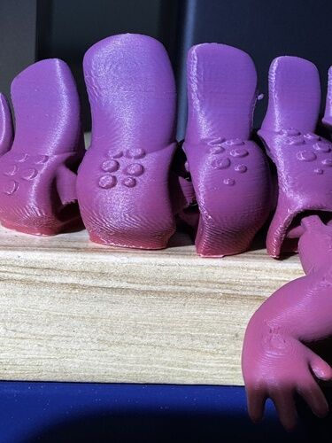

Im getting so wierd lines on my print. Ive tried many thing. Different speed and fans setting.

I still trying to figure out as i creat this topic. Ill try more setting. Ill keep here posted…
Actualy trying to change ptfe and ditch the drying box see if any restrictions would be created.
Do i have to adjust anything on the extruder ?
I do not have an A-series printer but the defects remind me of filament where the flow calibration is off.
It may be something else entirely of course in which case it is usually a good idea to run through the recommended maintenance.
Isnt this wet filament? :rofl:
Seems to me that no one acknowledges printers might have issues so filament is the only bad thing out there
It may be. But since OP is printing from a drying box…
thnks for answer guys , yes the filament is in a dry box 15% humidity …
from what i tested , just changing the layer height but keeping the same speed as .2mm but for .12mm introduce these wierd shapes
lets say i print something at .20mm adverage speed 150mm ish … the result will be clean , but if i keep all the same and change layer height to .12 or .1 , these wierd shape happears…
