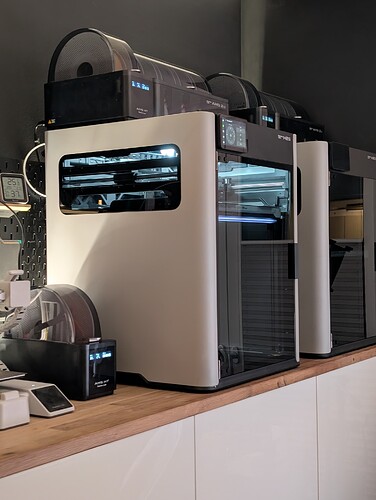

Will H2D side panels fit an H2S?
Will H2D side panels with the windows fit the H2S?
I used Bambu’s AI search engine and it said “yes”.
Considering both machines are based on the same platform it’s probably a safe bet but thought I’d ask before placing the order.
I like the idea of being able to see the print from the sides plus it will be more visually appealing.
Anything else to consider? Thanks

anybody ever did this? i like the windows
I installed H2C panels on my H2S. So I guess it will also work with H2D panels. I did not try to wire up the lighting of the logos.

Only changed the visible side and also avoided wiring up the LEDs.

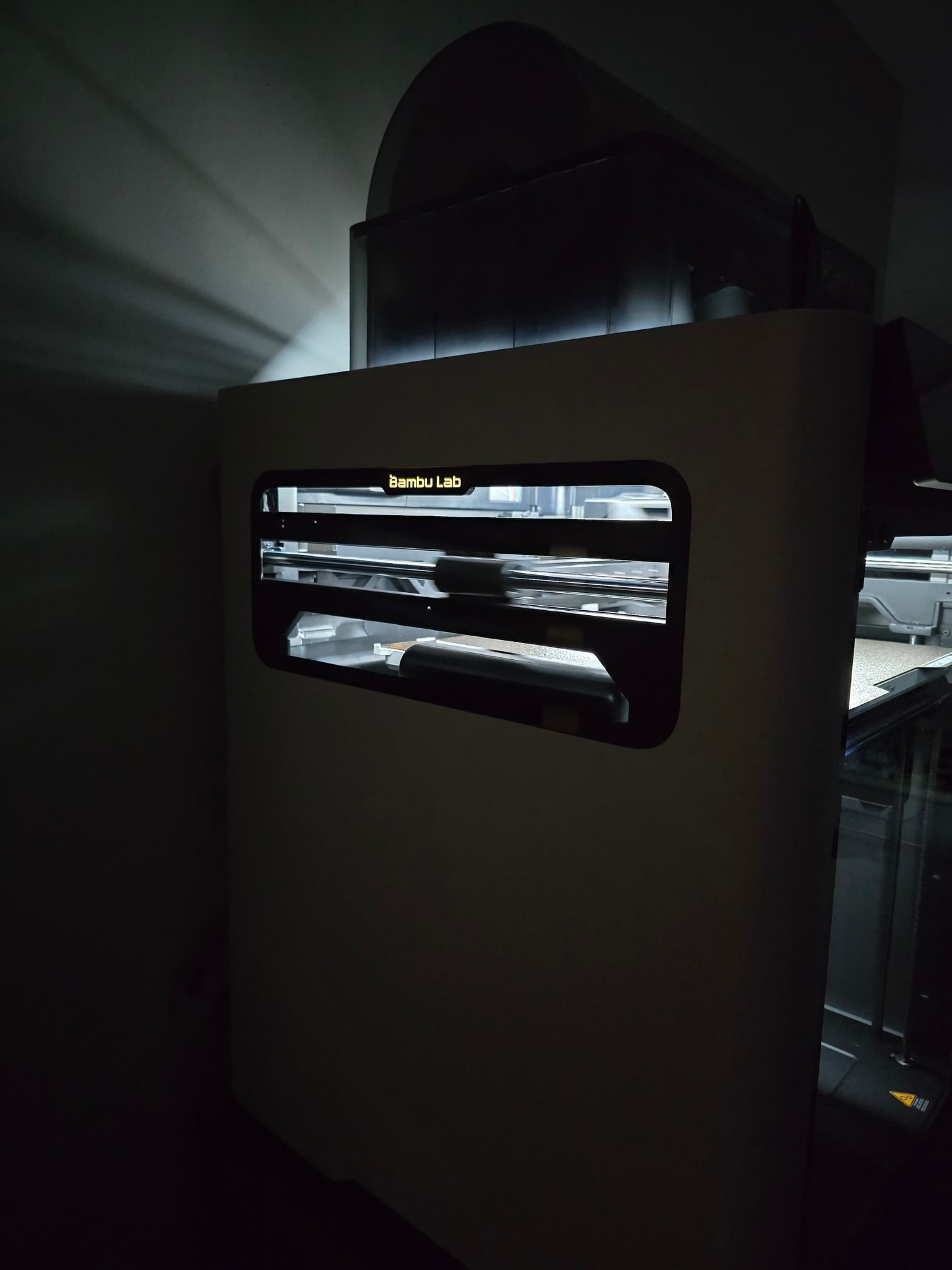

I just installed side panels from H2D into H2S. Any ideas where to get led’s to lit up “Bambu Lab” logo?
Nevermind, these are just light deflectors it seems, not actual LED’s :smiley:.

It wasn’t hard at all. I have followed BambuLab wiki tutorial.
Just make sure you put the screws in correct places on the rear panel, half of them are for metal thread and others for plastic.
I also managed to make light deflectors from old LCD panel so now the Bambu Lab logo is lit :grinning_face:

I had no plans either, even regretted purchase of H2D panels… but after fitting them and turning on the printer for the first time after change, I just love it!
