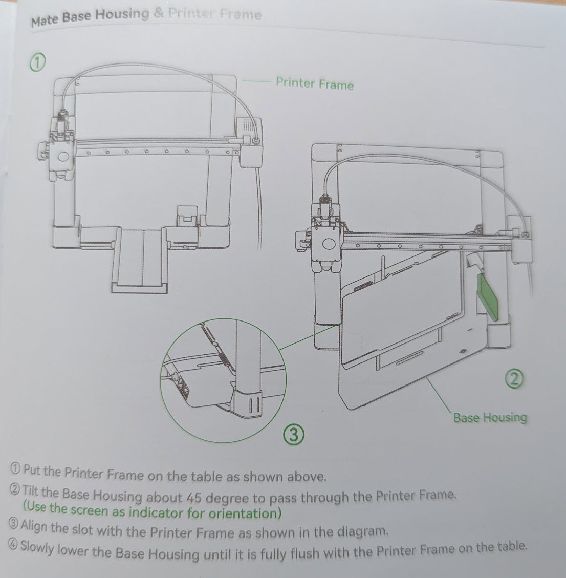

During the assembly of my A1, I ran into 3 problems which, from what I’ve seen on Youtube, are regularly experienced by first time users of the device.

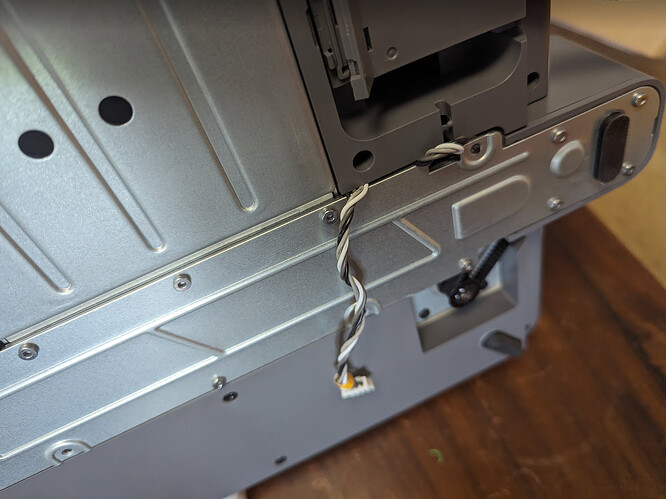

-First, I snagged the Z data cable when assembling the bed and the top part of the printer. Since I didn’t notice, I proceeded to screw the 10 screws and found out later that it had slightly damaged the cable housings. I took everything apart and then take axtra care on second assembly.
This should be stressed out in the booklet.

Well, given the assembly method described, it wouldn’t make much difference if I had better glasses… You just don’t see what’s going on down there.
A warning about the dangling Z cable harness wouldn’t hurt.
