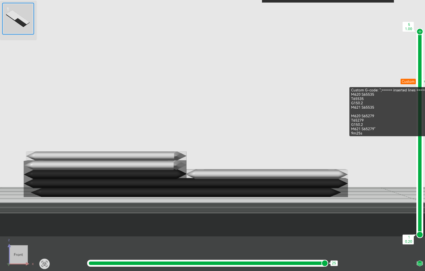

- layer 1 and 2: only material 1
- layer 3: both
- layer 4: only material 1
- layer 5: only material 2
in Bambu Studio: add custom G-code for layer 4 (executed at the beginning of layer 4 / end of layer 3)

Result
- Bambu Studio Preview showed the wrong color for layer 4
- but the print turned out as intended!
- after layer 3 the AMS pulled back the filament
- layer 4 was printed in black
- for layer 5 the filament from the AMS was reloaded
