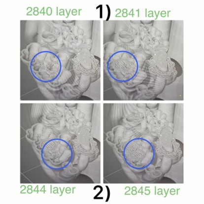

I have problems with support generation on some models. As for example, the support tree for fingers have wrong geometry, support interface prints in air in some places and inside the tree diameter. It cause spaghetti. It is the main problem that fail the model. Also, the model starts printing right inside the interface layer lines.
Changing styles, switching off reduce infill retraction, drawing supports manually do not help. Seems like Bambu studio generate it wrongly.
Here is photo collage of places, what I am talking about and where is the problem.
4 cases altogether, on the left side photos, there are supports trees without support interface layer, on the right side, photos of the first WRONG support interface layer.
I have also circled the problematic places.

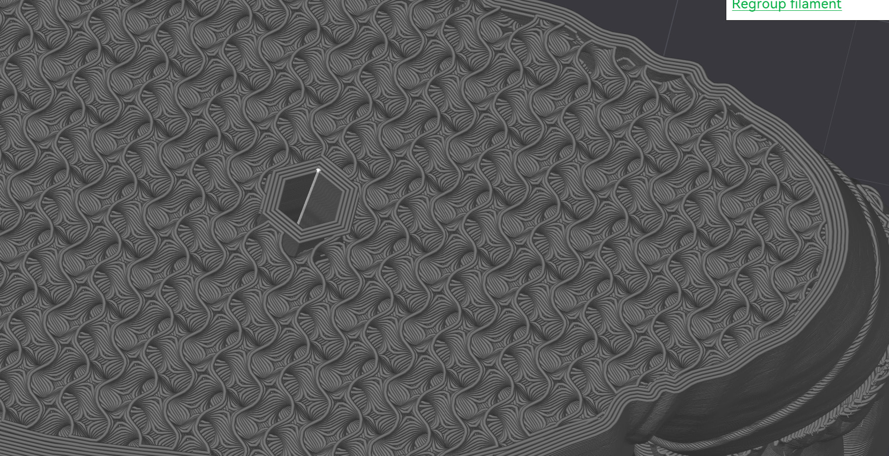

Well then, let’s dive into the analysis:
Okay, we would probably need the original 3MF file. The slicing/G-code output is completely messed up. There’s not much to analyze there.

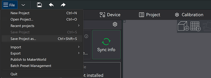

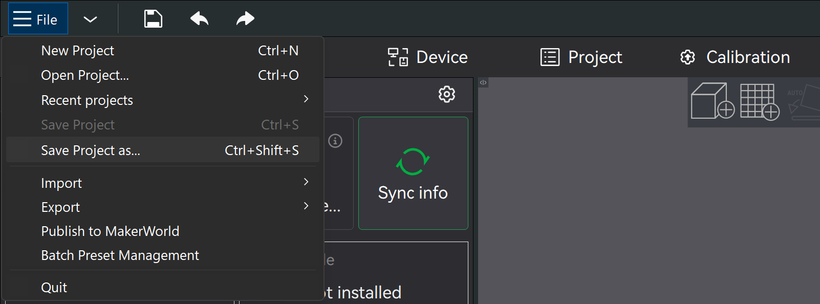

So, just the ordinary 3MF, without slicing. Your file on google drive is 3MF-G-Gode. That’s why I can’t see what happened before. Use just “Save Project”.
New link with file:

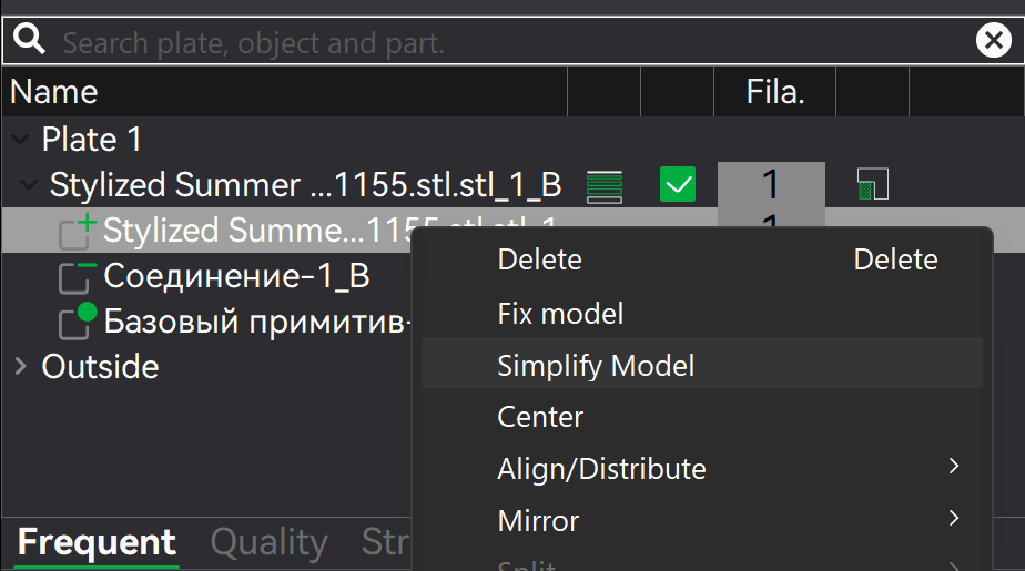

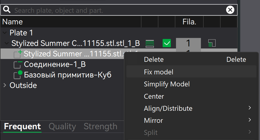

Well, I can’t tell you why this happens, I’m experiencing the same error. But here’s how to fix it:

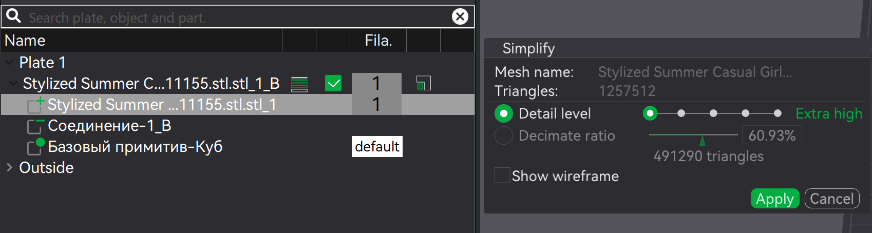

First, simplify your model a little bit - it has so many details that the printer can’t print it at all. It just confuses the slicer: After that, the problem was fixed for me.
If you’re still having this problem, click on “Fix Model.”
I have done all of these things and I still have the same problem with generation…
Even after rotation
