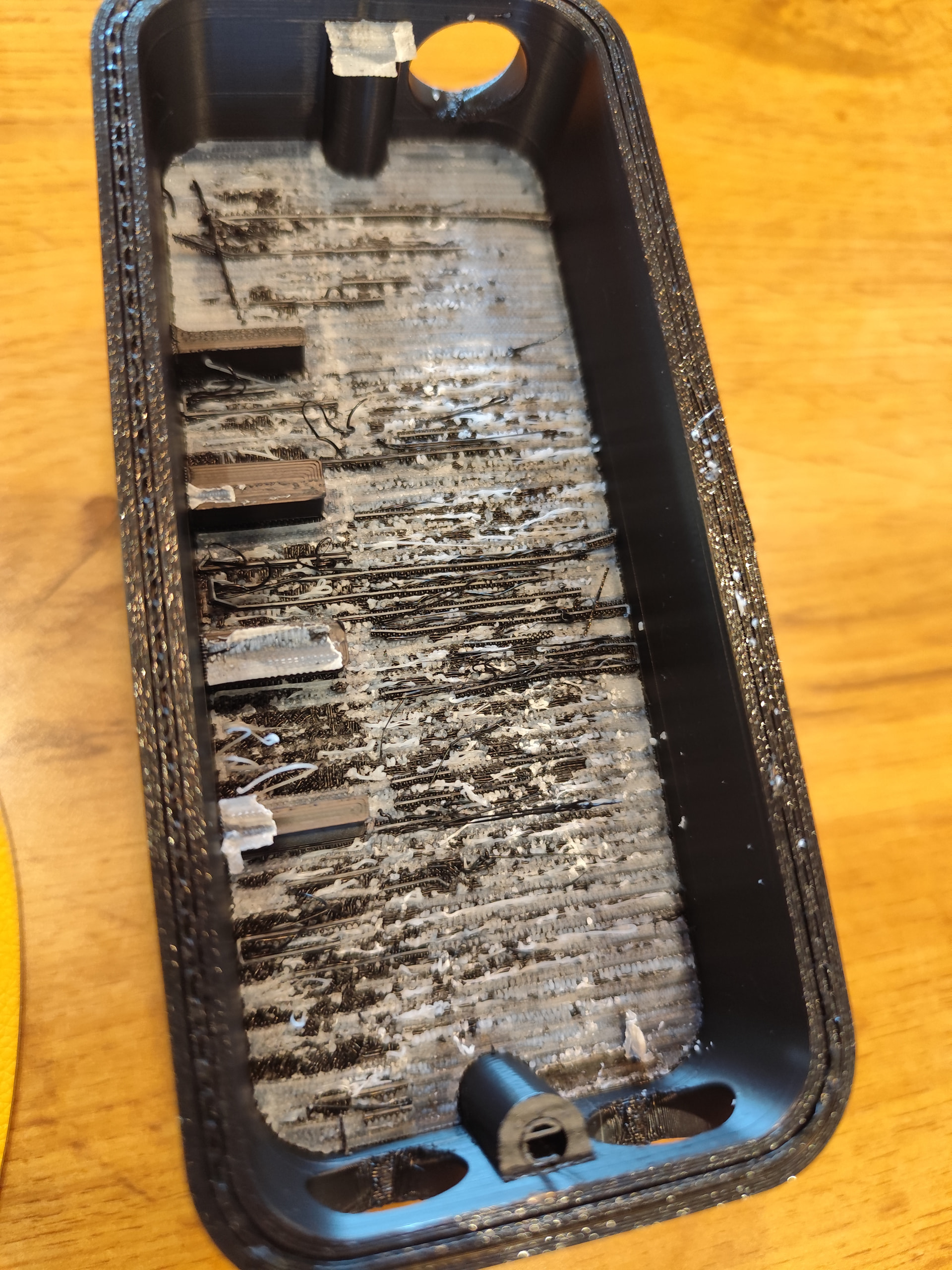

WTF happened here?
As the title suggests…wtf happened
here to my print?! This was an ASA print with
HIPS interface layers (ironed). The interface failed spectacular…don’t know why. Did this print some days ago and it worked fine…
I would guess the HIPS got extremely fast wet although i kept it in a drybox.
Whats your opinion guys???

Sorry, i hasted because of frustration. I’m not on my pc yet so just a quick explanation. The side you see is facing the plate, the inner section was filled with the support structure. Only the struggled interface is left. I will post the files when i’m back on pc.

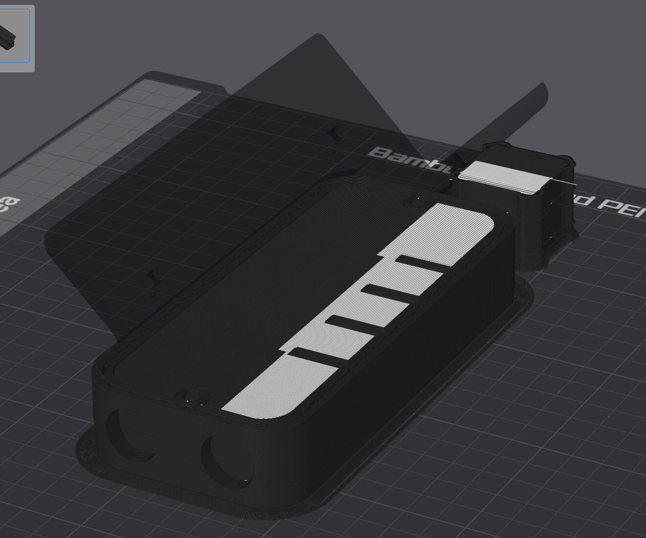

It would be very helpful to see your print preview at the topmost interface layer. I’m not sure why, but it looks like the HIPS was applied in very narrow strips rather than being a completely smooth, consistent layer between the support and the part.
It also looks like you only have one interface layer turned on; I always use two at minimum, and often three layers.
Sry for the late reply…so here are the files. 2 Things i recognized, first interface Layer is only on one half of the object. Dont know why.

Interface layers were set on 2.

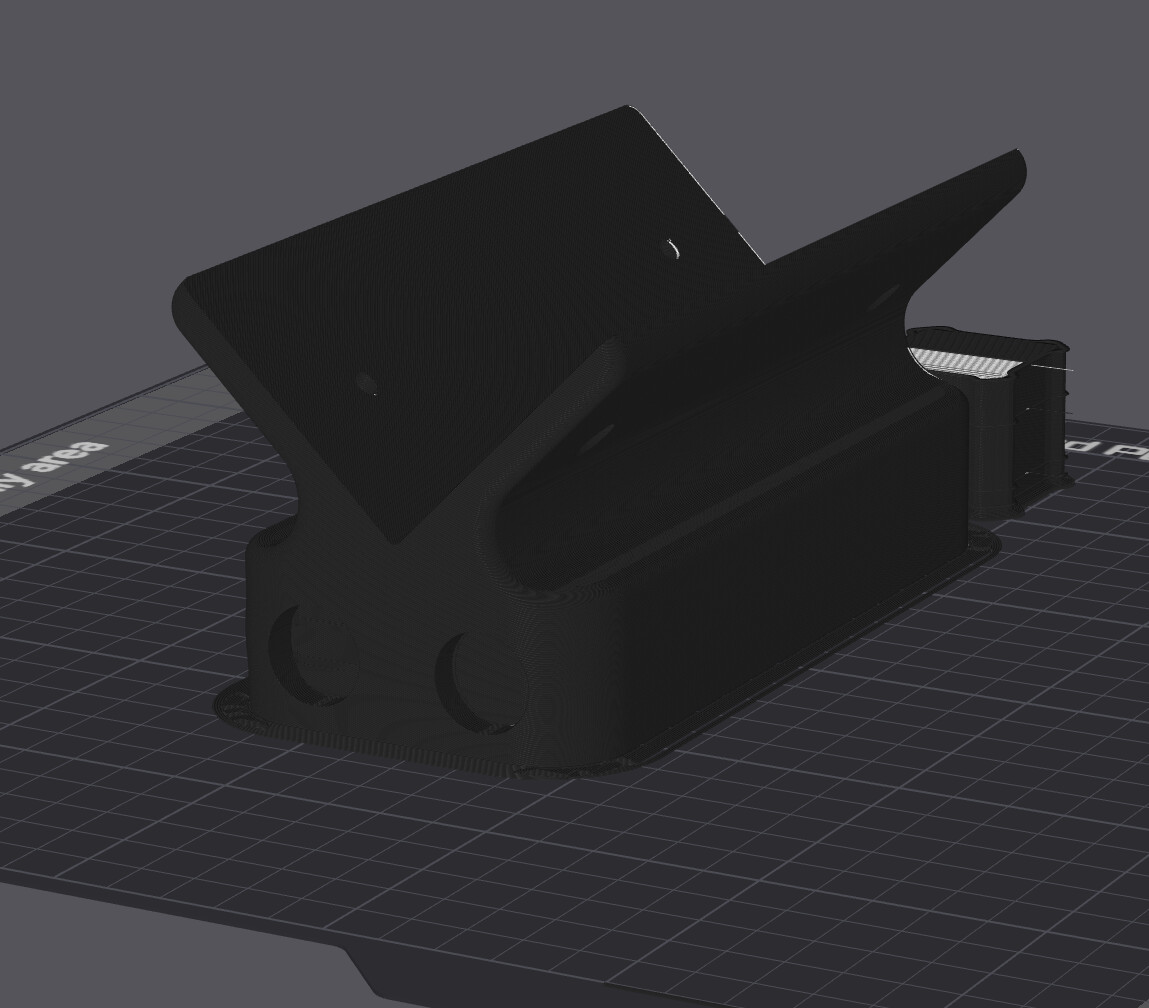

You could try to import the STEP file with a larger angular and distance tolerance.
This greatly reduces the number of facets and therefore the file size, and slicing speed.
Additionally, you can trim off the top in the slicer with the cut command, and delete that part, further reducing file size.

Am i misunderstanding the issue ? or does it just need a good post processing ? (clean up) as most of it just looks like an interface that has not released

No the supportmaterial interconnected there with the next ASA layer…it won´t let me remove it.
I will try D-Limonen to erase it.

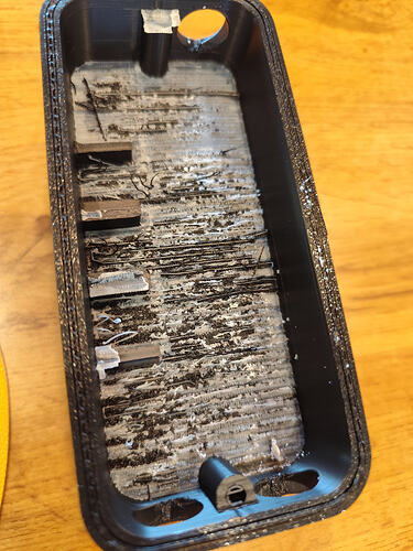

Your weird behavior of the support interface is caused by a weird bottom geometry of the large pocket.
It is not flat as expected, and there even seem to be fillets in between the different angled faces.
Did you design the part yourself, or did you download it somewhere?
I could try to fix the STL, but when you could supply the STEP file, it will be lot easier to fix that geometry.

It seems to be flat on the Build Plate. but after reorienting it on the same face again the result is correct.
So it seems like a slight misalignement.
Forget my quality issue. I guess that was the rough faceting resolution.
