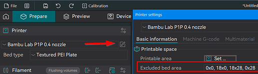

I would like to pause a print, add some flat headed metal posts (fasteners) then continue the print. This could cause collisions with the printer tool head. Is there a way to create an X and Y axis Exclusion Zone for this print? I have been able to find a setting like this yet. I thought about designing a “negative cylinder area” or barrier in the model at the positions of the posts that rises above the paused layer and serves as a guide to prevent printing in that area, but it wouldn’t block out tool head pathing for traveling when not extruding.
The TL;DR answer is: No.
The detailed answer is that there is a setting to exclude areas where the nozzle cannot move, but this applies universally to all prints within the printer definition. It is intended to confine the nozzle to the build plate rather than to create a checkered “no-fly zone” pattern. I suppose one could add areas of exclusion and save them under different profiles, but I don’t believe the software was designed to accommodate such “patchwork” geometric boundaries, so experimentation may be necessary. Perhaps someone from this community can offer another suggestion. Here’s where that setting can be found.

Thanks, this is great information to have. Your suggestion to pause the print to insert magnets and other flat items is a great one, I also frequently use it. In this case where a post is not flat, it will extend above the current tool pathing plane and provide an obstacle for possible collisions so I am reluctant to do so.
OK. Now that I have that visual reference, I can better understand the challenge.
