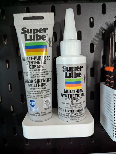

what do you use for the lubrication of the y- and x-axis?
Of course, the short answer is always the BL lubricant oil. But for real, it’s way too expensive regarding the fact that we have standard recirculating ball bearings for the x-axis and plain bearings for the y-axis…
I found some older threads in the forum, sometimes talking about WD40 dry PTFE spray for other BL printers. Has somebody tested this with the H2D? Or another lubricant?
I’ve always use Super Lube oil and grease (grease for Z screws), never used the Bambu ones that came with the printer because these work perfectly

For the lead screws and linear rods of the H2D they advise the following:
When to lubricate
It is recommended to check and lubricate the lead screws every three months. You can use the BX-300/F series grease in the link, but other lubrication alternatives can be used.
A popular lubricant is Super Lube 92003 Silicone Lubricating Grease with PTFE or Lucas Oil 10533 White Lithium Grease which should work similarly.

For one thing Grease is recommended NOT Oil!
lead screws = grease
rails the tool head travel on and rods = oil

I use the 21030 variant which seems to work fine as well.
