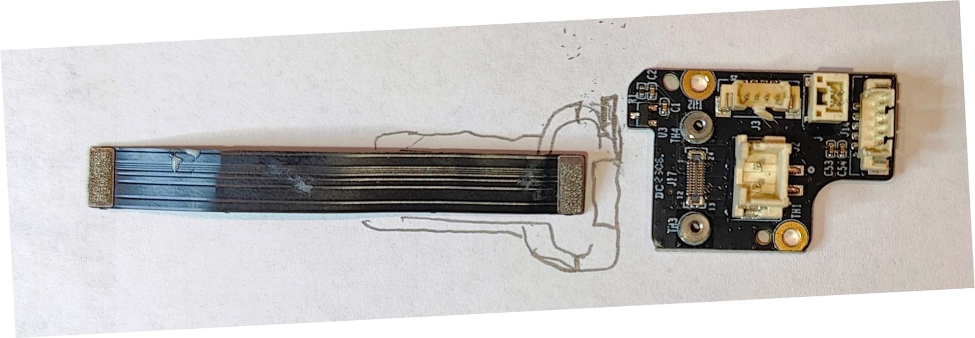

What I did not understand at the time was how challenging it would be for me to reconnect the ribbon cable coming from the Tool Head back side to the front Tool Head board. It is a female connector which has just the smallest orientation ridges.

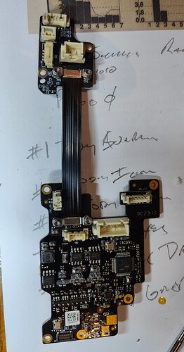

  1. I must have had the female ribbon connector misaligned at the beginning and shorted out both Tool Head boards, possibly the USB-C cable and the AP board (the one beside the camera).
  2. I found that I needed to assemble the Tool Head boards and ribbon cable on the workbench, under lighted magnification. The front Tool Head board, top ribbon cable connector is the problem. What worked for me was to loosely fit the clamp then slide the connector into place. Carefully tighten each side while watching connector alignment. As the clamp brings the plug and socket together, you can feel the alignment ridges starting to engage. Yes, it is fiddly. Tighten it up and the whole assembly can now be mounted as the ribbon cable has open ended keeper fingers you can swerve the cable into. The repair parts all come with extra silicon glue to lock every into place.
  3. There are indicator LED lights on the back Tool Head board, the AP board and the MC board located inside, near the poop chute to help you confirm/troubleshoot. Check out the repair Wiki for the details. Bambu Lab Printer Indicator LED explanation | Bambu Lab Wiki
  4. The AP board is a special from BL Support as they need to bind it to your X1 once installed. I had a problem with errors on restart; couldn’t reacquire the QR code and subsequently rebind the machine to my account but BL support stayed with it and cleared it all overnight.

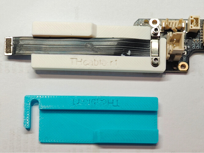

Thanks user_3026326371 for the tooling idea.
I was inspired to make this tool which seems to fit and work.

I was telling myself while fitting that cable that there must be an easier way.
It never occur to me to make a alignment/fixing tool. Maybe something like this?
You mentioned 1/2 holes for the posts. I’m thinking cable alignment sides and some sort of end stop. What do you reckon?

Should work but if you ever need one do it so you can slide it back to remove once the cable is installed.
The half holes allowed for that but there is other ways that work.

You inspired me to try… See my edit above
NOW we are talking !
I like it people find a solution through my gibberish but THAT !?
We would have used a very thing slider with a matching profile for the cable.
But then again, our connectors were even worse and thinner, literally just tiny balls poking out of a Kapton strip.
With you totally simplified approach the cable gets a really great alignment while the added bump stop ensures the connectors won’t get too far over or in front of the pins either.
Would love to get nagging now but could have done it easier or better myself I guess…
You should contact Bambu with this so they include it for those in need of this repair :wink:
Wouldn’t it be nice to see your model linked with a QR code or such when ordering those spares …
Ha! I’m sure that there are better ways to do it 🙂 but for me, sometimes good enough is good enough.
Even though I hope to never have to do this fix again, I decided to take the hour to design and print it out to see if I could.
It made me smile when it came together pretty quickly and it appears to work.
To your point, I did send a link to the BL support agent who was very helpful to me over the two weeks it took to fix it.
I also suggested that they might change the kit to have the cable installed as it is much easier to install that way.
Alternatively, I offered that they could use this one with my blessing or design it properly and include it in the box.
