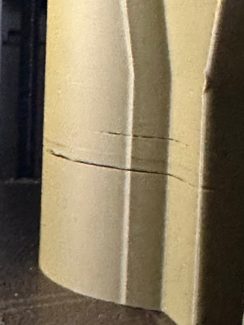

About two weeks ago for some reason unbeknownst to me, one of my X1C’s just drove itself into the bed and kept running. Gouged the heck out of the textured PEI plate and bent the nozzle. And just kept running like that. Fortunately I was at home and heard the awful noise and stopped it. By the time I stopped it, and it didn’t even want to stop when I hit stop I had to power it off, the nozzle had bent a solid 15-20 degrees. (not the first time I’ve seen this happen, but the first time it was that bad) I replaced the nozzle and it went back to printing normally. A week later, it suddenly starting printing anything over about an inch tall horribly. I can print flat items and items under an inch and they are flawless. Over an inch high, it goes to ■■■■. You reach in and grab the item to take it off the plate, yes after allowing it to cool, and it will literally just fall apart. It’s like it misses entire layers of print. And I have done all the maintenance. Calibrated it 100 times.

Here are some photos of the last fail. I watched it through the first 1.5 inches and all was well. About the time I stopped watching I guess it all went to pot again. I looked at it again at about 75% done and stopped it. Part of it had literally collapsed and fallen apart on itself while printing (the square part) The tube disintegrated when I removed it from the plate. I set it back together to show what it looked like for pictures. It makes no sense to me as it runs fine for over an inch before it goes to pot (I can’t say what I want to say given the filters here) and then it prints fine again after a brief complete failure. This is my oldest machine and has 3,235 hours on it. It’s never had an issue prior to this series of events.

At this point I have 6 machines and they have been running nonstop for the last couple weeks in the runup to Christmas. Of course it fails when I need it most. But I think I’m going to replace the extruder unit since I have one on hand. I don’t know what else could be causing the issue. I still print smaller items on it and it prints fine. It’s only when it gets up above about 1.5 inches that it happens.
So for those interested, I replaced the Extruder assembly and it appears that has resolved the issue. At least the last 4 prints over 6 inches tall have all printed properly. So perhaps something in the extruder gets bent when the machine loses it’s mind and crashes into the plate.

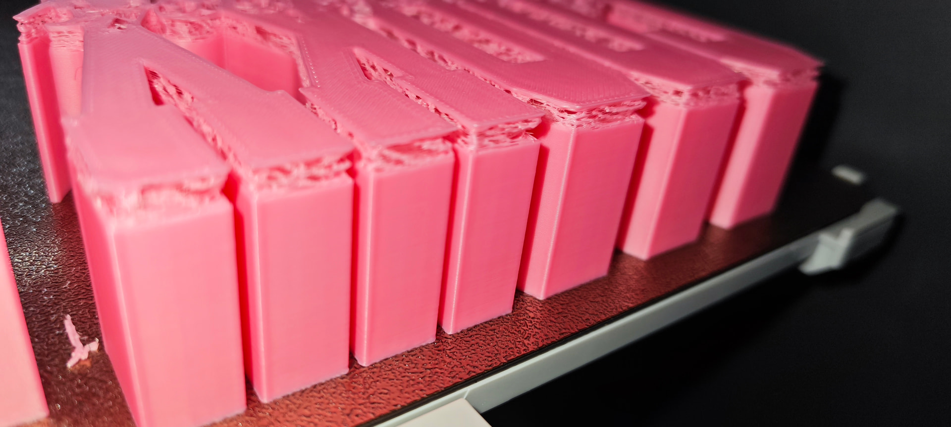

Hi! I’ve been having a problem for the past two days. At first, I was sure it was the AMS, but I’m not ruling anything out. Last Saturday, I had a clog (or so I thought), and for various reasons, I ended up replacing the extruder with a new one. Now my prints come out like this—no matter what file I use, they end up at different heights (not always the same ones). I say the most logical explanation is that it was a clog, but seeing that it’s still happening with the new extruder, I’m starting to think it’s the AMS that for some reason isn’t feeding properly or something. When I reloaded the file (after re-slicing it just in case), this time it appeared in the first few layers (at least it didn’t make me waste much filament), so what I did was set the filament to “external,” and so far it’s going well—it’s a 14-hour print, so I don’t know if that has any bearing on it. If it finishes fine as an external extruder and there’s no problem, I could say it’s 100% the AMS, but for now I’m not sure. Maybe someone can help me—I’m new to both 3D printing and this forum, so please forgive me if I’m not doing this right, but I’m a bit desperate. :smiling_face_with_tear:
