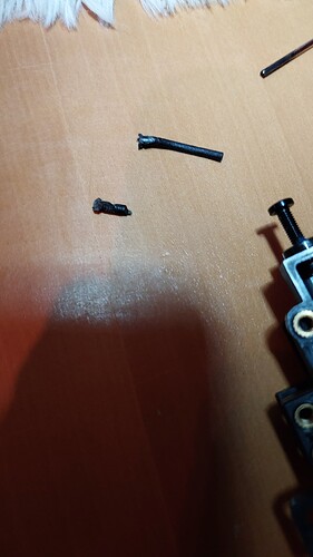

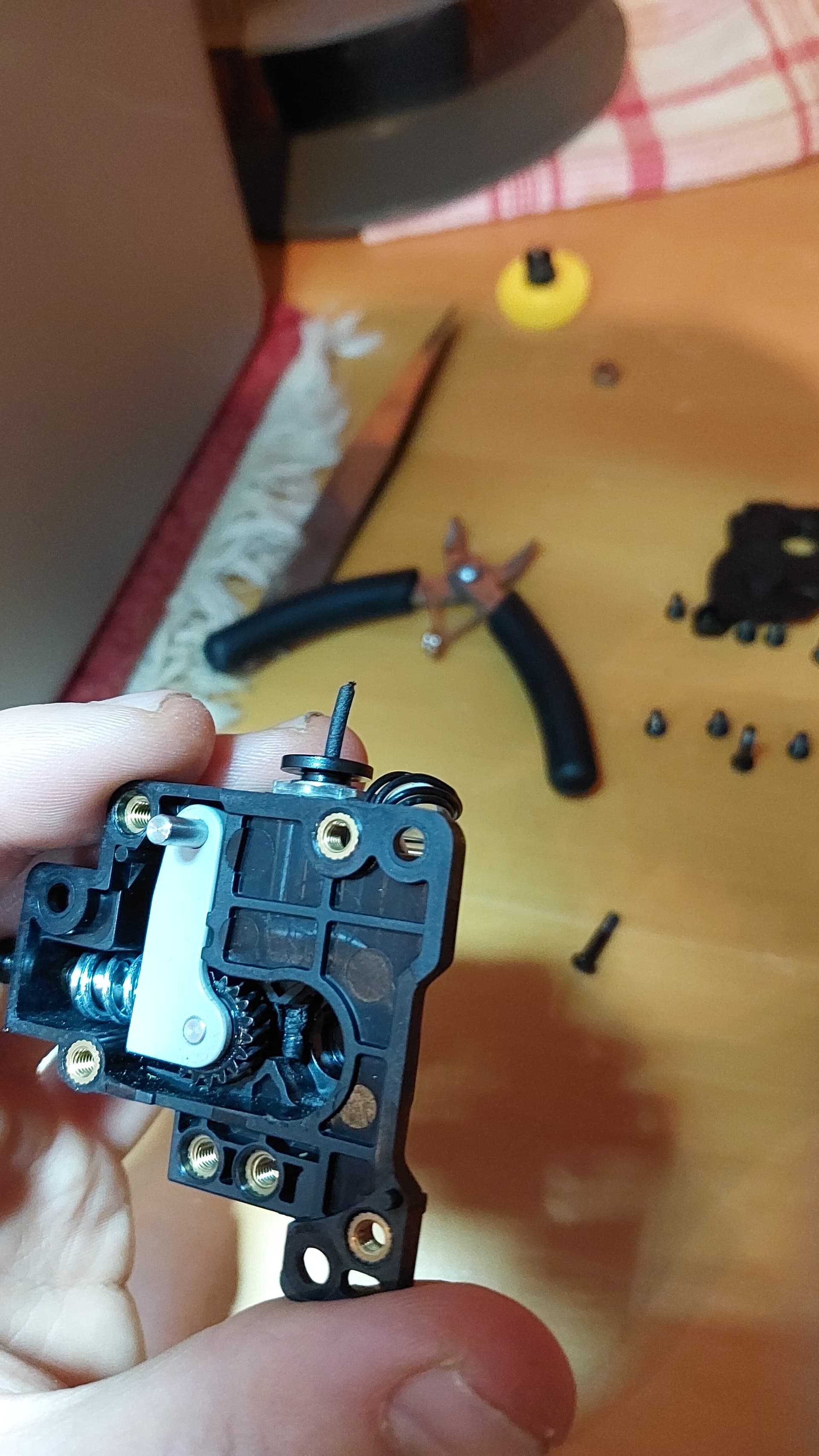

The printer is up and running again.
I had to disassemble the extruder to unclog it. Images attached
