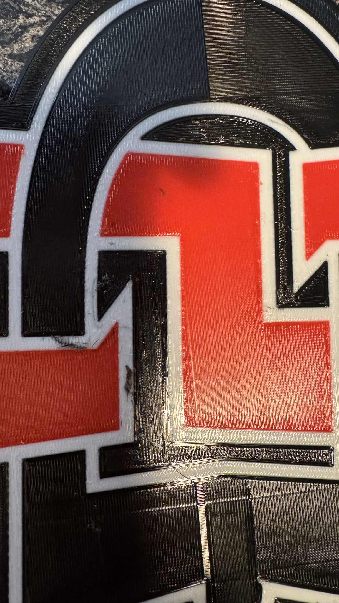

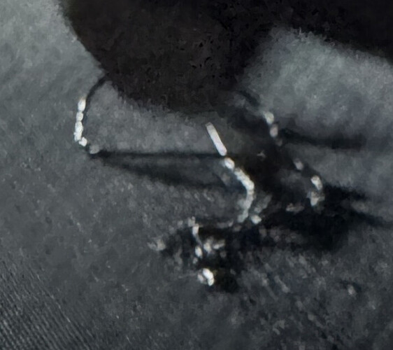

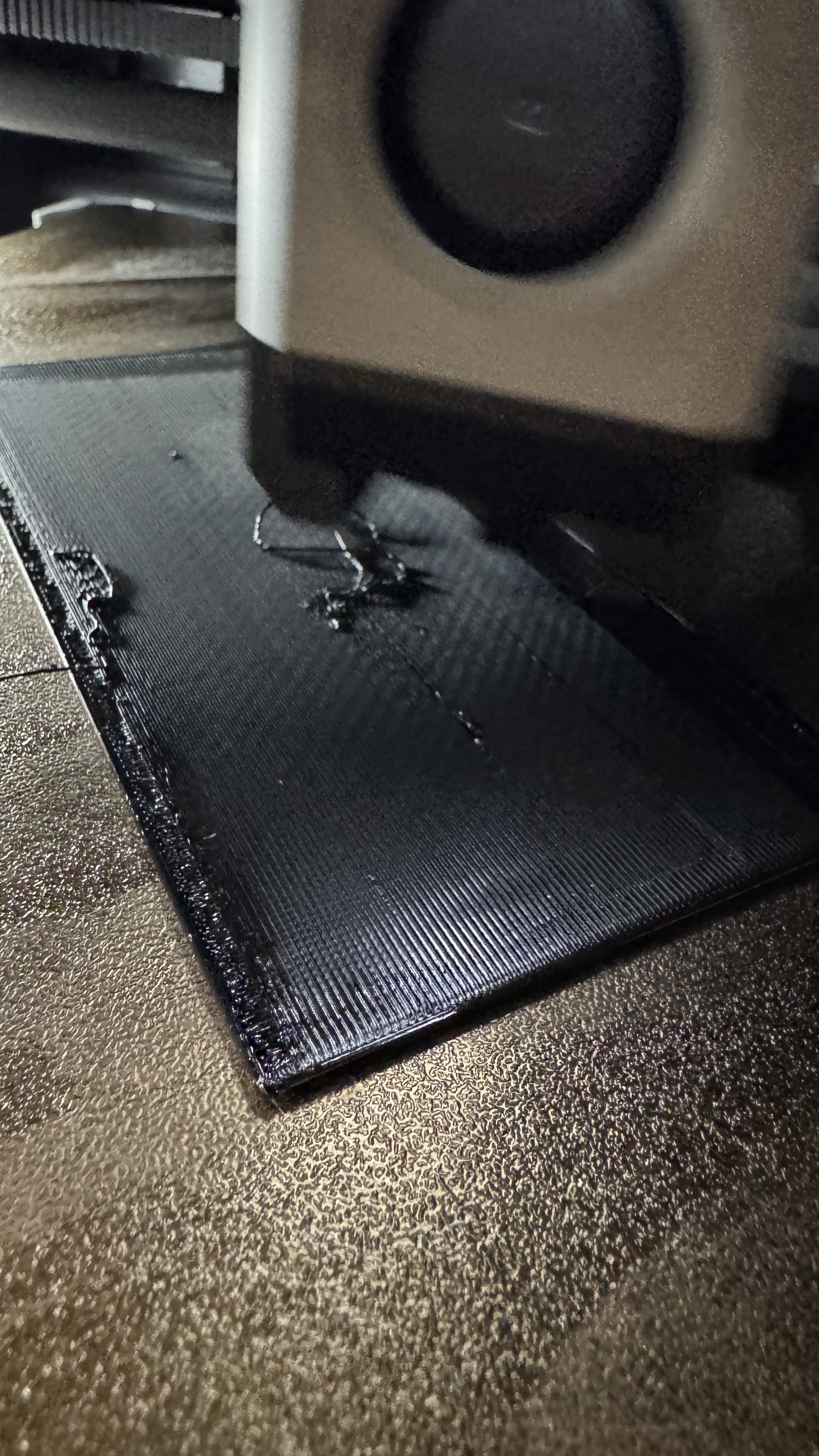

I’ve had my X1C now for over a year, and it’s been a great workhorse. But recently, it started dropping filament onto the printbed throughout the print, ruining the quality, especially of “see-through” things like lightboxes, where the end result looks like it was dragged through the desert. Note: this is not an “initial layer” problem, where the filament was carried over from the previous job - it is more devious than that. I don’t think this is related to any firmware update; it was happening about three weeks ago, and still happens after update to 01.11.00.00, which I did a couple of days ago.

  1. In your first photo, is the dropped filament attached in anyway to the previously printed parts?
    My question here is to determine if the extra filament did fall or was somehow dragged from the nozzle during the printing process.
  2. In your second photo, was that printed face up or down?
    My question here is trying to determine if the coloured parts were face down on the build plate when printing.

Sorry about the missed details. The filament is Creality PETG spool refill. It was brand new, right out of the obx and sealed pouch. I’m not in the habit of drying new filament; maybe I need to be? I will show pictures and point yhou to the model on (I think it was) thingiverse, but it was printed face down. Not home at the moment.
The droppage is not related to a prior print in any way. You may notice a blob on the middle left, as well as one prominent in the middle itself, dropped at different layers, presumably.

In addition, I would also check the wiper/scrubber. You mention you’ve used machine a lot and that is a wearable part. You also mention it happens mid print and see its a multicolor print. It’s possible the black is having some issue as mentioned above but also the wiper may be worn adding to the issue.
