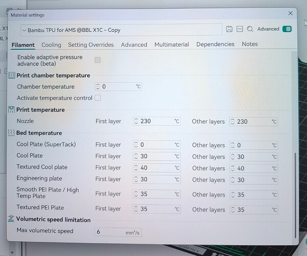

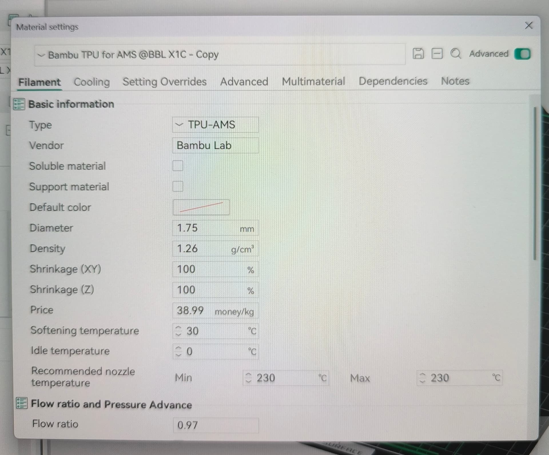

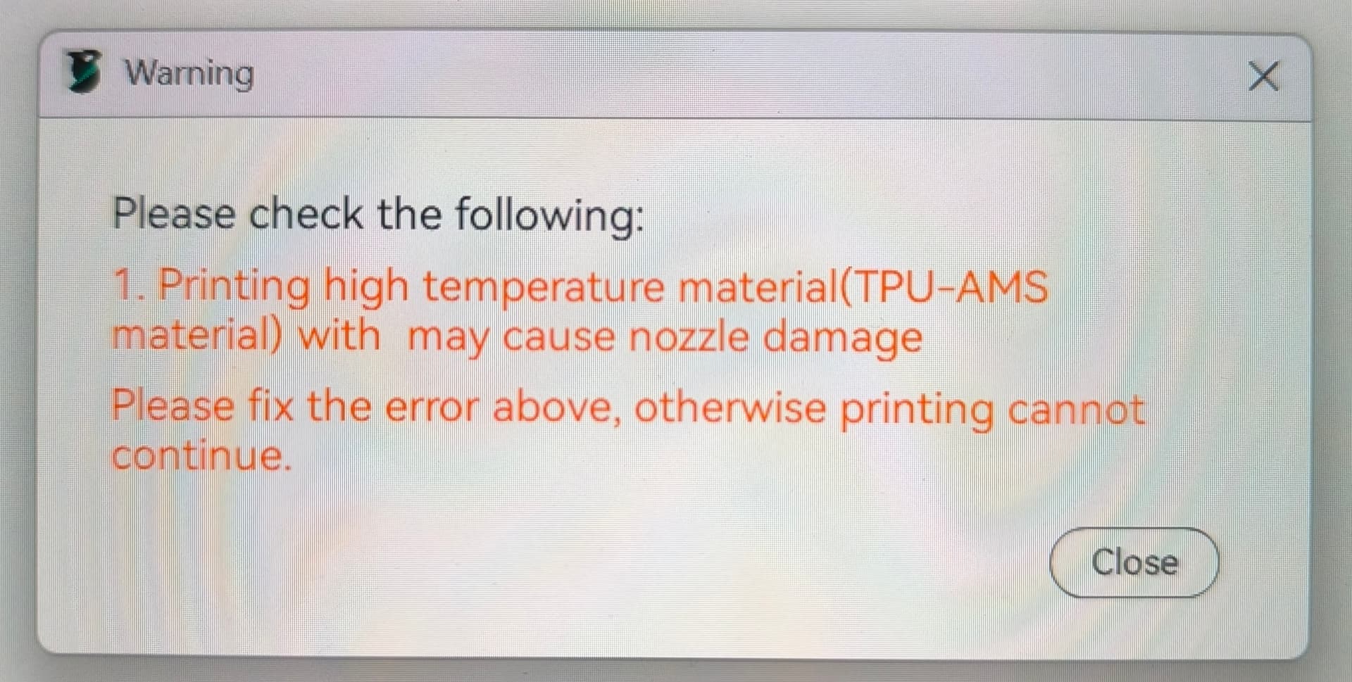

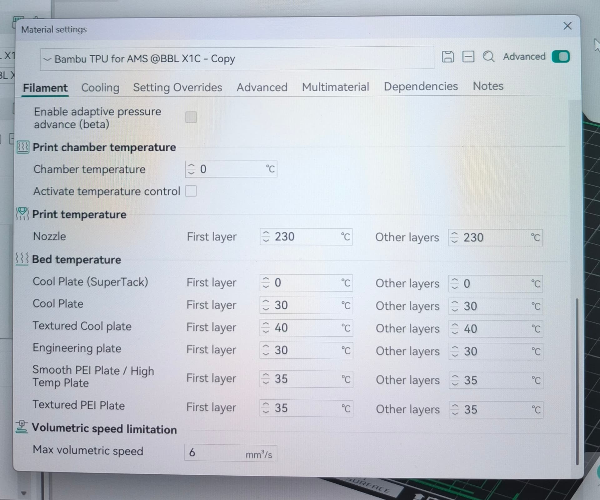

So this is my first time trying to print with TPU and when i click send to printer this is the error message i get and below are the TPU settings im using. I’m using Bambu TPU for AMS.
Any idea how i can overcome this?

Judging by icons, you’re using OrcaSlicer.
That’s very nice, but since you’ve updated firmware that might cause problems because Bambu had a very incorrect idea about what you can do with your printer and what you can send to it and from which app - I refer to “authorization” included in firmware.
You need to install orca nightly (since PR Support latest BambuLab P/X/A firmwares & AMS 2/HT by Noisyfox · Pull Request #9517 · SoftFever/OrcaSlicer · GitHub got included) and use printer over LAN. The mentioned PR is included in orca and will be a part of upcoming 2.3.1 release. Unvortunately that also means you can’t send prints via bambu servers (“cloud”) due to mentioned useless “authorization” “feature”.
For comparison, you can try printing using bambu studio and see whether the error persists.
Well i downgraded to the latest firmware i could and now orca slicer is working. I did try to print with Bambu Studio before i downgrade and it did work.
So this issue will be resolved with the orca slicer 2.3.1 version?
Try nightly. I haven’t had problems yet, but then I haven’t tried new firmware.
