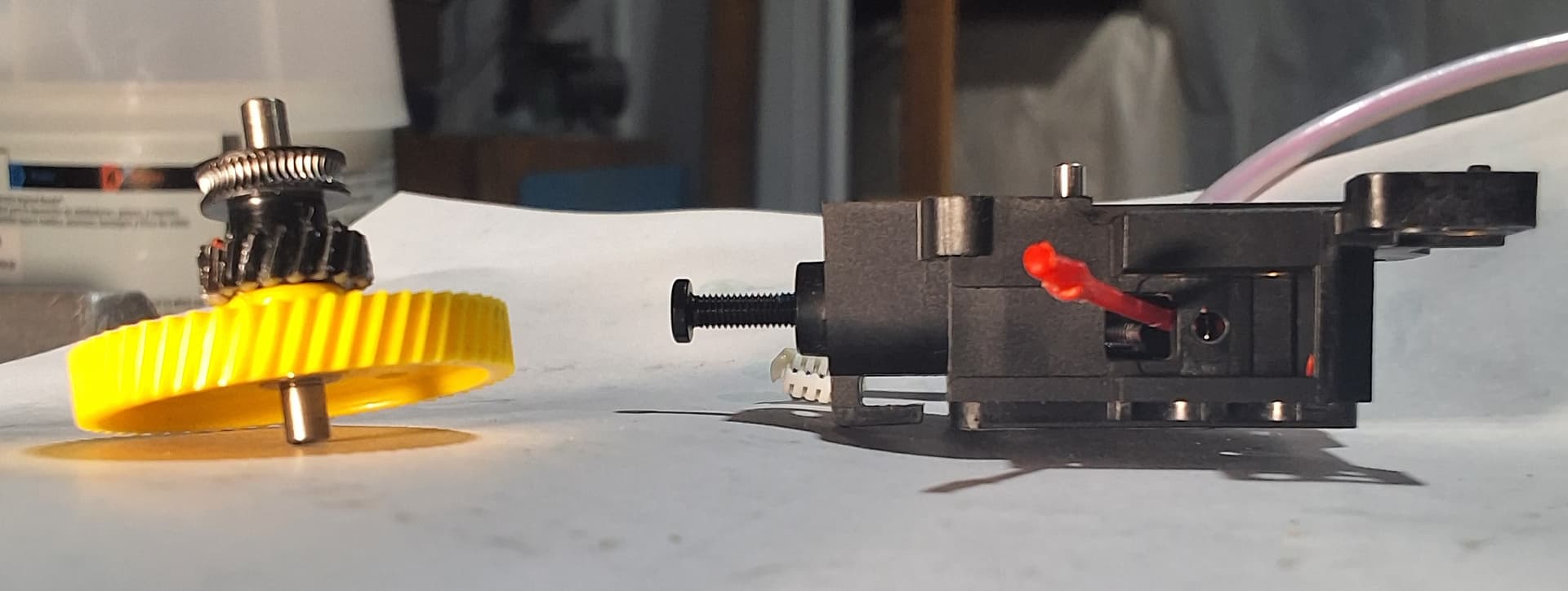

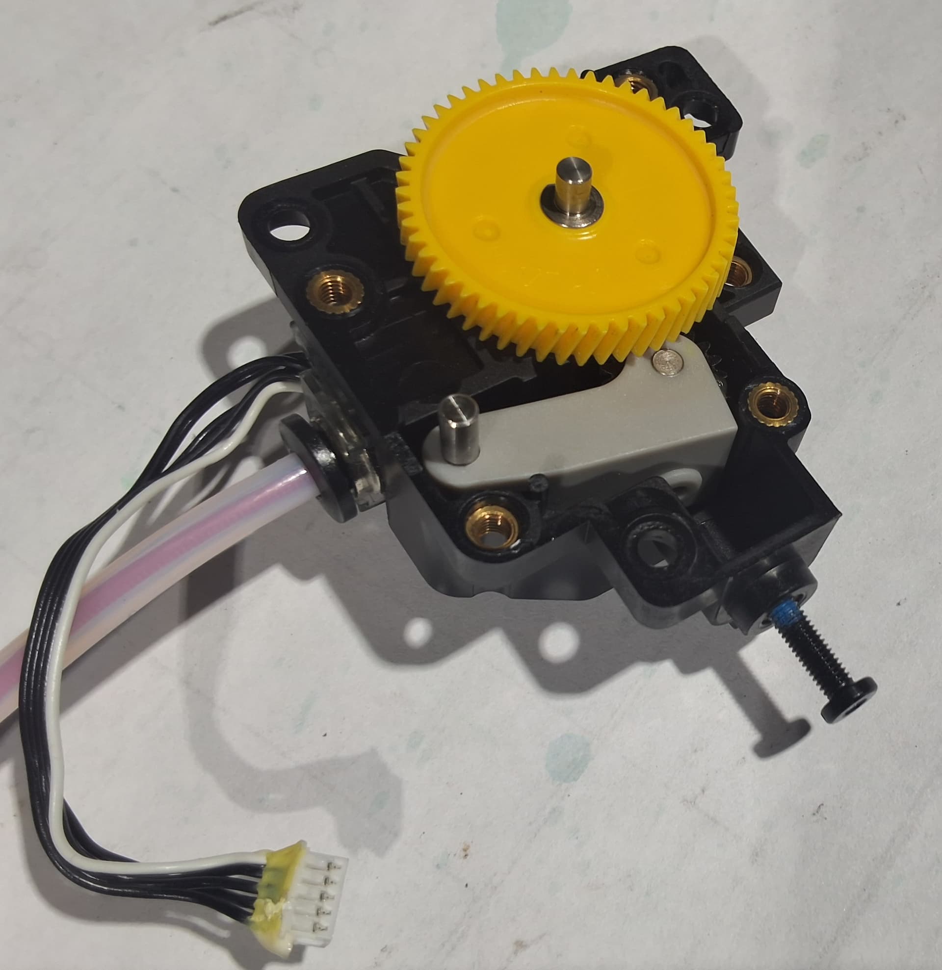

I’ve got same isssues. Did it resolve your problem opening the top hat?
wow. All i did was replace the gear, works like new!
