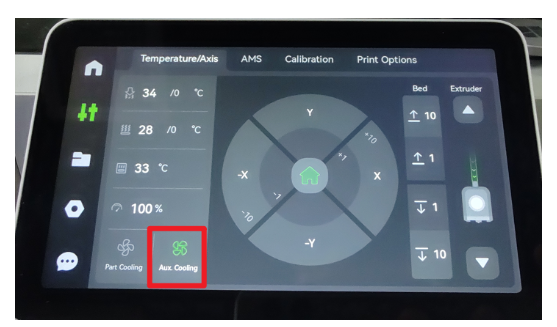

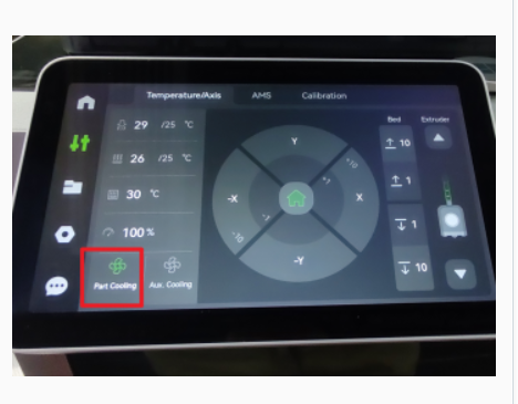

Could you please (while not printing) do the following and video it
Turn ON AUX FAN
Check the Chamber Temperature regulator fan
At the same time you Can also check the MC FAN
Check the Front housing Part Fan
Please video this each one indiidualy
The Selft test should verify that the Camber regulator fan and MC fan are working properly,
You can individually test AUX fan and Front housing part fan

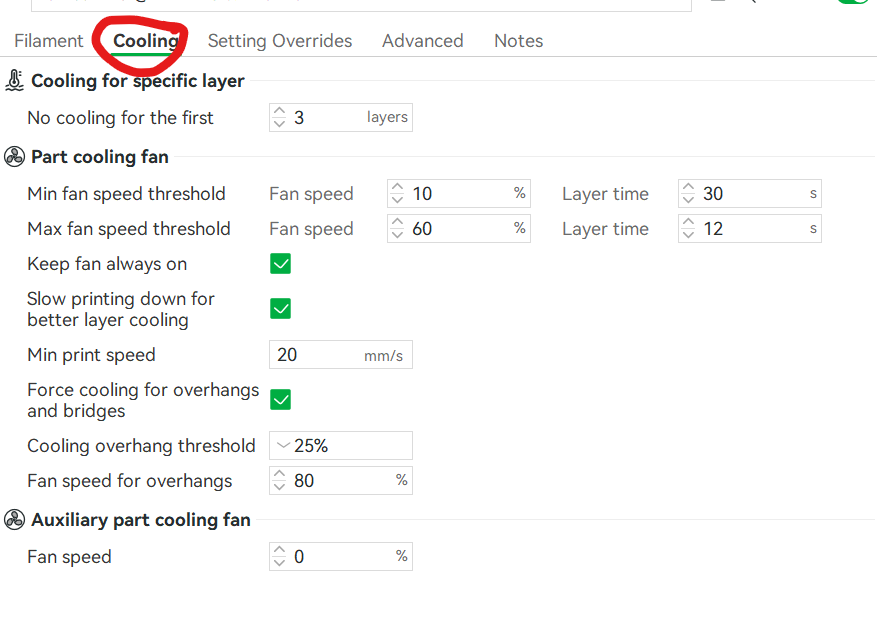

The difference in speed that you hear (like the gust) may be based on the cooling parameters in settings
When printing slower it can increase the fan speed, or when printing overhangs/bridges, it may decrease the part fan speed
You can look that up in the cooling section on the Filament settings
