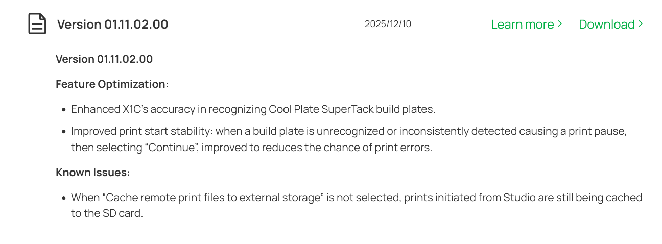

Firmware 01.11.02.00 has been released but there is no mention of the nozzle mismatch bug, but plate detection for cool plate has been fixed.
I have a ticket open regarding the nozzle mismatch bug and I’ve asked them to confirm if the nozzle mismatch bug is fixed or not.
I discovered this issue a few days ago and also logged it with Bambu Support.
