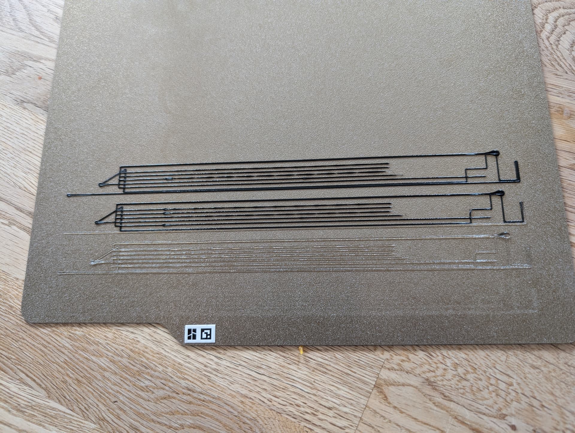

I just did the Auto Calibration and it worked perfectly fine with Sunlu PETG clear, IEMAI PETG black and Bambu PETG HF Black:
That are the corresponding results for Flow dynamics calibration:
