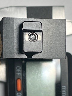

Here’s a photo showing two parts that were printed with wet filament and then printed with the exact same spool and same printer settings after drying using my secret sauce - a dry air purge into my cheap Sunlu S2 dryer. That’s how I get my filament dry. I dry it in “dry” air. With nothing changing but moisture content it’s pretty obvious these were indeed water effects and water issues are absolutely real.
