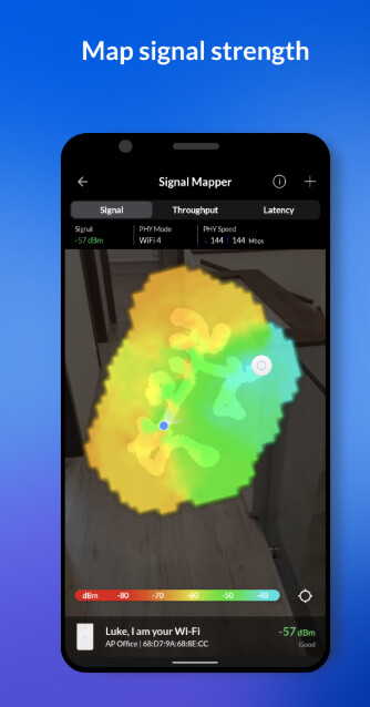

On Android, I really like this free app to see what channels are used nearby:
It also helps map and optimize access point locations.

There are lots of iPhone apps that can map WiFi strength like the screenshot @Ikraus shared. If you have an iPhone, you do have options.
It’s just that what the iPhone-based apps can’t do is tell you why the wifi is bad in some spots: Congrested channels? Interference from other networks? Signal attenuation? Intermittent noise causing bad signal-to-noise ratio? You will need a Mac or PC for that. (And maybe an Android app; I don’t have that experience.)
That “why” information is important, but often the only thing in your control is where your devices are located. And for that, the mobile apps are useful. They can help you find a better location for your WiFi router, or a WiFi extender, or your devices (printer).
