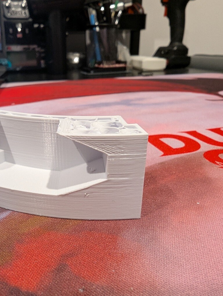

I have recently started getting inconsistent outer walls on prints, resulting in random horizontal lines. Most small prints turn out perfectly, but larger prints end up with issues.
I have tried using different temperatures, wall order settings, number of walls, different infill, different filament brands and slower speeds - all resulting with the same issue.
I am using a Bambu X1 Carbon with the following:
Hardened steel 0.4 nozzle
Gold PEI bed
Filament eSun PLA+
Hot End Temp 220
Bed Temp 55
Number of walls 3 (tried 4 as well)
The outer wall in the image is meant to be smooth, any assistance would be greatly appreciated

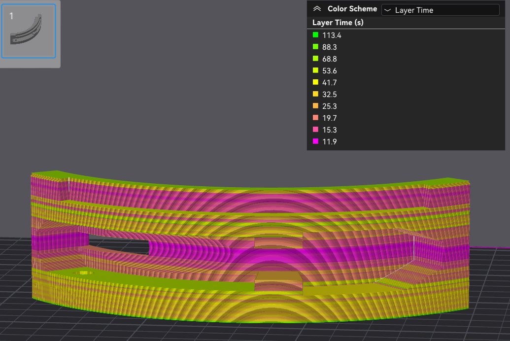

Here is a screen shot of the layer time, flow was consistent across the outer wall of the model
Drying the filament helped a little but the problem remains. I think it has something to do with the layer time but unsure what I should change.

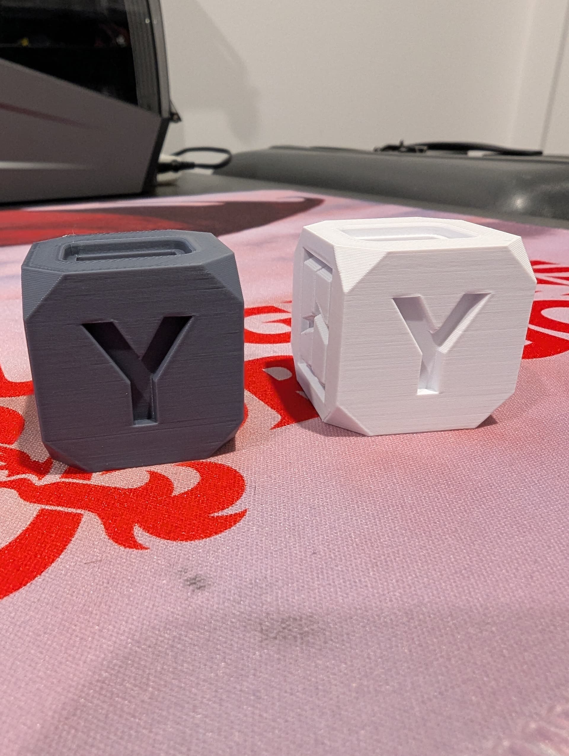

Here are two calibration cubes showing the fame filament and settings working well for smaller objects
