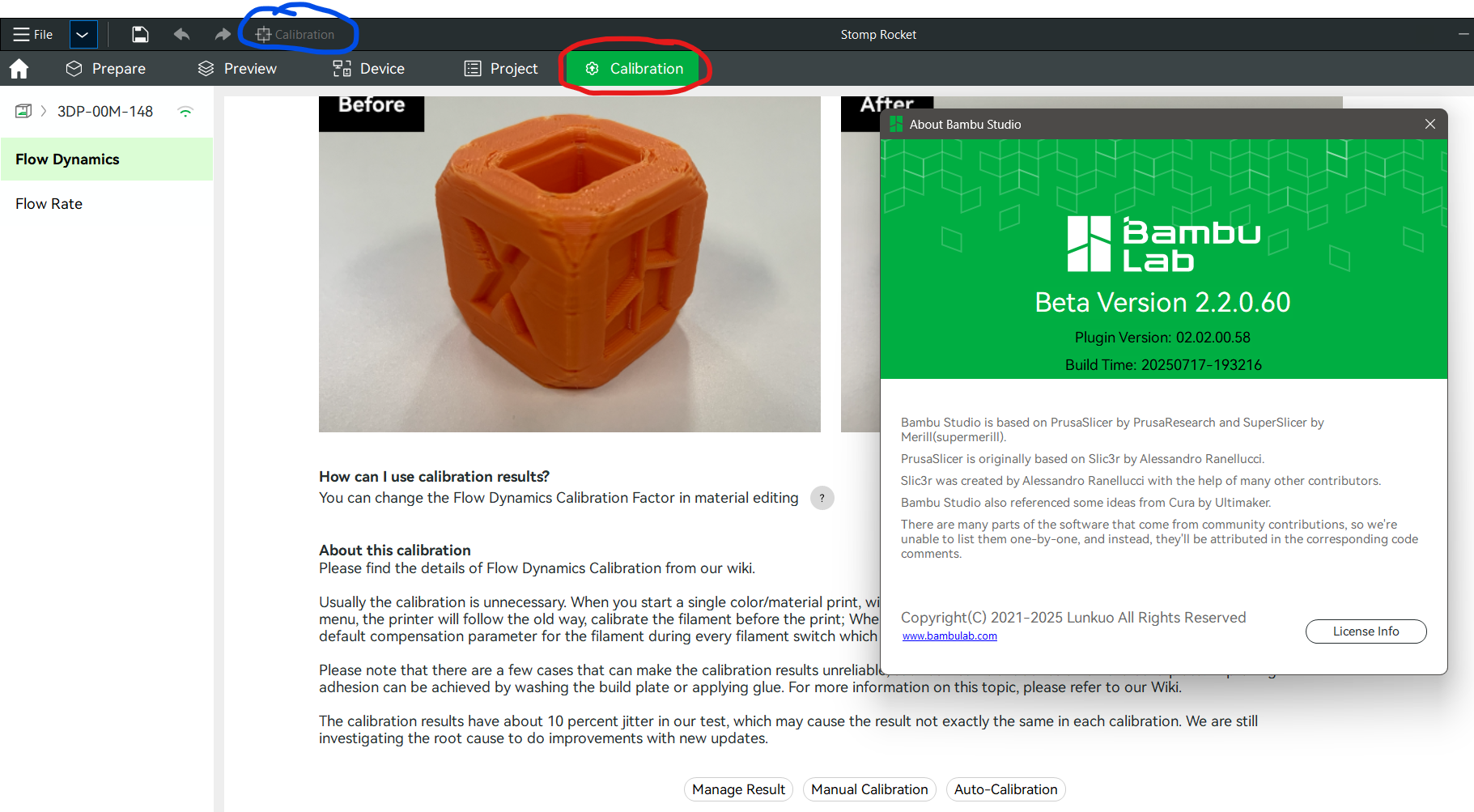

X1C MicroLidar Auto Calibrations No Longer Available in 'Develop Mode'
EDIT: After carefully reading the release notes for Bambu Studio 2.20, it appears this is now a 2-mode situation, those of us who need all advanced settings always enabled along with other features that are part of ‘Develop Mode’ in Bambu Studio are now no longer allowed to use the X1C’s MicroLidar AT ALL, this is lawsuit territory.
However the fix is to DISABLE ‘DEVELOP MODE’ in Settings
@BambuLab PLEASE do not punish X1C Print Farm owners like this, this has disrupted an ENTIRE DAY of production.
What is going on? I own an X1C Print Farm 100% BECAUSE I NEED TO PERFORM BOTH CALIBRATIONS FOR EACH 20-40HR JOB BEFORE STARTING! and the newest version of Bambu Studio has removed the entire calibration tab and replaced it with 3rd party manual calibrations. I have to use old software to get the entire reason the X1C has MicroLidar to function!?
I’m LIVID!!!

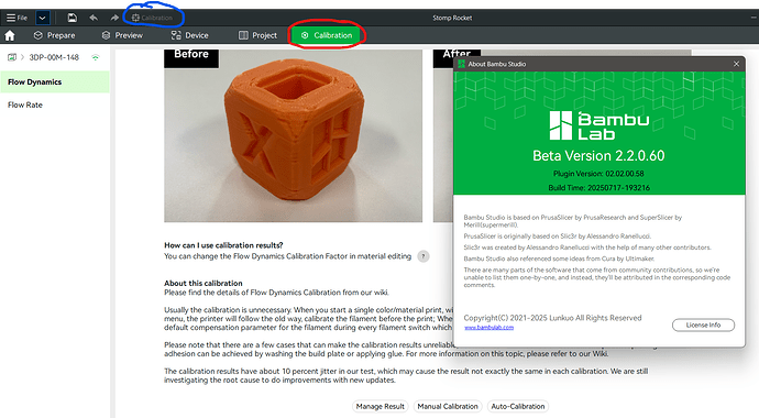

I have been on the 2.2.0.60 Beta for several weeks now, with the X1 Firmware deliberately left at 01.09.01.00 due to connection issue reports increasing in the forum in recent days.
I can still see and use the auto-calibration when using the “classical” menu (red). Haven’t used the Orca imported calibrations in Studio (blue) yet though.
Last Bambu Studio version and last X1C firmware: BS behaves as EnoTheThracian shows in his post.
