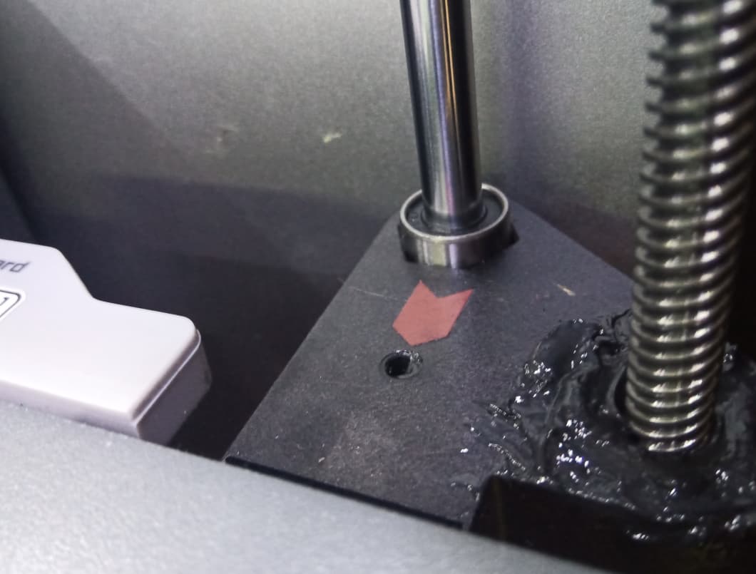

While I was checking the printer Z axis motors, I noticed that one of the bearing (?) seems out of place on the right hand Z guide
compared to the left side
I’ll look in the wiki about refitting the part, it seems that’ll need to take the printer apart :frowning:

Our friend @Olias has a topic on this, check it out before going further.
thanks for this : very similar problem to mine, and seems to match the only solution from the X1 wiki, and the P1 and X1 share the same mechanism
his guide lines for the repair are much clearer : I’ll try the repair per @Olias thread , and will report back

origin of the problem is located in the move of the sliding bushes, I just need to find which screw size is needed to apply the fix
edit : the packing guide gives the answer at step 5, ie 3 x BT3-28mm screws
but I doubt I got any with my 2nd hand printer : time for a part bin inventory
after a thourough re-read of Olias thread, I started pulling the printer off the rack, in order to put it upside down and push on the plate on the side where the guide had moved. It took several attempts, but finally I got it back flush to the plate holder.

then put everything back in the rack, reconnected both AMS, and , bingo, auto test ran fine, build plate levelling ok, and printing is available again :grinning_face: :grinning_face: :grinning_face:
big thanks to @Kioto for pointing me to @Olias thread with the details about the fix :+1:
