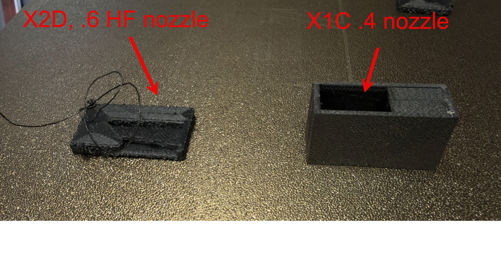

X1C prints much better than X2C
I recently purchased a x2d. I did so for the heated chamber and support material for auxiliary nozzle. I print functional parts, using a lot of ASA and PA-CF, PC and PCTG materials. It was my understanding this was what the x2d was designed to do.
I Properly dry and store all my filaments. Wet filaments is NOT this issue here.
Also I am bypassing the AMS for PPA-CF and PAHT-CF
So far for me, the x2d just has terrible quality for many of the engineering materials. and I am referring to the main nozzle. I am not going into any issues here related to Aux nozzle. So basically I am treating the x2D as a single Nozzle printer for now. Since if it can’t do basic things with main nozzle what’s the point of added Aux into the equation.

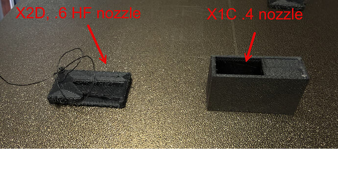

Below is an example of the poor quality. At the same time the X1c will print as expected (almost flawlessly) using the same spool of material back to back. So this is not a wet filament issue.
I have been using the x1c for 1.5yrs. I try to keep in running almost 24/7… more or less. I use both .6 and .4 nozzles without any issues. And even after this amount of use, it seems to print better than x2D
I am kind of at my wits end. I have iterated on speeds, print profiles etc…
  • I suspect the poor quality is a lack of proper .6 profiles for x2D.
  • Or perhaps the HF nozzles are an issue for CF filled materials?
  • Or its the heating/cooling modes? these modes seems to override (ignore) filament settings.
PLA prints great on the x2D. ASA has printed well too. But the engineering materials with CF fill are disaster.
Anybody else have this issue?
First, I applaud the lengths you went to isolate the root cause. I wish more people would do that before posting a one-sentence “need help” post.
One thing still stands out to me in your comparison: have you tried a 0.4 mm nozzle on the X2D?
In the example shown, you’re comparing the X2D with a 0.6 mm HF nozzle against the X1C with a 0.4 mm nozzle. That means the printer, nozzle, and associated profile are all changing at the same time. Since the same spool prints correctly on the X1C, you’ve done a good job ruling out wet filament, but I don’t think the test yet isolates the X2D itself.
I ask because my experience with Bambu Studio profiles outside of the default 0.4 mm profiles has been very poor. I’ve tested quite a few of the supplied 0.2, 0.6, and 0.8 mm profiles, and so far I’ve had a 100% failure rate among the profiles I’ve tested. Because of that, I now calibrate them myself rather than assuming the supplied profile is properly tuned.
Given that you already suspect the 0.6 mm profile or HF nozzle, I’d be very interested to see what happens if you put a 0.4 mm nozzle on the X2D and rerun the same material. That would remove one of the biggest variables from the comparison.

I switched to .4 default nozzle. This had a drastic effect. The x2d now prints now print as expected with PPA-CF. kind of good news.
I guess x2d cannot use .6 HF nozzles on anything other than basic materials like PLA… At least I could not figure out how to do so. 4-5 days of trial and error. I personally think its something to do to with the HF nozzle vs .6 nozzle size.
This is not the first time I have problems with HF nozzle. I have found HF nozzles get clogs and filament breaks in the head when using material with CF. I have not had these issue with using non-HF nozzles.
Correct me I am wrong, but HF nozzles have a more complex pathway inside the nozzle? they do so for added heated surface area? That also seems to result in more clogging potential with materials like CF filled.
I could be wrong. But I think I am done with the BL HF nozzles for now. Benefits are marginal IMO… And I am sick of having to pull apart the printer and filament path to diagnose and fix clogging problems… Let alone poor print quality on some materials

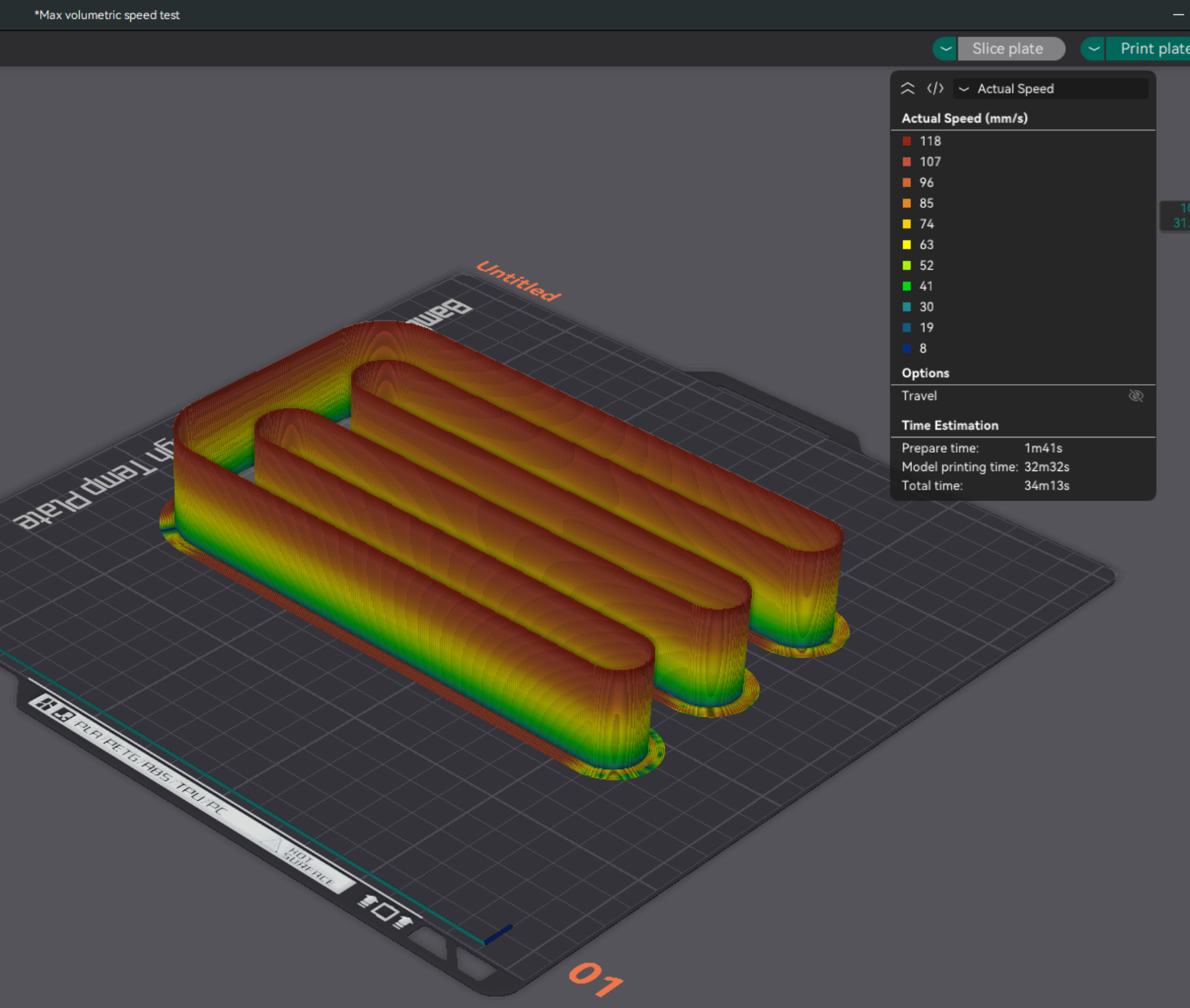

I would call your test a success. The good news is that, knowing the rest of the process works with the 0.4 nozzle, you have isolated the problem considerably. It now comes down to determining what the 0.6 HF nozzle/PPA-CF combination will reliably tolerate.
I had suspected this might be the outcome based on my own experience. As I may have mentioned earlier, Bambu Lab, and frankly much of the rest of the 3D-printing industry, appears to put the majority of its profile-development effort into 0.4 mm nozzles. If you search this forum over the last few years, there are plenty of unhappy stories involving 0.2, 0.6, 0.8, etc., particularly once you move beyond basic materials such as PLA.
You may want to start with the following order:
  1. Temperature tower - Often this does not yield a single obvious winner, but it is a good starting point and should give you a useful operating range. If you want help interpreting the tower, upload a photo and I can point to the likely best temperature.
  2. Maximum volumetric flow - Based on what you just proved, this is where I would focus first. The 0.6 HF nozzle may simply be trying to push PPA-CF faster than that particular hotend/material combination can melt and move reliably. Set the maximum volumetric speed conservatively and see whether the wall degradation disappears.
  3. Flow rate - Once you know you are operating below the volumetric limit, calibrate the flow ratio. That will correct systematic over- or under-extrusion, but it will not compensate for exceeding the hotend’s sustainable melt rate.
I would also be cautious about concluding that the problem is simply the 0.6 mm nozzle size. Your test really isolates it to the 0.6 HF configuration, not nozzle diameter alone. The HF internal geometry may itself be part of the problem with CF-filled materials, which would also be consistent with the clogging and filament-break behavior you described.

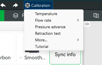

Are you aware that at least some of the Orca calibrations are available in Studio?
Enable Develop mode in Preferences.
Choose the calibration in OrcaSlicer, slice and save it to a flash stick, plug the stick into the printer and print it.

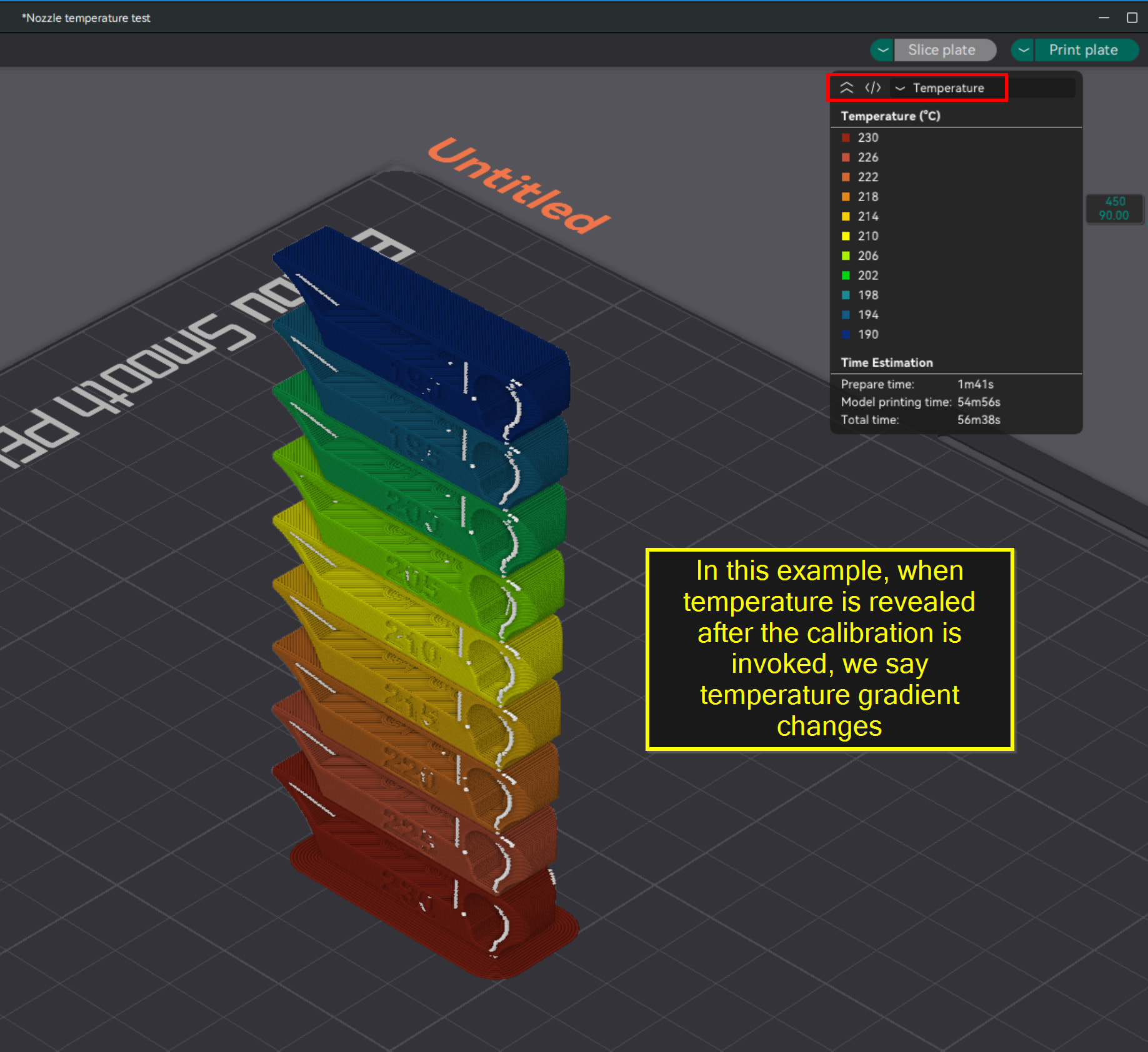

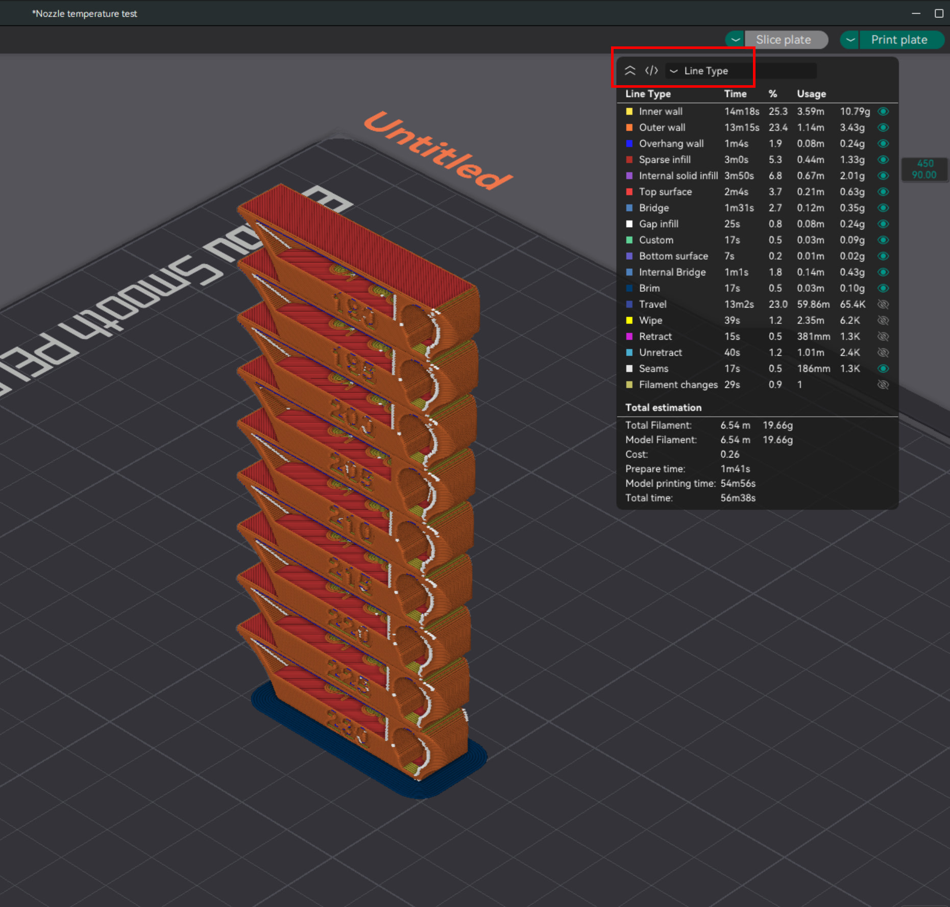

I’ll give a simple example using a temperature tower.
We all recognize this slice, but the default view is to show line type.
If we turn on Temperature view, we can see the gradient of the programmed temperature changes in the G-code.

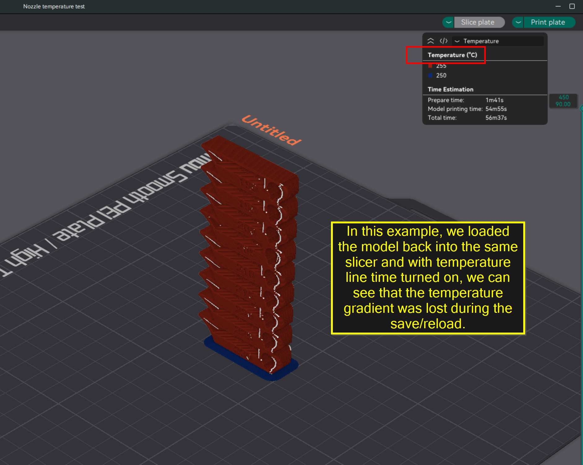

Now we save that file, load it back into the slicer, reslice it, and show the temperature.
This does not always happen, but unless one goes the extra step to verify that the calibration changes have actually been implemented, all one may be doing is printing a uniform model, not performing a true temperature calibration.

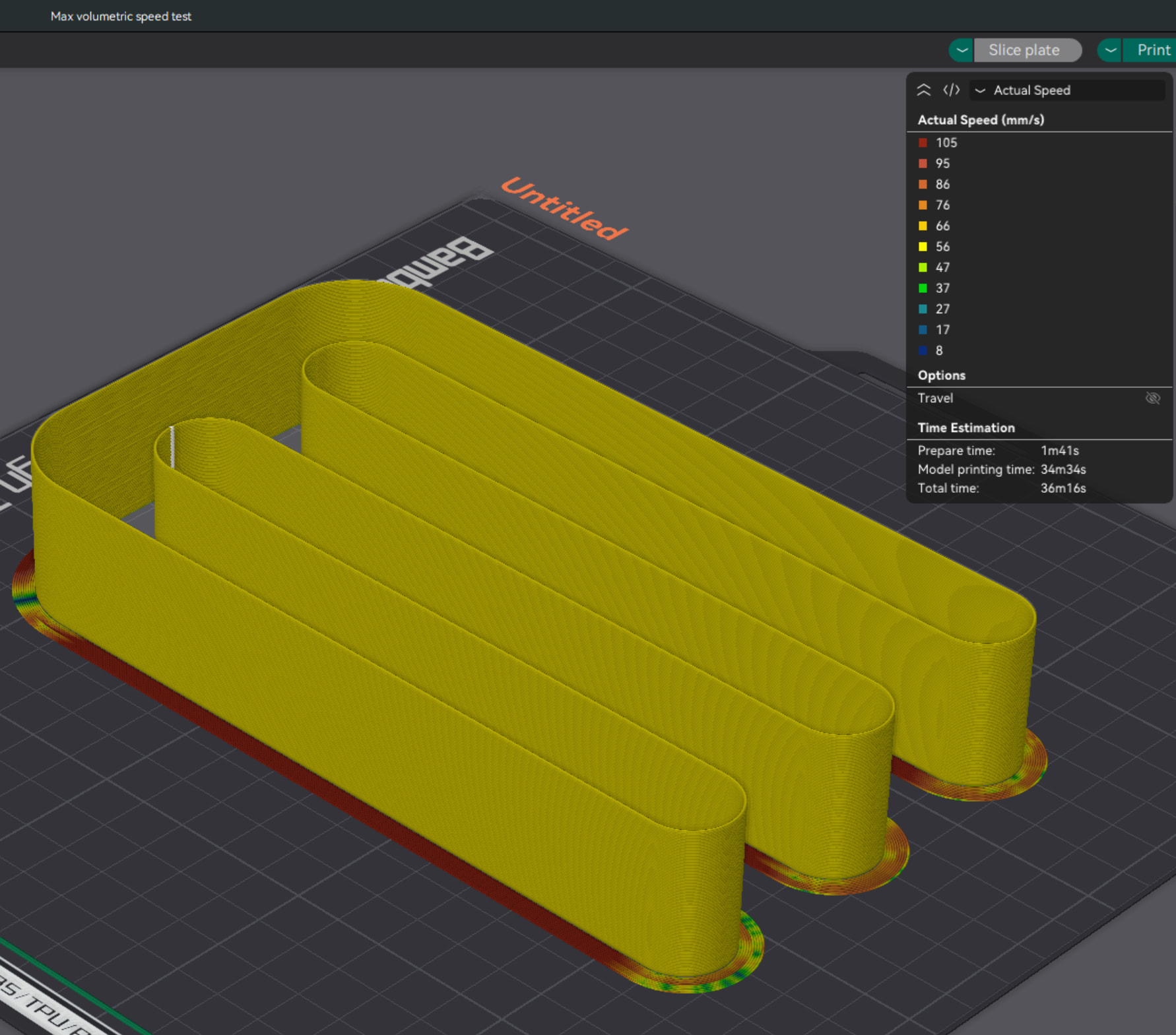

Another example with the max volumetric flow test
Now save the model and load it back in.

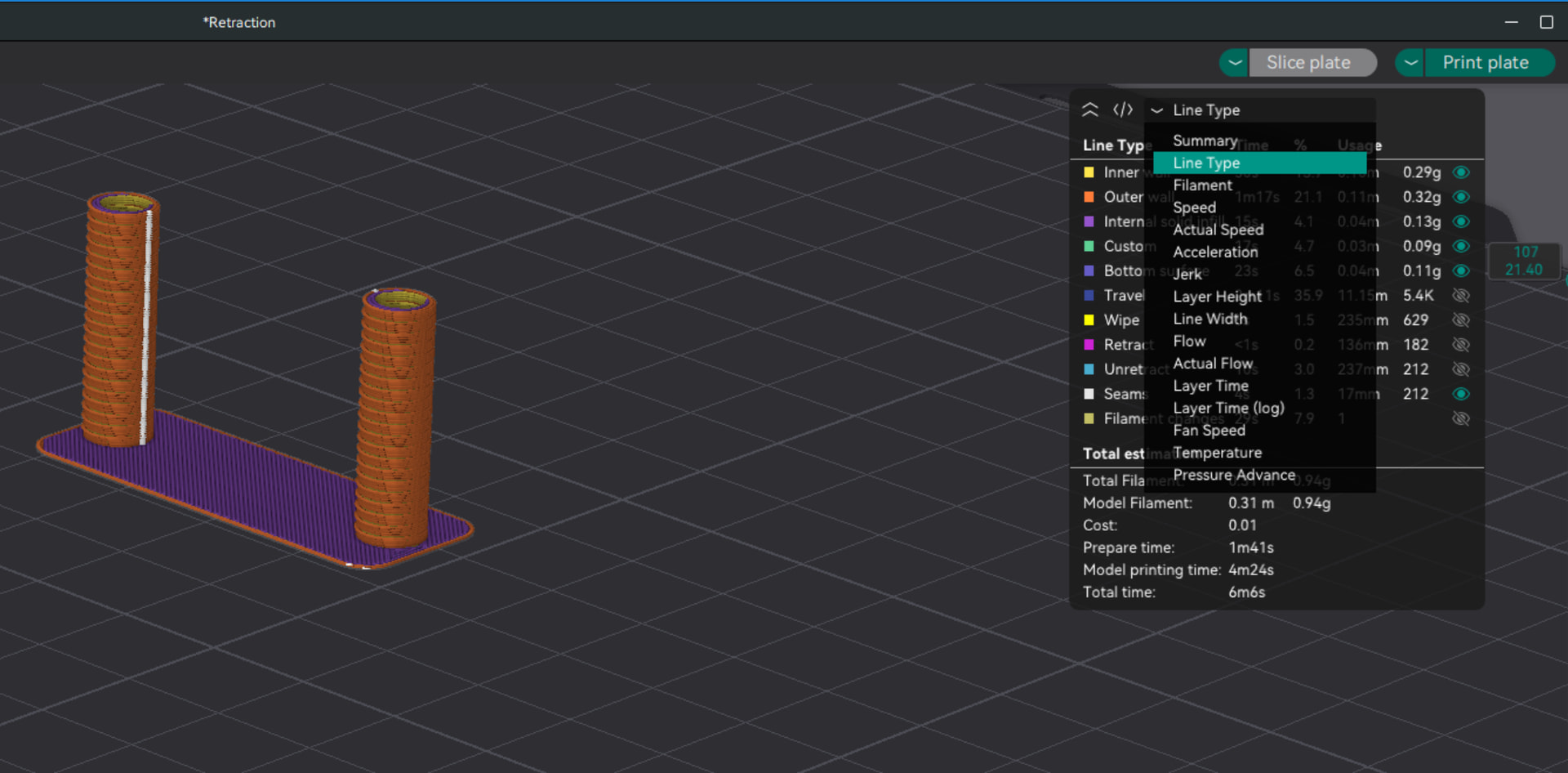

And, of course, with some tests such as retraction speed, there is no convenient preview mode that clearly displays the changing retraction-speed values. So one may not be able to visually confirm whether the test is actually being implemented, yet the tower will still print.

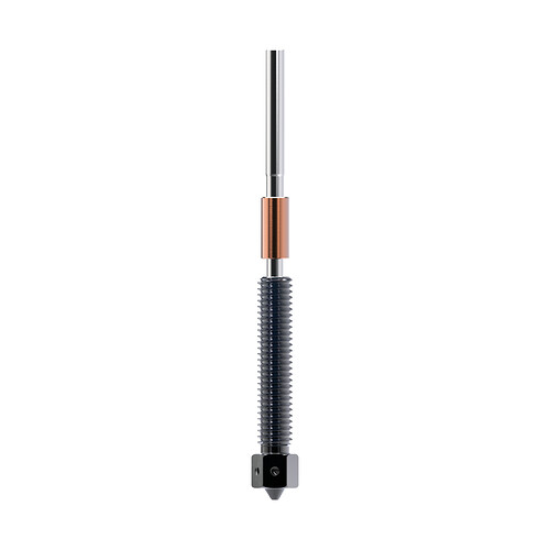

High flow nozzles are of course effectively multiple smaller nozzles, so an increased likelihood of clogging is quite reasonable. Also harder to unclog due to the narrow channels.
This is why I’m taking this post, and the earlier one, to task. Claims like this take a particular nozzle design and turn it into a general rule without evidence. That is how “I was told…” or “I heard that…” becomes Internet folklore and eventually gets repeated to newer users as fact.
High-flow nozzles are not simply “multiple smaller nozzles.” There are several different approaches to increasing melt capacity and heat transfer, and their internal geometries can be substantially different.
E3D specifically describes its High Flow ObXidian nozzle for the Creality K2 Plus as using a custom internal geometry to increase heat transfer and volumetric flow, while also explicitly promoting it for abrasive materials such as carbon-fiber and glass-fiber-filled filaments:
Phaetus makes the point even more directly. Its K2 Plus silicon-carbide nozzle is specifically sold as a high-flow design, yet Phaetus lists carbon fiber, glass fiber, steel-filled, wood-filled, tungsten-filled, and glow-in-the-dark filament among its intended applications:
As I stated earlier that does not mean every filled filament will work with every nozzle diameter or every internal geometry. Particle size, fiber size, nozzle diameter, and the particular nozzle design obviously matter. What the manufacturer documentation does show is that the blanket claim that high-flow nozzles are inherently unsuitable or more prone to clogging with filled filament is not supportable.
